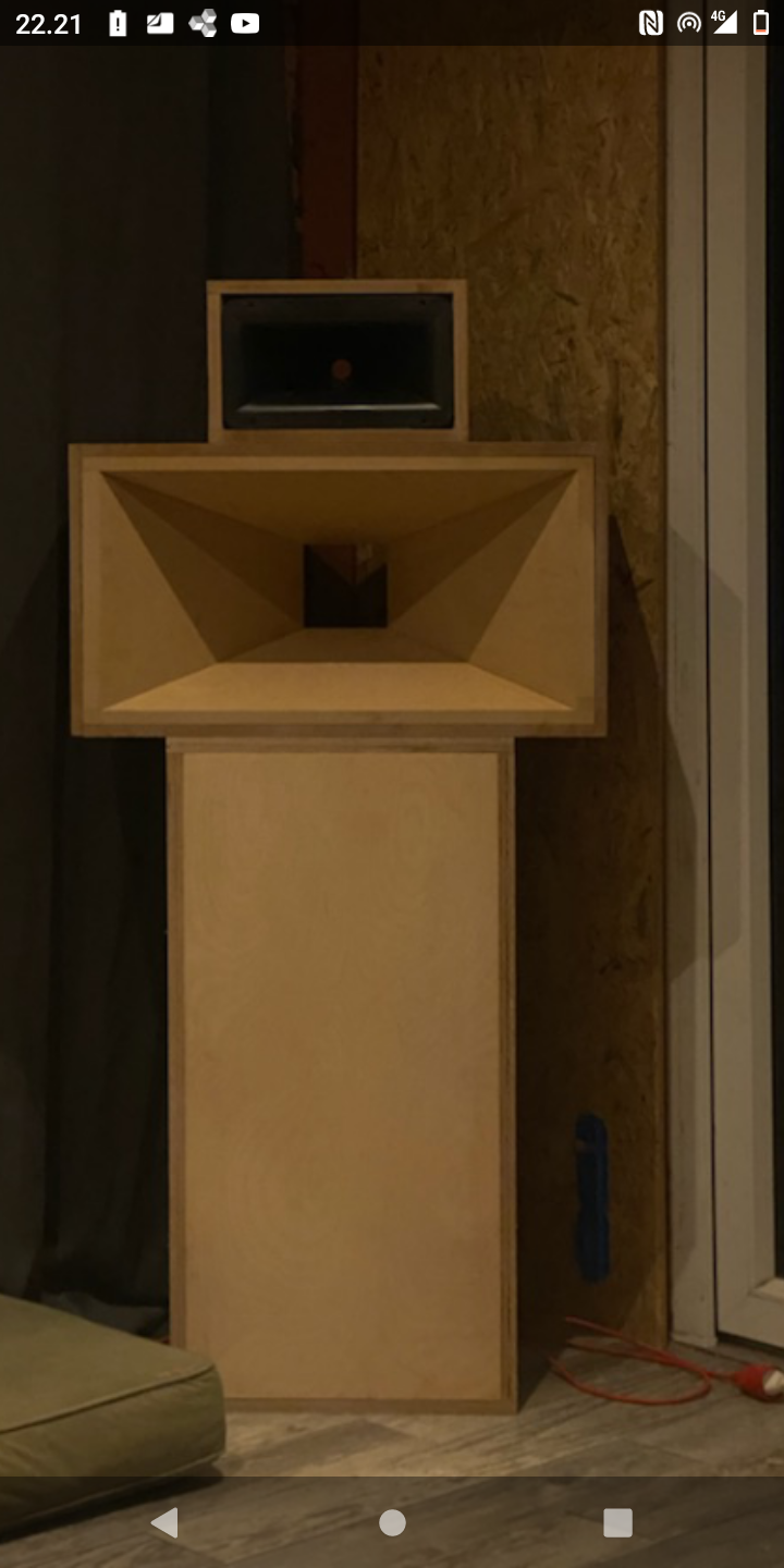

A little progress... [message #94431 is a reply to message #93455] Tue, 14 September 2021 15:22 Go to previous messageGo to next message
Messages: 34
Registered: March 2013
Thx Wayne, that wasn't the answer I was hoping for.
Been making sawdust when possible, this is current status... I've done most of the rough work on one speaker.
Attached a picture just for show.
Speaker baffle, vent, Bracing of bas enclosure, wiring, sanding still pending...
When I'm Done with that I'll build second speaker, external crossover cabinets with Speakon connectors.
Paint hasn't been decided yet.
I will be back when there's progress worth showing.
Panduro
