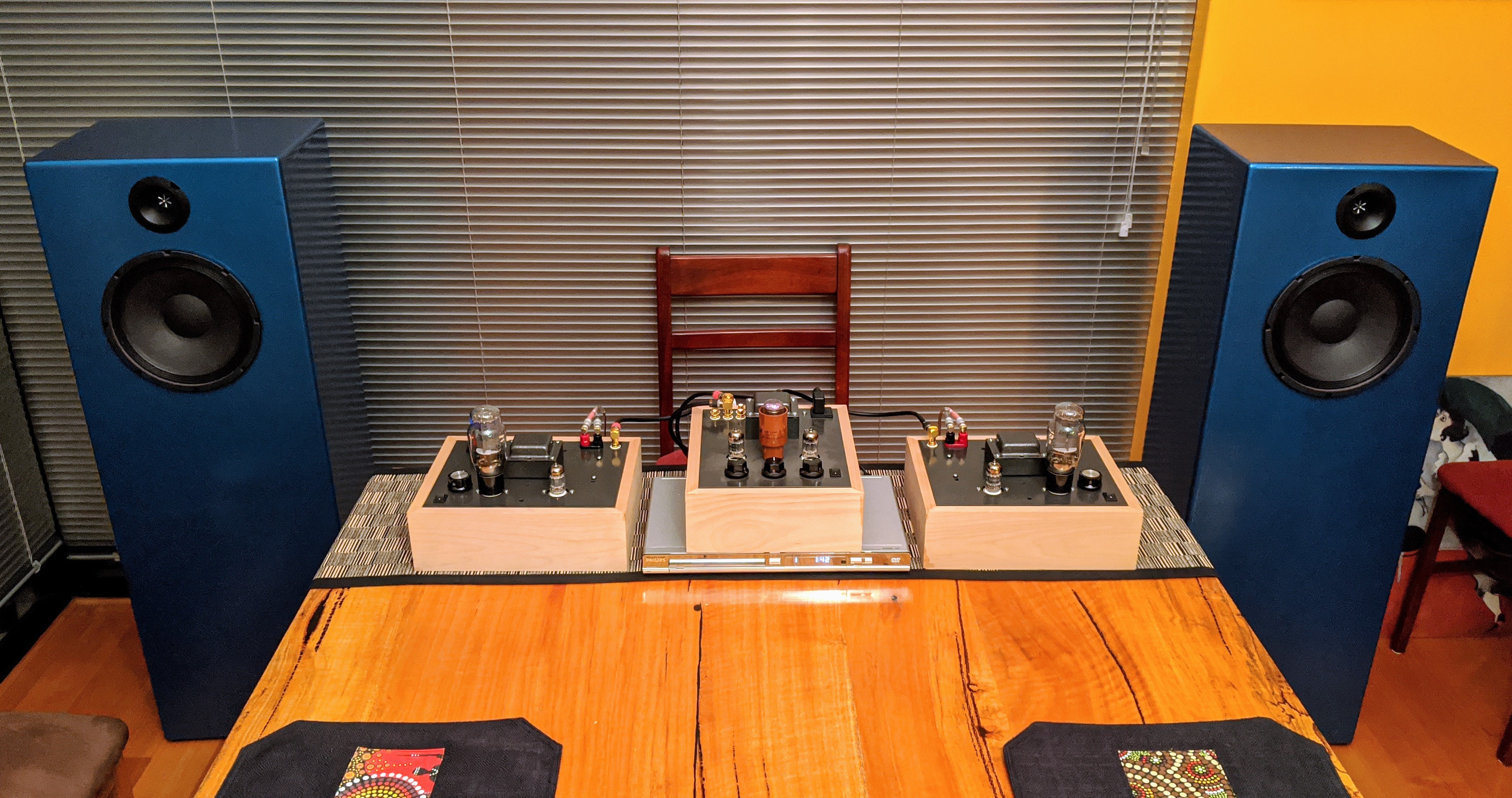

G'day Wayne,
I have just completed my SET amps and 2Pi towers. I started in 2006 so its been a long build! I used the Motorola tweeter in the 2Pi towers. I see you now recommend the Vifa DX25. If I was to upgrade, how does the cross over change?
Many thanks for supporting DIY, my system sounds great and I feel pretty good about it!
Graeme
/forum/index.php?t=getfile&id=2597&private=0
  • Attachment: hifi.jpg
    (Size: 2.47MB, Downloaded 1117 times)
Re: 2 Pi Towers [message #92093 is a reply to message #92092] Sat, 18 July 2020 11:51 Go to previous messageGo to next message
Those look great!
Grab a pair of DX-25 tweeters and install a 10uF capacitor in series and a 16Ω resistor in shunt, across the tweeter. An air-core 0.50 coil is in series with the woofer. That's all there is to it!
