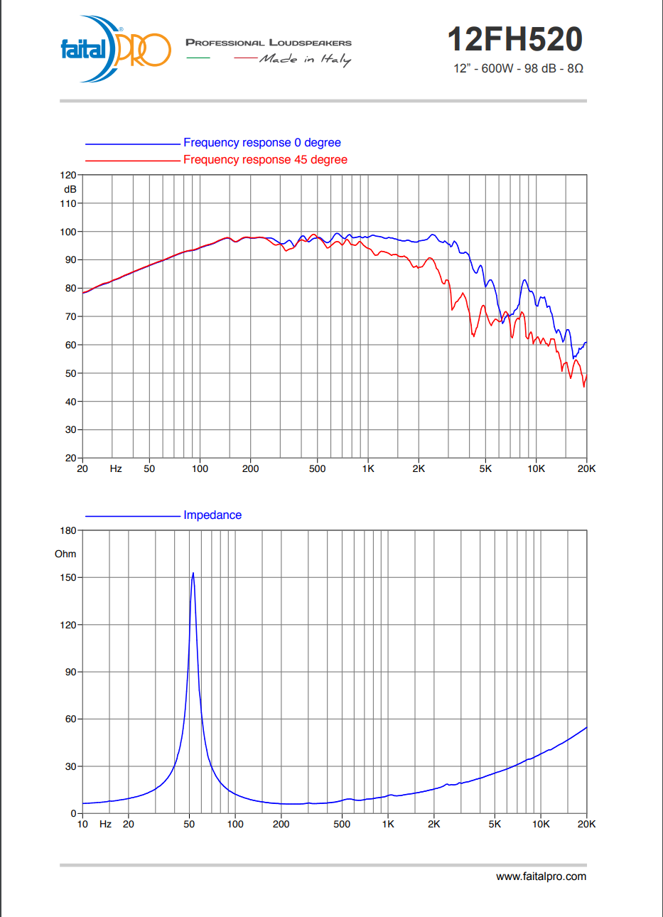

Hi Wayne,
Eminence has confirmed that the 4012HO has been discontinued due to lack of demand and there isn't a pair left anywhere in Europe. Can you recommend an alternative to go with the DE250 in the Three Pi?
I don't see another 12" Eminence with shorting rings and the AE TD12Ms are nearly $1000 a pair shipped to the UK (we have to add 20% VAT to imports) which is a bit much.
I was looking at the Faital PRO 12FH520 which has a similar set of TS parameters (and shorting rings for lower mid-range distortion (it also has a lower LE to start with)) or does it need to have a rising response around 1-2 kHz?
/forum/index.php?t=getfile&id=2372&private=0
Thanks in advance

The problem is that without a complete test set, usually accompanied by slight crossover changes to adapt the new driver, we cannot really know how well any new driver will perform. So at this time, I cannot suggest an alternative upgrade path.
The 12FH520 looks like a great driver, but its electro-mechanical specs aren't right for this application. I was actually looking at its brother, the 12FH530, which is very similar in most respects. But it isn't right for this application either. So I'm looking at other drivers, including those from B&C, BMS and Faital. I'm leaning towards the B&C 12PLB100 right now.
Stay tuned! Cool
