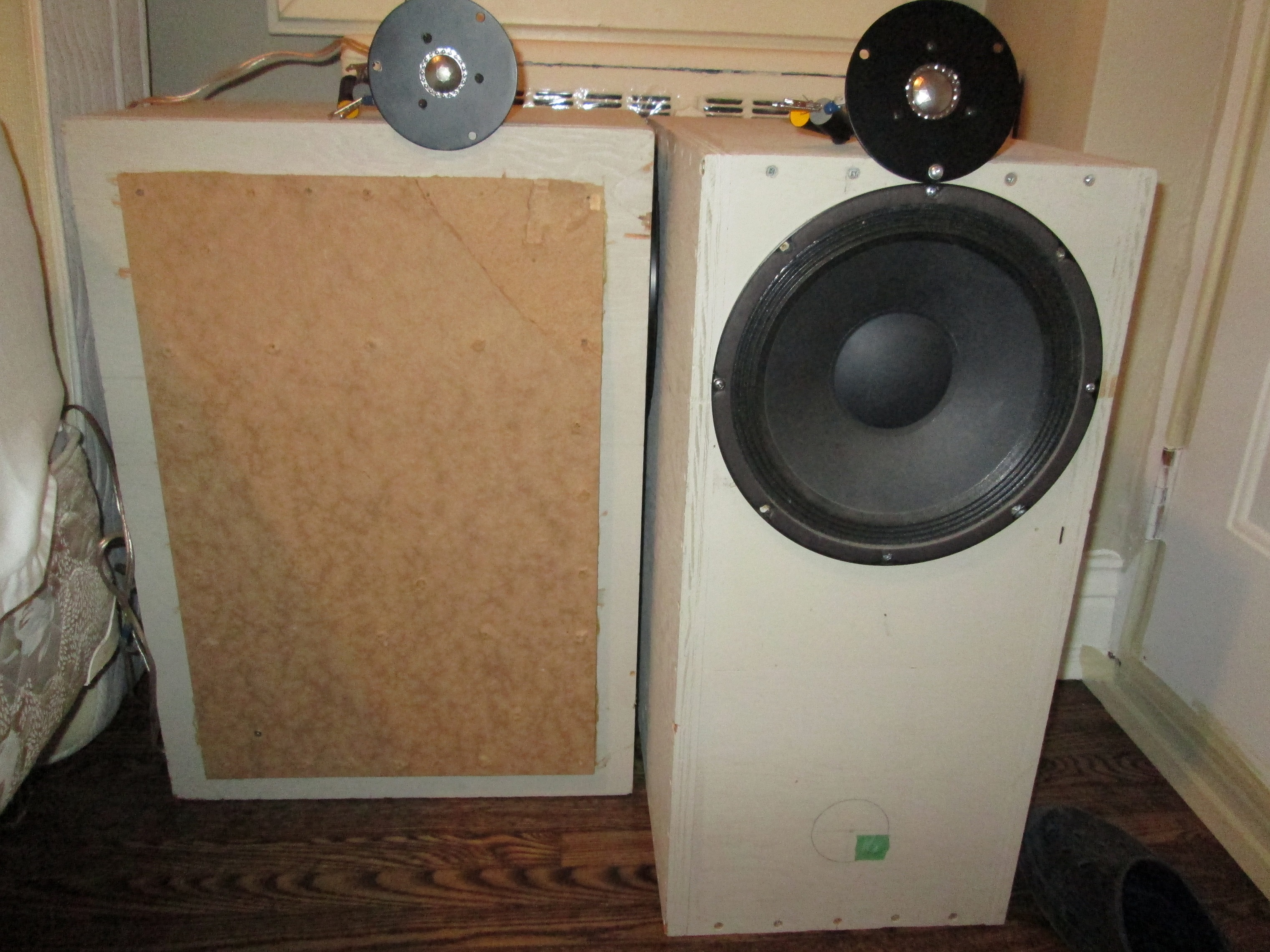

By the way, this is the reason why speakers should be kept under 12 inches in width:
index.php?t=getfile&id=1475&private=0
As you can see, there are a pair of tiny PARADIGM titans taking the place of the future 2 Pi's.

Re: 2 PI - maximum volume to avoid Helmholtz standing waves [message #80198 is a reply to message #80197] Tue, 15 July 2014 19:46 Go to previous messageGo to next message
Messages: 43
Registered: August 2010
How about a sideways 2Pi:
index.php?t=getfile&id=1476&private=0
Hey Wayne, can you crunch the # to see where the best position for the driver and port are?
Cheers,
Jeff
Re: 2 PI - maximum volume to avoid Helmholtz standing waves [message #80204 is a reply to message #80198] Wed, 16 July 2014 10:57 Go to previous message
Man, I'd love to have the time to run simulations and fiddle around like I used to. But these days, I'm so backlogged I just can't. If I even said I'd get to it, might be the best of intentions, but I'd be lying. I'm just so slammed with projects, and even outside of work, my "to-do" list is crazy full.
