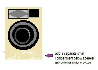

Hi,
So I've only been planning to build these 4pi's for like 5 years, but I think I am almost at the point of doing it. I know it's a no-no to mess with the width of the baffle, but I am wondering if there is a downside to extending the length? I was thinking it might be convenient for tweaking to put the crossover in a compartment underneath the speaker. Would that work? Or have a negative effect? Also, would I need to make any allowance in the speaker cabinet for the space left by removing the crossover?
I have some of those big oil can caps that I want to try, but also, like, seriously, the WAF is too much on the border with these--they really need to go larger!! Twisted Evil
Thanks for a great forum!
David

Hi Wayne,
I definitely don't want to mess up anything having to do with the performance. I was re-reading my post and maybe I didn't explain myself very well. I just wanted to clarify that I don't intend to do anything to the dimensions of the speaker cabinet. I was wondering if adding a separate compartment below the baffle would have a negative effect.
index.php?t=getfile&id=1357&private=0
Re: 4pi Baffle length [message #78779 is a reply to message #78778] Thu, 26 December 2013 15:31 Go to previous message
Oh, I see what you're saying now. That's fine, no problem at all.
