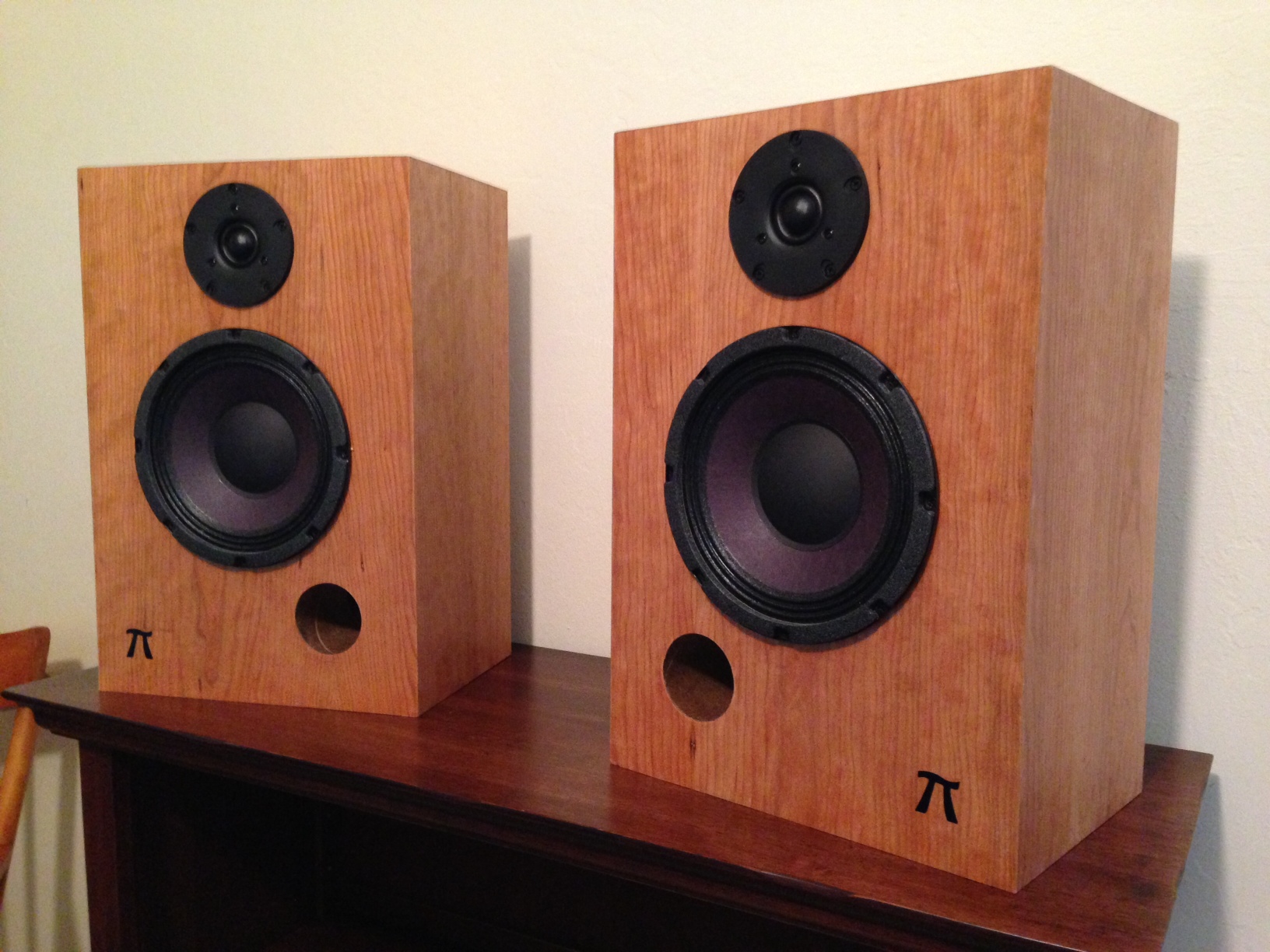

I built a pair of 4Pis almost ten years ago, and I've really been enjoying them, but now I would like to upgrade to the new waveguide and crossovers. Thing is, ripping all that out of the old enclosures left me thinking I should build new cabinets too.
This time around I would like to use particle board instead of MDF. The dust from cutting MDF really bothers me so I tried the particle board for a pair of 1Pis and it doesn't seem as troubling. The 1Pis sound just fine. Actually, the particle board seems to be easier on my saw and other tools. So I'd like to continue with it on the new 4Pi cabinets. Should I be doing anything different with particle board, like bracing or damping, or treat it just like MDF?
index.php?t=getfile&id=1241&private=0

Those are nice looking one π's, Duncan. Congrats!
As far as the H290C waveguide upgrade, it really isn't too bad. For many people, it's a bolt-on replacement, with a couple easy changes to the crossover. For some, the baffle cutout has to be opened up slightly, although the router groove for flush mounted cabinets is the same. So trimming is easy to do with a four-in-hand, if needed at all.

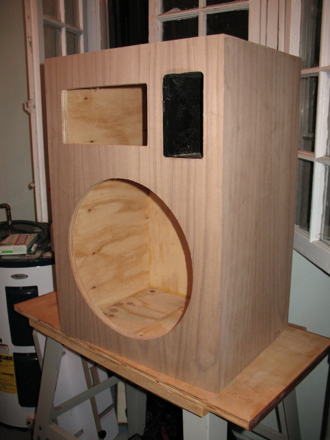

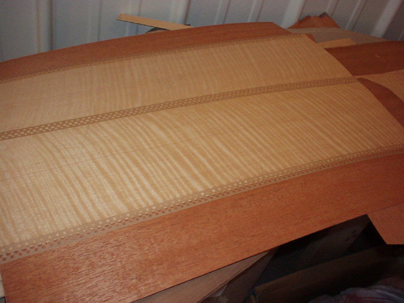

I have a half-gallon of Titebond II left over from my 2Pi Towers you can have Rolling Eyes iron-on veneering was a disaster for me! "Bubble, bubble, toil and....."
Cold pressing with Urea Formaldehyde PPR is still the king of glues, especially with multi-leaf glue-ups.

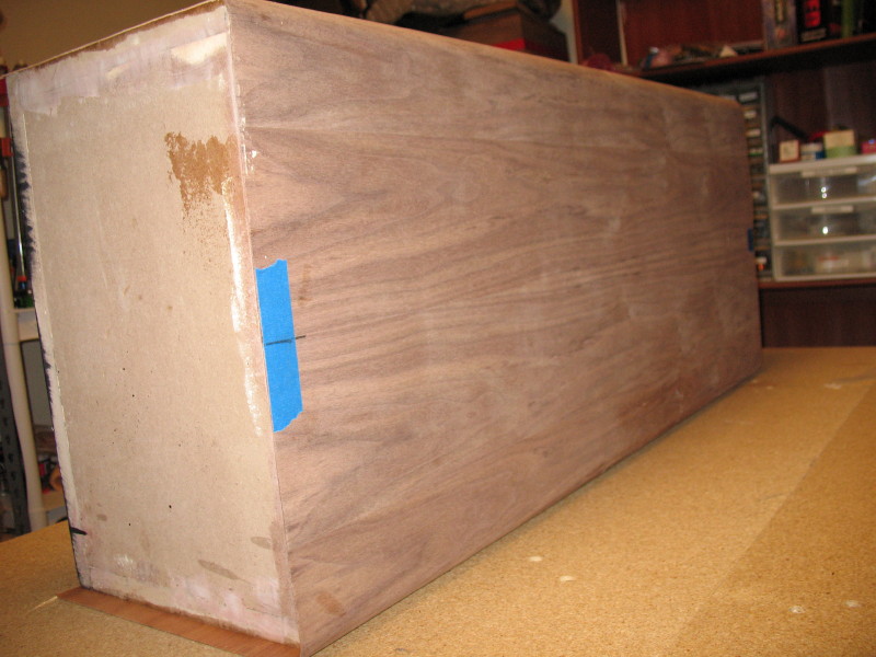

Next best is contact adhesive with NBL veneer. Use a 6" long piece of soft pine 2x4 to press out (press hard!) the veneer after mating the surfaces. Contact also works just fine for curved cabinet edges.

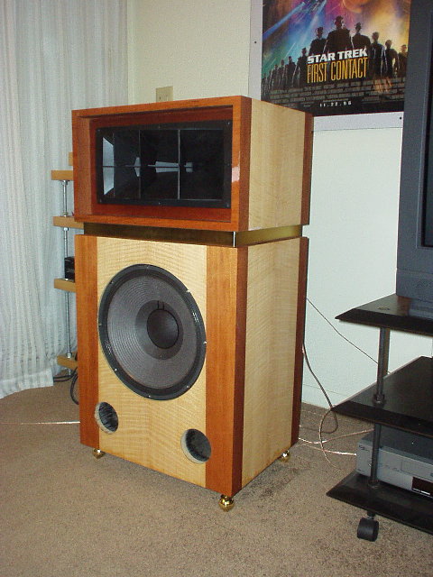

For the weekend DIY'r this is the best. My 4Pis have no issues 5 years later.

I had to look up NBL. Those 4Pis are inspiring, Bill. Now I need to add a room to the house. Thanks, man.
