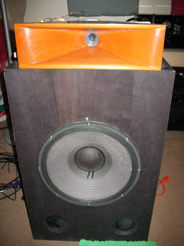

Some may remember I long ago cut down the BatSpeakers
index.php?t=getfile&id=1239&private=0
and installed the 15" Dayton Classics with mis-matched plate amps.
index.php?t=getfile&id=1240&private=0

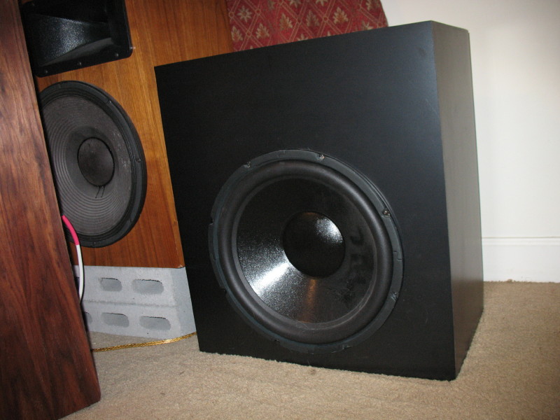

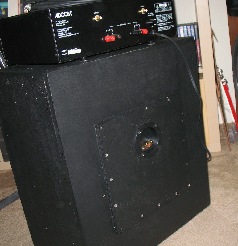

With all the rain we've had this year I've spent a lot of time listening and thinking...thinking about what to do with the Adcom 545 I picked up cheap as a "Summer amp" but really didn't enjoy listening to. Then...(envision light bulb)
...acquired a cheapo 130Hz Dayton dual coil subwoofer crossover, cut it in half, installed each half in a sub, buttoned up the plate amp hole and installed a terminal.

Figuring there might be a SLIGHT mis-match between the 1.8 Watt 45 Amp and the 150 Watt Adcom Laughing Laughing Laughing Laughing Laughing,

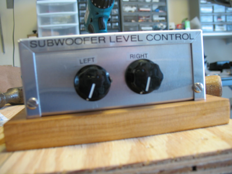

I built a level control with a pair of Alpha 10K mono pots and a $4 Radio Shack project box.
index.php?t=getfile&id=1243&private=0

BTW, if anyone is interested in the level control, don't forget to tie the input and output grounds together. I did at first and heard HUMMMM!
