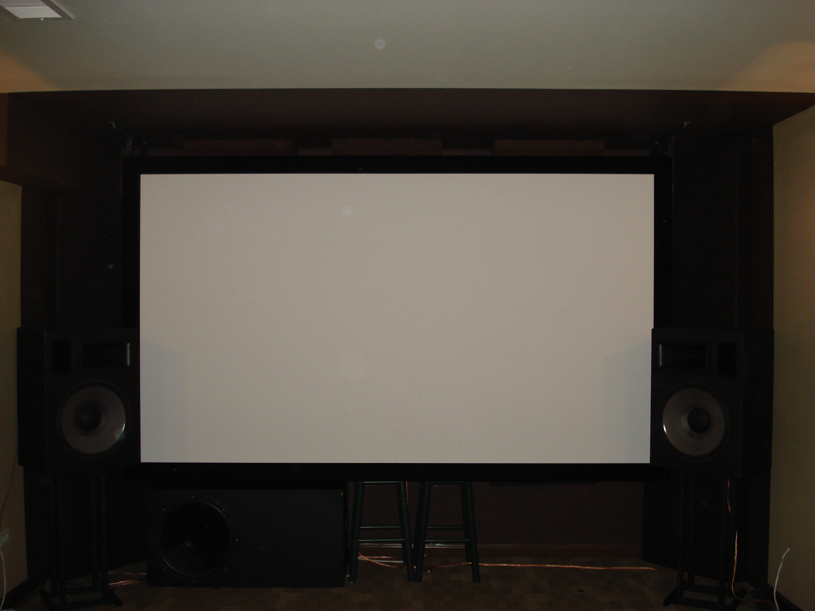

Can you take a look at the attached photo?
I was planning to move the L/R behind the screen. I understand now I won't be gaining anything by doing this as far as the SQ is concerned. So the question is how much I'd lose. I'd prefer the behind the screen placement for safety reasons mostly.
If placed behind the screen, the speakers would still be slightly wider than the left/right-most seat in the room. There won't be directivity reinforcement from the sidewall any more, but I can see some benefit from the fact the speakers will be much closer to the back wall.
What do you think?
index.php?t=getfile&id=923&private=0
Re: L/C/R placement and toe-in [message #74583 is a reply to message #74581] Sun, 25 November 2012 14:22 Go to previous messageGo to next message
There is nothing wrong with bringing them a meter or two closer together, provided they are still outside the seating position. I think your main considerations will be the side wall and front wall reflections (which can be mitigated with flanking subs) and the amount of reflection from the screen, i.e. how "acoustically transparent" it is and how much ripple it introduces from self-interference. We discussed this a little bit on the Basic Black thread.
So but the bottom line is I would try it and see how it sounded to me. Since you have measurement equipment, you can even go a step further than seat-of-the-pants listening impressions: You can make measurements and evaluate your different configurations.
Please do report back what you find!
Re: L/C/R placement and toe-in [message #74585 is a reply to message #74583] Sun, 25 November 2012 15:45 Go to previous message
Messages: 80
Registered: June 2012
Location: Chicago burbs
Thank you.
I have to move the screen forward a little to give enough room to toe-in the L/R as much as I want. I'd also need to mount my projector further back because in its current position it would be too close to fully cover the screen. It is all doable but kind of PITA. That's why I wanted to get your opinion before committing to the project.
