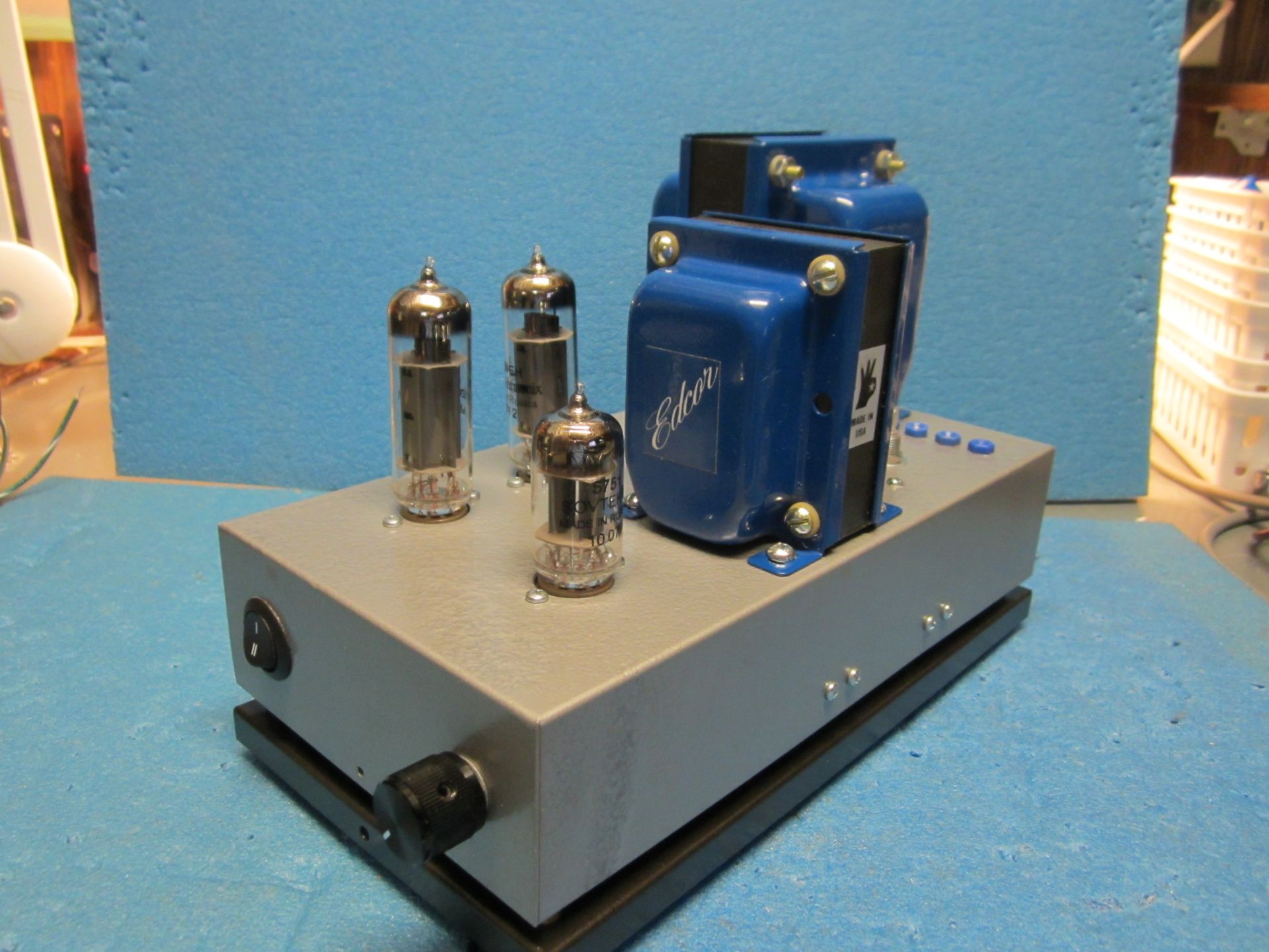

Hi Everyone. I have a pair now of prototype mini-blocks. They are actually an upgraded version of the Poddwatt (that is about to go into series II). Sam power transformer as the Poddwatt in the prototypes and the newly designed Edcor output trannies. Lots of audio grade caps (Jantzen)in the PS. Regulated B+ on the SRPP driver, regulated heater reference voltage. Output is 5.8 watts each and response (flat to below 10HZ and out to 50K), S/N (88-90 dbw) and distortion (below 0.25% at 1 watt)are excellent. I would guess they are about 6 months before initial sales. No price yet as we are still sourcing parts.
index.php?t=getfile&id=853&private=0
Prototype of Mini-Mono Block
Re: Mini mono blocks [message #73748 is a reply to message #73747] Wed, 05 September 2012 11:11 Go to previous messageGo to next message
Oh, man, Bruce, the specs sound great. Chassis looks great too. Your usual excellence, just wonderful.
I realize you're still pricing, but do you have a ballpark in mind?
