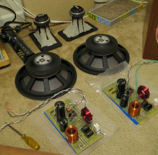

Wayne Parham wrote on Thu, 07 June 2012 10:07
We use Erse Super Q (laminated steel-core) coils in the constant directivity cornerhorns - but do not use them in the matched-directivity two-ways. The woofer in the cornerhorns is only used for bass and so an iron core is fine. But the two-ways run the woofer through the midrange, and I suggest air-core coils only for them.
Yes! Don't do what I say, do what I do! Laughing Rolling Eyes Laughing Rolling Eyes Laughing Rolling Eyes

Bill, On each of your crossovers you have 2 large black capacitors. One real tall standing up on your crossover and then another about half the height. What is the scoop on what you are using? If I may ask.

I'll jump in here for Bill. The Caps you see are Obbligato film and oil caps. They are very good for their price and are affordable for the highish values you need for crossovers. I used to use motor run caps from GE but now also use the Obbligatos in my 4 Pis. Really good stuff. I also use them as parafeed caps in my tube amps/preamps.
