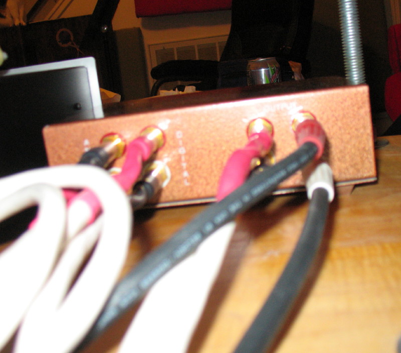

After more than 3 years without, I finally have my subs back and it didn't take, as I thought it wouold, a major investment. I was pretty sure one of the plate amps was kaput but it turned out to be a cabling issue.
Last night I discovered that one of the "Y" connectors had a broken ground so I fixed it. Then I got to thinking that both "Y"s were made with inferior RCAs so this morning, I drilled for and installed a second set of Vampire CM-Hex in the pre-amp.
index.php?t=getfile&id=783&private=0
When I set up the second sub it worked fine without any hum and after some fiddling with levels and crssover points, I 've got richer, deeper bass with little to no boom. 2 channels and placement right behind the Pis means, just as Wayne says, a higher crossover point may be used w/o confusing the imaging. Nice!
