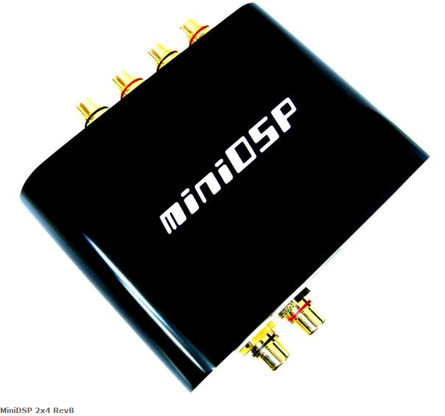

Any suggestions? I know you used to use a modified Pyle crossover, but I do not have the electronics skill required to do so.
I have looked at a miniDSP unit, cost is about $135 (more than I wanted to spend). However, if I go with a MiniDSP 2x4 (2 input, 4 output) and associated 2 way Advanced 2.1 plugin I should be able to set low and high pass filters for Left, right and mono subwoofer outputs (w/ Butterworth up to 8th order (6 to 48dB/oct); Linkwitz-Riley up to 8th order (12 to 48dB/oct); and Bessel - 2nd order). In addition, the unit has 6 parametric EQ bands per output, 6 EQ bands per input, Frequency, Gain, Q configurable, and Peak of Shelf (low/high). It is powered from the USB input used to program the box. Should be sufficient for my needs.

Does anyone here have experience with the unit? I know it is popular on AVSForum and other DIY websites.

The MiniDSP would work nicely, because you can use it to set whatever low-pass frequency and slope you want. I'd probably lean towards that since it gives you such flexibility. Sub crossovers are easier to dial-in than the crossovers inside the mains. Measurements help, of course, but you can set the subwoofer low-pass pretty well by ear.
Remember - we don't high-pass the mains when running flanking subs. We only low-pass the subs. Actually, you can rolloff out-of-band signals by high-passing the mains at 40Hz, but don't go higher than that. We want the mains and the flanking subs to blend in the room's modal region.
