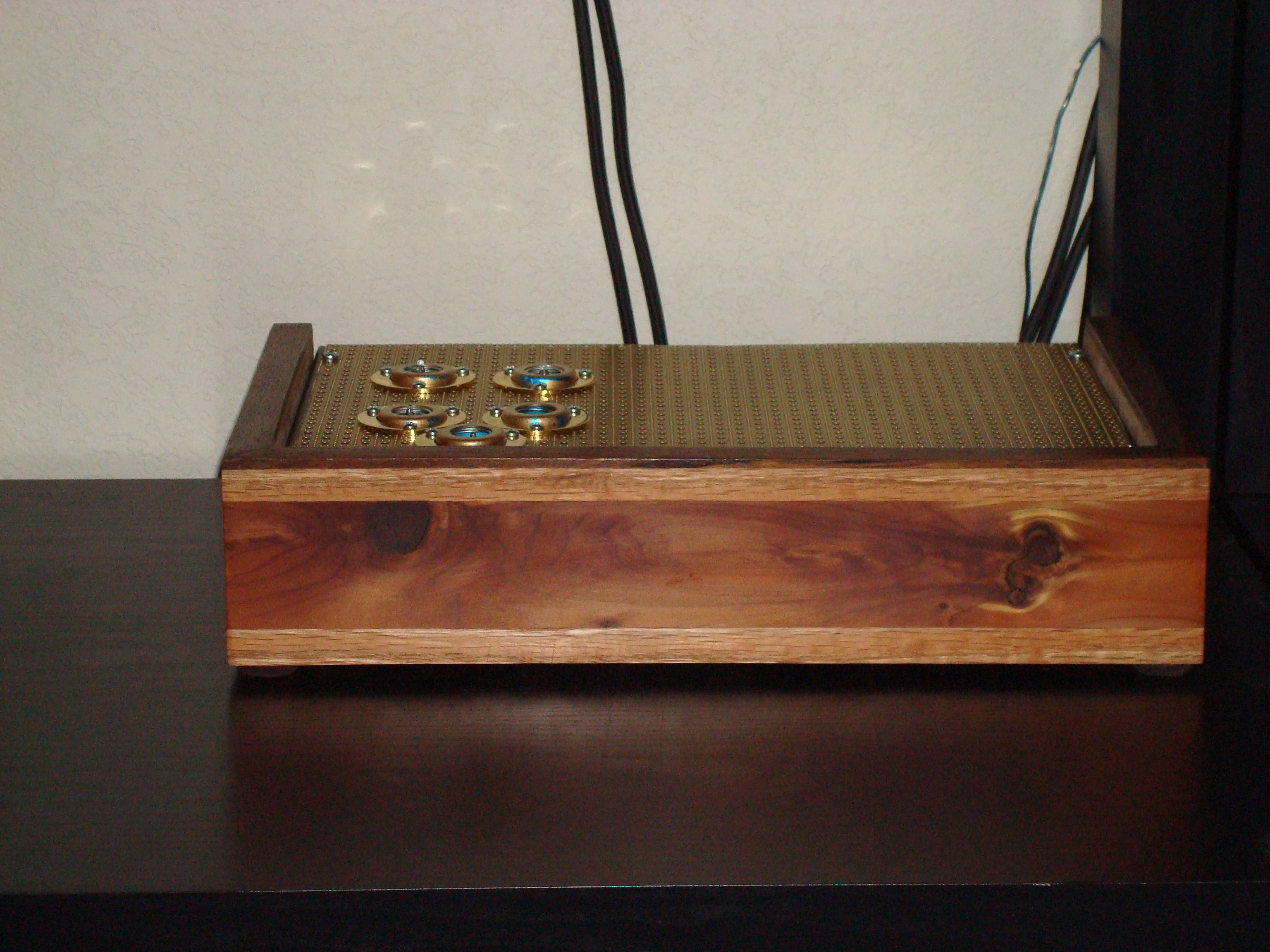

Hi, It is on its way for the upgrade. I'll let you all know if it is better or (hopefully not) worse than before. While it isn't quite a "source" I attached a photo of the latest incarnation of my tube phono preamp. It is right at the -90 dbv spec now and sounds great. I'm still doing tube rolling on it as many are inconsistent on gain or not quiet or even a few just don't sound nice. Best setup at present is input and second gain stages use JJ ECC803S and the output stage is a JJ gold pin ECC81.
