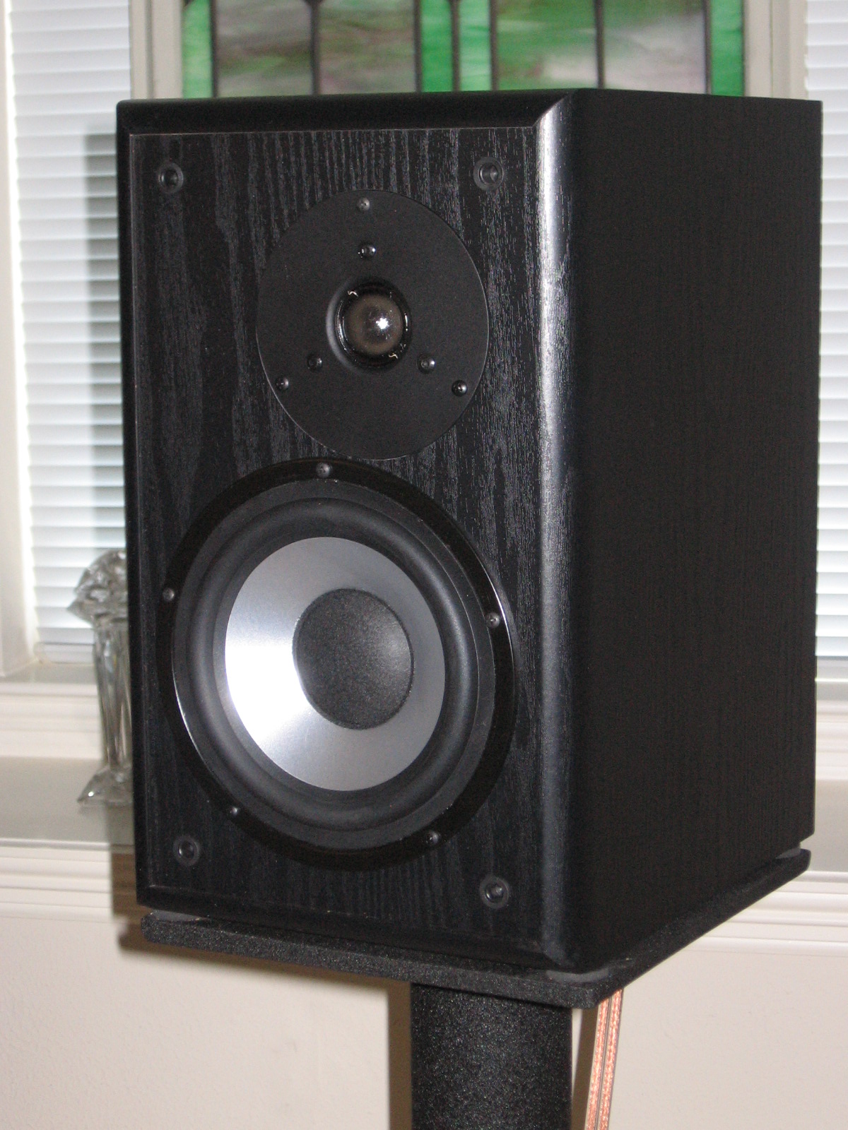

So I completed my Indignia pair a few days ago and they sound wonderful, with good but not exaggerated bass, midrange and treble to die for, and a great soundstage. The only downside is that they achieve this at the cost of efficiency, and they can play only so loud before the woofer runs out of steam and starts to make noise. They are not a party speaker, but they're great for listening at reasonable volume levels.
The key to building them for less than $200 is to use a pair of the $54 Parts Express #300-645 enclosures. These are intended for the PE 6.5" classic paper cone woofer, and the 7" aluminum cone woofer used in the Indignias will not fit into the woofer recess, but it will cover it nicely if new pilot holes are crefully drilled into the baffle. If you use the furniture-finished curved cabinets shown in the project showcase the cost will bump up to more than $300 and you'll have to cut your own driver and port holes. This is already done for you with the BR-1 cabinets. With either alternative you still have to assemble and solder the crossover parts, which I mounted on a 4" by 7" piece of perfboard and hot glued to the bottom of the enclosure.

Here's a picture of an Indignia built into the BR-1 enclosure:
