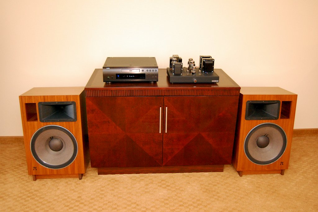

I recently purchased a couple of JBL 2226H's and EV DH1A's with HP940 horns, and am looking for guidance with regards to cabinet size, crossover(800Hz or 1.2kHz) and porting.

Looks like the EV does well to cross at 800 but some experimentation is in order 'cause the 2226 has such a wonderful mid-range. Higher might be better.
The 4Pi is a 2.5 cu ft box tuned to 40 Hz but larger, up to 4 cu ft works well, too.
Wayne will arrive eventually and you'll see, "you have mail", the plans and crossover schemas, that is.

I don't know about the EV DH1A/HP940 horn tweeters, but the four π loudspeaker uses the JBL 2226H midwoofer and the Eminence H290 horn with either PSD2002-8 or DE250-8 compression drivers. I'd be happy to send plans if you're interested.

I would appreciate any assistance with regards to building a cabinet to properly load the 2226H(approx. 3 - 4 cubic feet) and a crossover to go with the EV DH1A/HP940 combo(i.e. box dimensions, bracing, horn placement, port size/placement, 1.2kHz crossover etc.). That is a lot to ask for, I know. And, after looking at the Pi speakers and reading reviews about them, I'm sure that I would be happy with something very similar. Is it possible to do this with the drivers I've chosen?

Matched directivity two-way loudspeakers [message #52593 is a reply to message #52589] Mon, 08 September 2008 23:01 Go to previous messageGo to next message
Like virtually every other compression driver + CD horn combo, HF rolloff is predictable, since power response falls off at 6dB/octave and horn directivity is constant. The goal of designers using a horn like this is to combine it with other drivers or horns that have matching directivity. You'll want to design the crossover and set baffle spacing for a forward axis normal to the baffle, with null angles preferably just outside the vertical pattern of the HF horn. Crossover frequency should be approximately where the midwoofer's pattern narrows to equal the tweeter's horizontal pattern. Summing should be flat on axis and at all angles within the pattern.
This describes the basic approach. It isn't terribly difficult, but it isn't trivial either. I put a lot of time in each of my designs to make sure they are optimized. If you don't have measurement equipment, you can calculate phase angles and determine driver spacing to approximate crossover frequency and slope but this is rather tedious. For best results, you'll want to get the design close by calculation and verify with measurements, fine tuning as necessary.
You've got mail! [message #52595 is a reply to message #52590] Mon, 08 September 2008 23:16 Go to previous messageGo to next message
I've sent plans for the four π loudspeaker. This will give you a starting point.
To be very honest, my suggestion is to sell the EV drivers and horns on eBay and use the money to get H290 horns and B&C DE250 compression drivers. Then you can build four π speakers as designed with JBL 2226 woofers and DE250/H290 tweeter horns.
This is not to say the horns/drivers you have are better or worse, although I will say the DE250 is a very good driver and the H290 horn is perfect for this application. But even if the EV DH1A/HP940 is also very good, it will still take a fairly substantial design effort to configure the crossover and speaker layout properly.
It takes dozens, sometimes hundreds of man-hours to design and optimize a speaker like this, and that's if you've already done enough of them that they're practically a templated design. So even if you start with the four π plans and modify them, I would expect several full days work with a good measurement system to get everything right.
