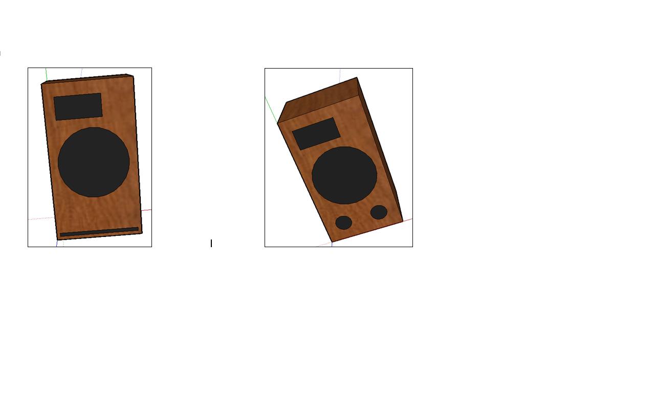

Re: 4 Pi Design Questions [message #61751 is a reply to message #61737] Wed, 20 January 2010 20:59 Go to previous messageGo to next message
Messages: 21
Registered: December 2009
Location: Virginia
I have two different port designs (see attached). Is the slot port design better at attenuating midrange frequencies from the backwave of the bass driver?
Re: 4 Pi Design Questions [message #61752 is a reply to message #61751] Wed, 20 January 2010 21:09 Go to previous messageGo to next message
Messages: 19102
Generally, ducts that are long and thin tend to develop internal standing waves and those can be a problem. Then again, you can get around them with the right placement and just being long and thin isn't always a problem. In the end, you'll have to measure the cabinet to know for sure.
