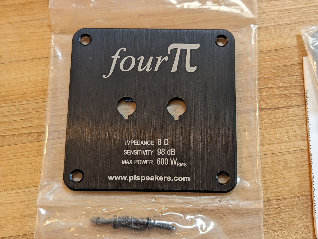

The terminal plates are back after getting laser engraved. I think they turned out nicely. I went with a slightly different design than what I posted above. If anyone wants to copy this, feel free to PM me for a vector file.
/forum/index.php?t=getfile&id=3361&private=0
/forum/index.php?t=getfile&id=3362&private=0

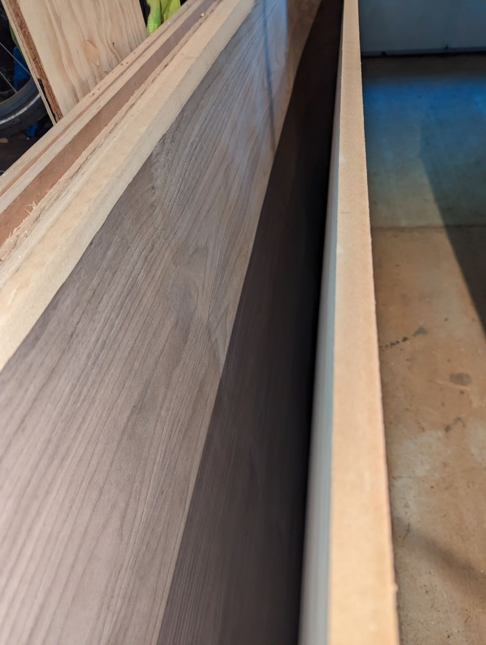

Yesterday I picked up a couple sheets of MDF along with Walnut veneer. I unrolled the veneer sheet and sandwiched it between the fiber boards so it would start to flatten out.
/forum/index.php?t=getfile&id=3363&private=0

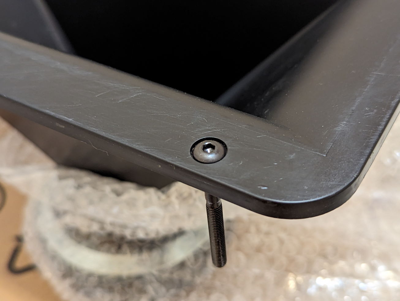

I purchased all the fasteners for the drivers from McMaster. For anyone interested, this is what I ordered:
Woofer
91251A550 Black-Oxide Socket Head Screw, 1/4"-20 x 2"
90975A307 Steel Tee Nut 1/4"-20
Waveguide
91255A278 Black-Oxide Button Head Hex Screw, 10-32 x 2"
90975A306 Steel Tee Nut 10-32
Crossover boards
94639A342 Nylon Spacer, 5/16" OD, 1/4" Long, for Number 8 Screw Size
/forum/index.php?t=getfile&id=3364&private=0
/forum/index.php?t=getfile&id=3365&private=0
