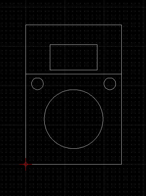

I've looked at a lot of designs and had a long hard talk with these cabinets. They told me that they really want to be 4pi. The plan would be to remove the baffles and install an airtight horizontal divider. The woofer would live in it's own enclosure of whatever volume we decide. The picture shows it at 23" from the bottom which gives 3.5 ft3. I've also drawn 2 ports of 3" diameter. I would take frequency response measurements and post them here. I'd make any suggested changes and ask Wayne for his approval before affixing the pi logo.
