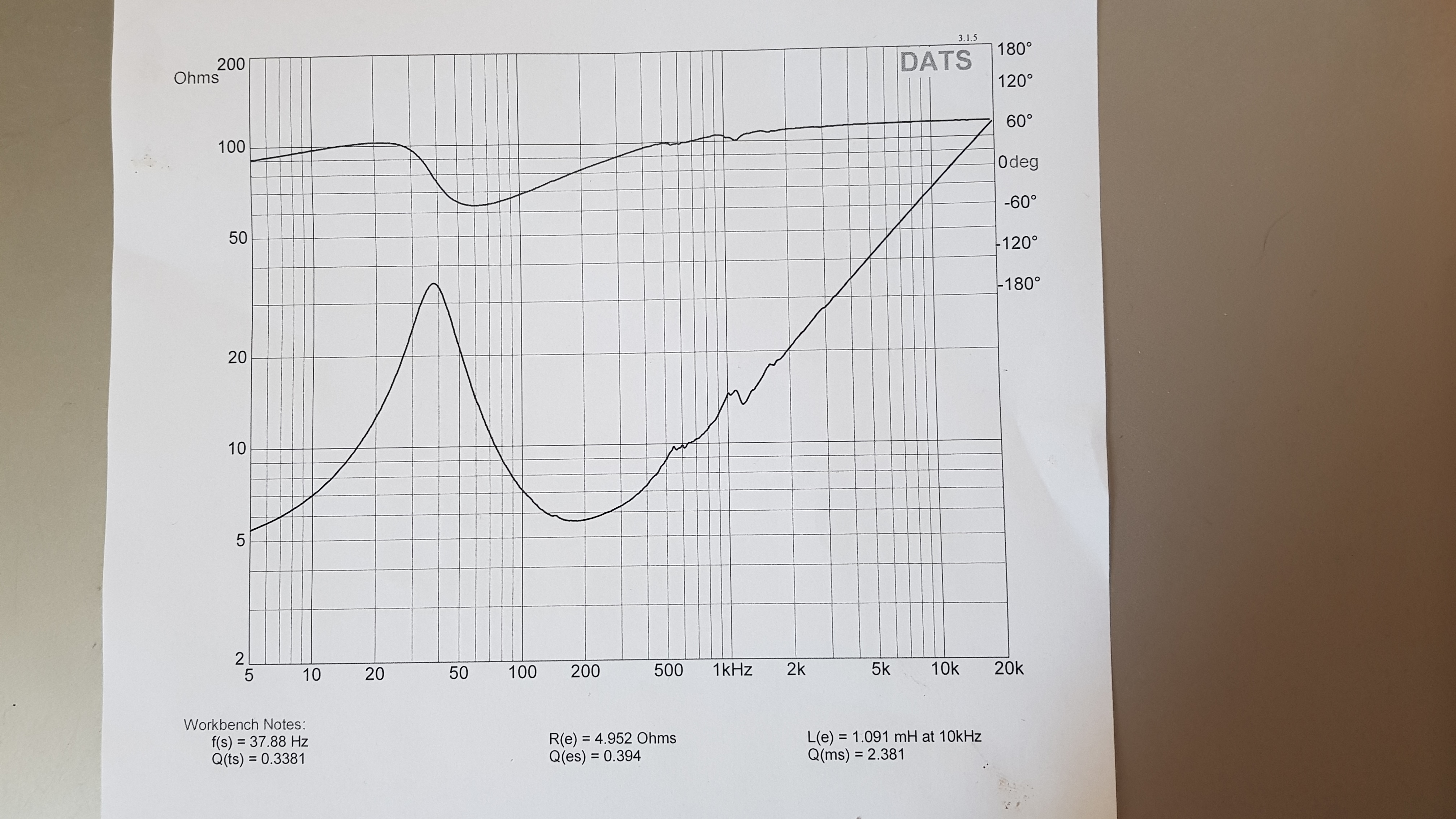

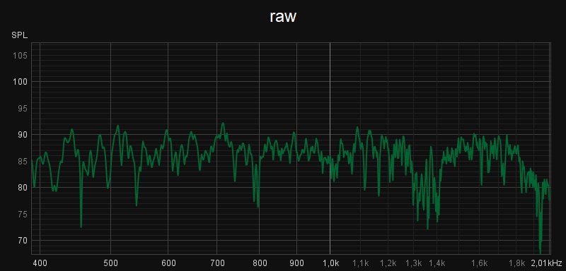

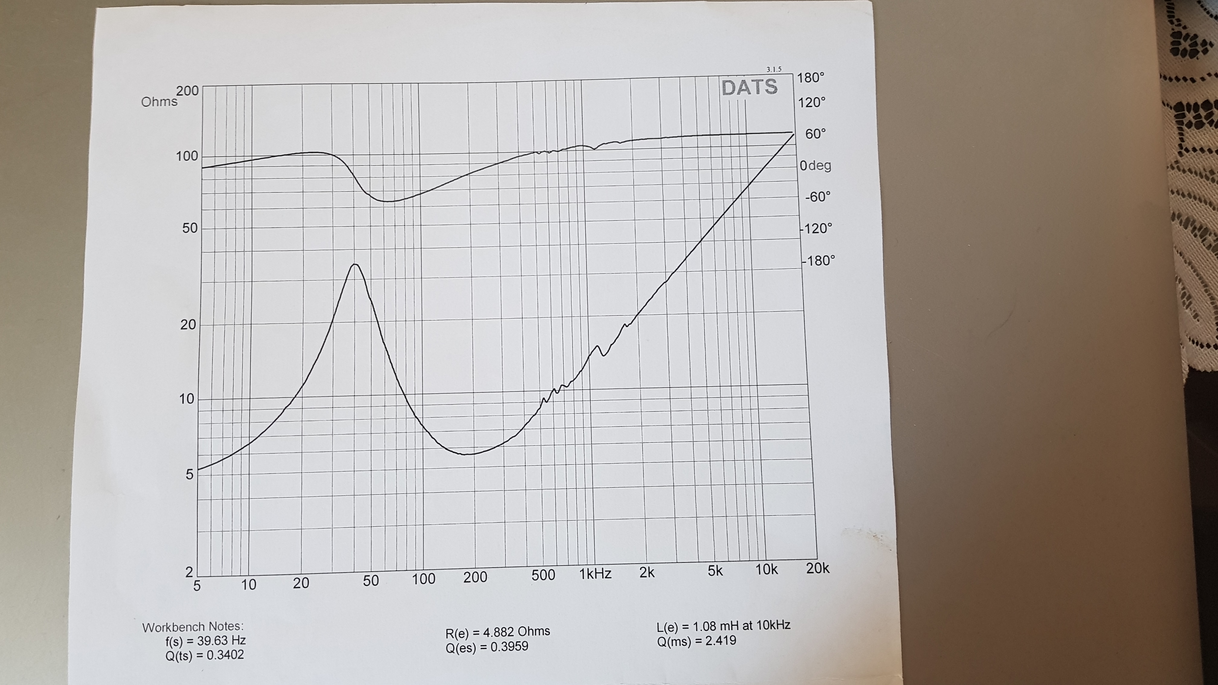

I was not sure if the woofers were original or reconed, so I took some raw measurements of the JBL 2226H. I did not find raw measurements on this site, but found several on the net. I think they look quite similar, but would like Wayne or others to have a look for peace of mind. I bought them used, and the seller was kind enough to provide impedance measurements on request (free air) before I bought them. REW measurements are done at 1m on axis.
