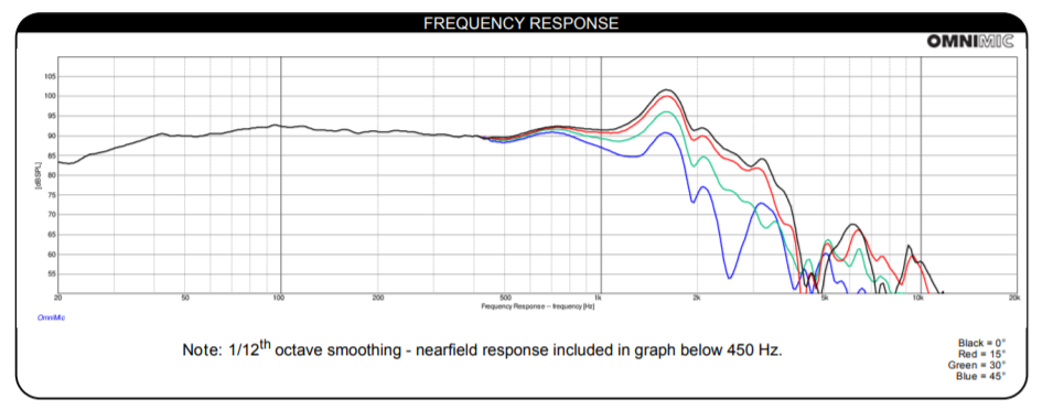

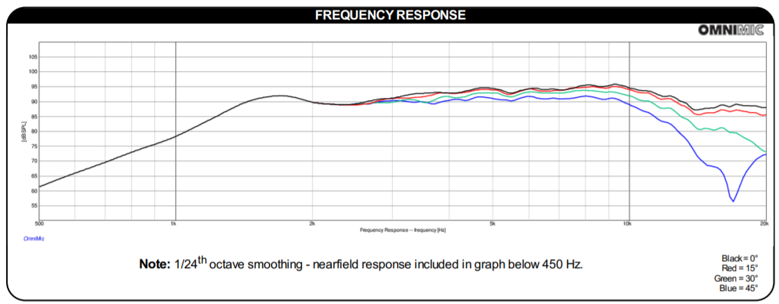

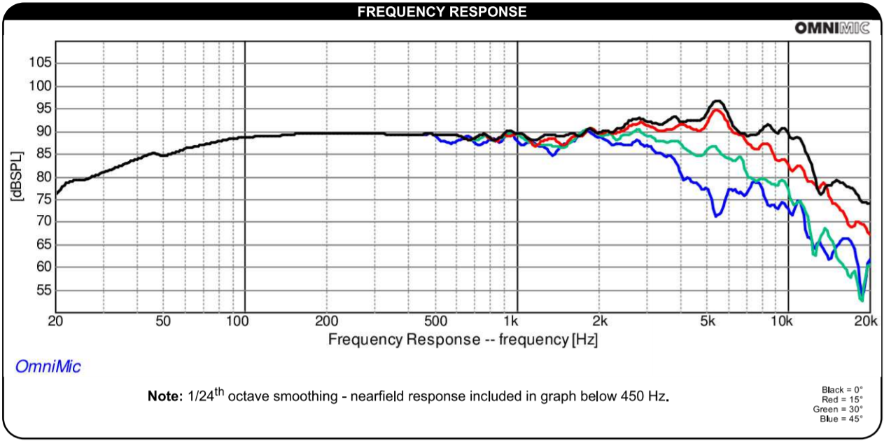

I don't have measurement software, but have considered the Dayton DATS system. Looks like there is also freeware out there but I haven't researched it. I installed VituixCAD and I'm reeling from the learning curve. Dayton speakers have SPL and impedance files that are easily imported so I was playing around with some of those.

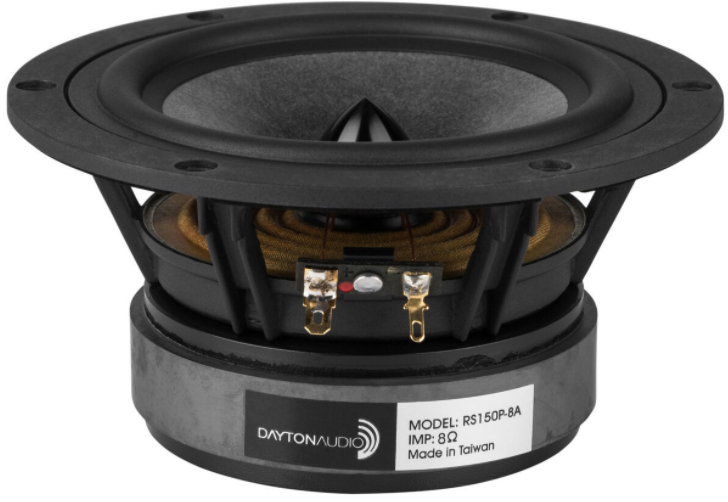

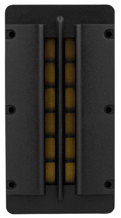

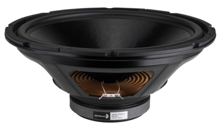

I figured a 15" woofer DC380 would stay with the original theme. For mids, the 8" size of the Aztec seems too large - all the SPL graphs seem to start breaking up at mid freqs. The 6" RS150P is a full range design with a whizzer cone that looks smoother at mid freqs. Maybe even two of those. Then I was looking at planar tweeters, so maybe the PT2C. Maybe even two of those, as well.
