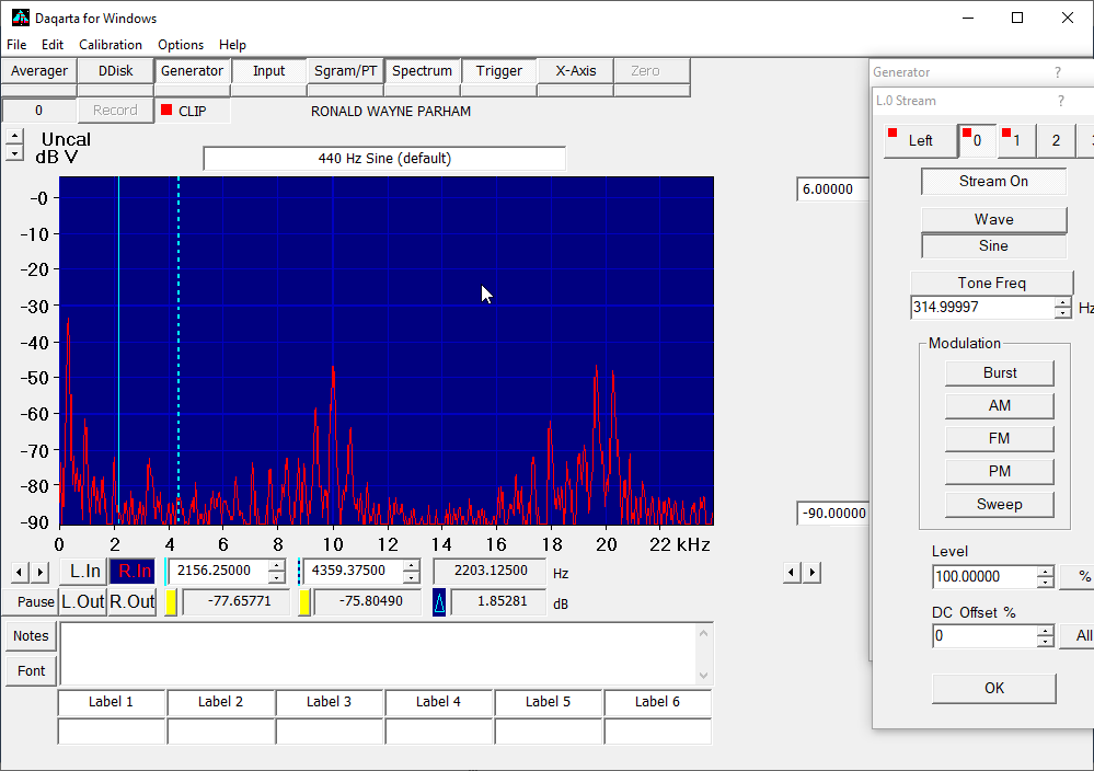

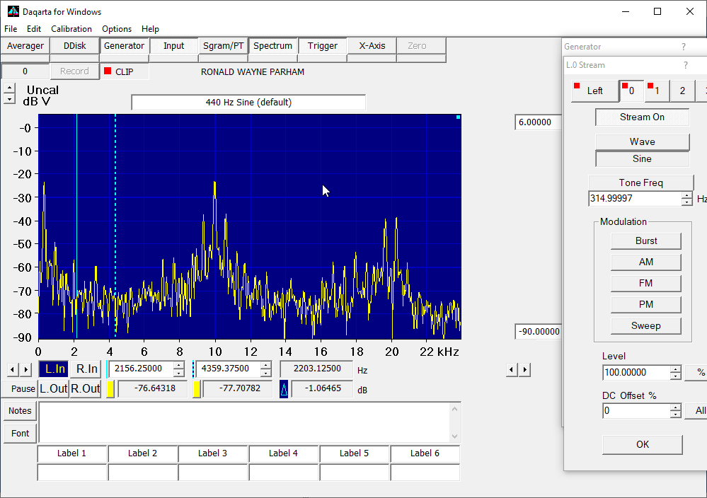

I did that for a while, and then decided to create a dual-tone signal that combined the 315Hz sine with the 10kHz sine. I monitored the output with Daqarta's spectrum analyzer so I could see both the 315Hz content and the 10kHz content. That made it easier to set the levels to match. Then as a "sanity check," I used single-frequency sines of 315Hz and 10kHz to make sure the levels were matched when a pure sine wave was presented.
Pay attention to the relative amplitudes of the signals below at 315Hz and at 10kHz:
/forum/index.php?t=getfile&id=2435&private=0
Before adjusting bias: Right channel bias NOT set
/forum/index.php?t=getfile&id=2436&private=0
Right channel bias properly set
/forum/index.php?t=getfile&id=2437&private=0
Left channel bias properly set
