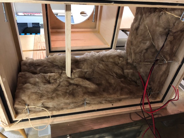

Working on insulation. Decided to put 2" wood screws around the perimeter of where any insulation is being installed to tether it in place. These will be moved around from time to time to various functions, so I wanted to make sure insulation is held in place well.
index.php?t=getfile&id=2165&private=0
Cut separate pieces for each side and cut openings for wiring and braces. Tried to leave enough area around port so air would not be restricted.
index.php?t=getfile&id=2164&private=0
index.php?t=getfile&id=2163&private=0
Also reamed hole of t-nut for wave guide that was out of place and reinstalled.
