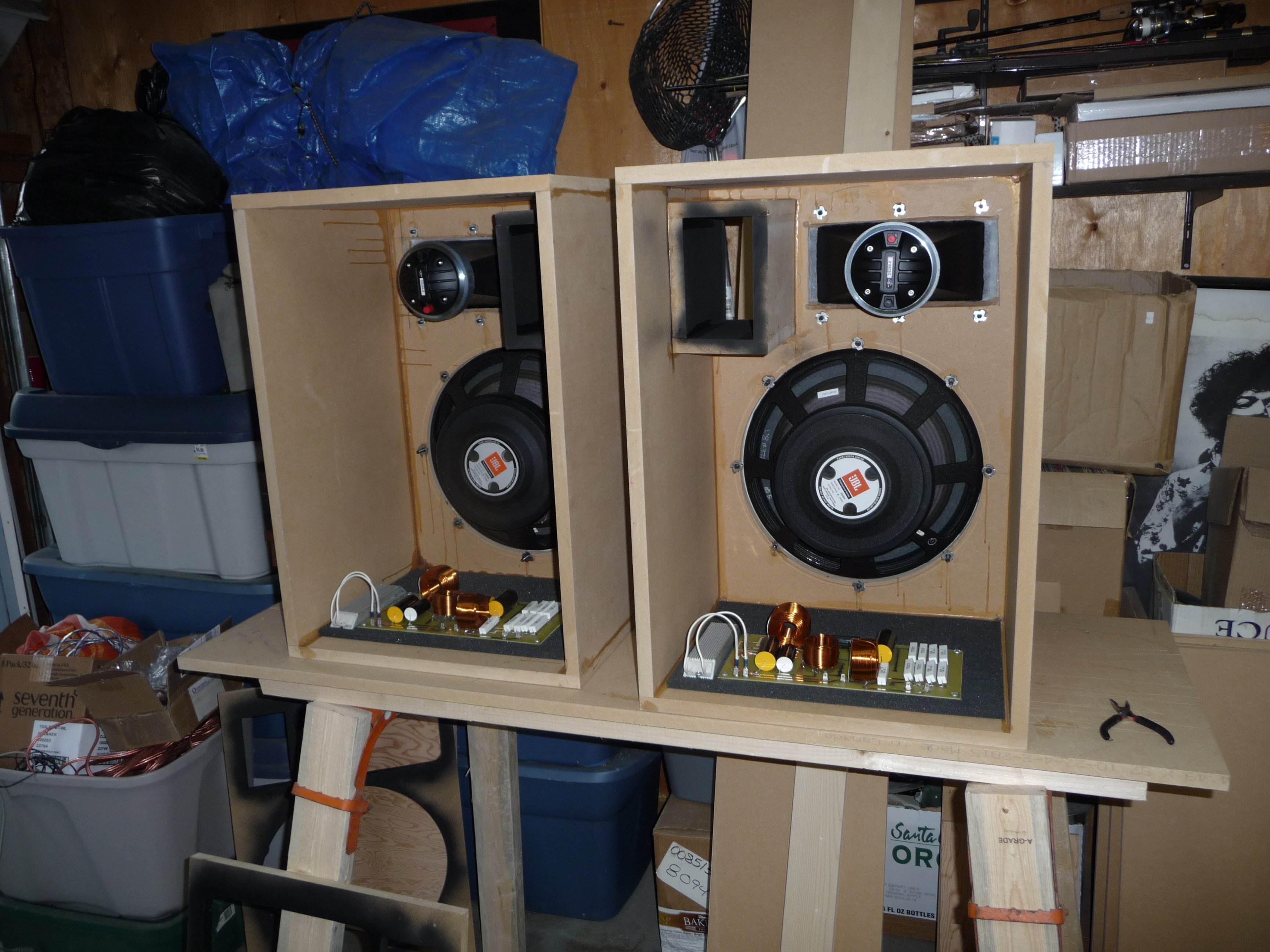

Hello Pi Speaker fans, and Hi to Wayne, the man behind the design. I've recently completed my 4 Pi build and thought I'd share a bit of the process, as well as my thoughts on these amazing speakers.
After much research and contemplating which speakers to either buy or build, I ended up settling on Wayne's 4 Pi design for a few reasons; I wanted something highly efficient, 8 ohms, and something suitable for high volume heavy rock and metal. I wanted speakers that I could use with a low power OTL amp, or any other amp of my choosing.
I found a nice deal on the JBL 2226 woofers so I pulled the trigger and ordered the crossovers and horn waveguides from Wayne; I then proceeded to acquire the DE250 drivers as per the design. I decided to give the waveguide and woofers a countersunk look by simply making the front baffle double thickness, mounting everything to the face of the inner baffle and then routering the outer baffle to fit over everything. I also modified the cabinet design a touch more with a double-thick rear wall as well. These things weigh a ton, but are solid as a rock with the recommended inner bracing.
I decided to cover them with countertop laminate as opposed to veneer so they would be durable and safe from scratching or other damage. Though it is not cheap and increased my total build cost by over $300, I think it was well worth it. It allowed me to get the look that I had envisioned, which is part of the fun in doing projects like this.. to see if I can make it look as good or better than I can imagine it:-)
I've only had them done for a day or so and one listening session but I can say with confidence that my mind is sufficiently blown. Totally and fully. I figured they'd sound quite good but they sound even better than I'd imagined. They're the best sounding speakers I've ever heard, though I admit I've only heard a handful of decent speakers. I do know that I've never heard such punch in the midbass range, it's stunning all the way up on the volume, to levels that no human should endure for too long. It's just that it sounds so good I want to turn it up and up and not stop listening. I'm still in awe, to be quite honest.

Pics..
