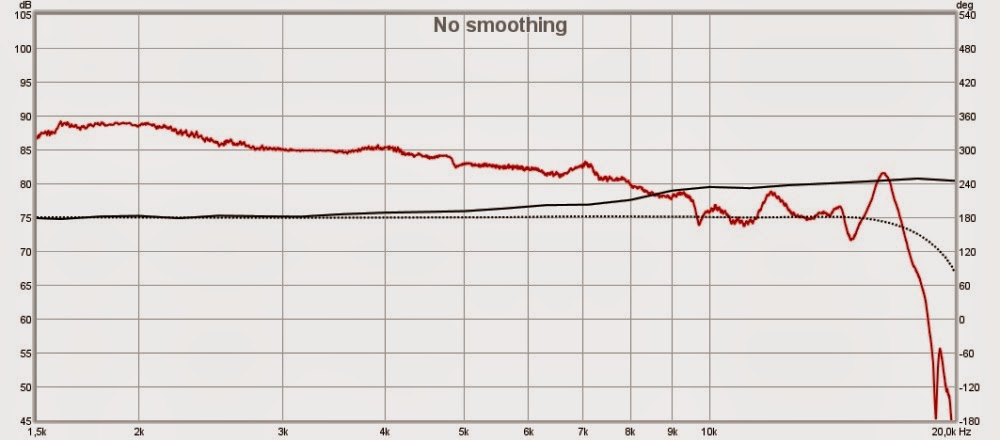

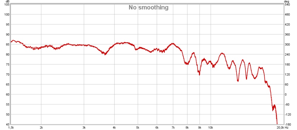

Disconnecting the tweeter is something for tomorrow or the weekend. I measured the right tweeter (still connected to the crossover) with another mic.
This is the result:
index.php?t=getfile&id=1726&private=0
The mic that was used for this measurement isn't perfect, but compared to the measurement with the ecm8000 mic + CAL-file, the same roloff appears...
earlier measurement with ecm8000 and CAL-file

I guess measuring the tweeter disconnected will give a better image of the sound. To be continued...
