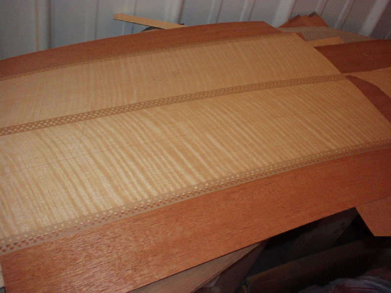

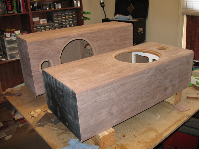

Awww, go for it...but make it easy on yourself, 4x8 sheets of NBS veneer from Tape Ease and contact cement. One sheet does it if you paint the backs.
I've done PPR, hide glue (lots), yellow heat bond(sucks!) and even 3M spray-on (disaster) on backed and raw veneer; contact has worked and held up best for me.
Don't do this:
index.php?t=getfile&id=1394&private=0
Do this Smile
