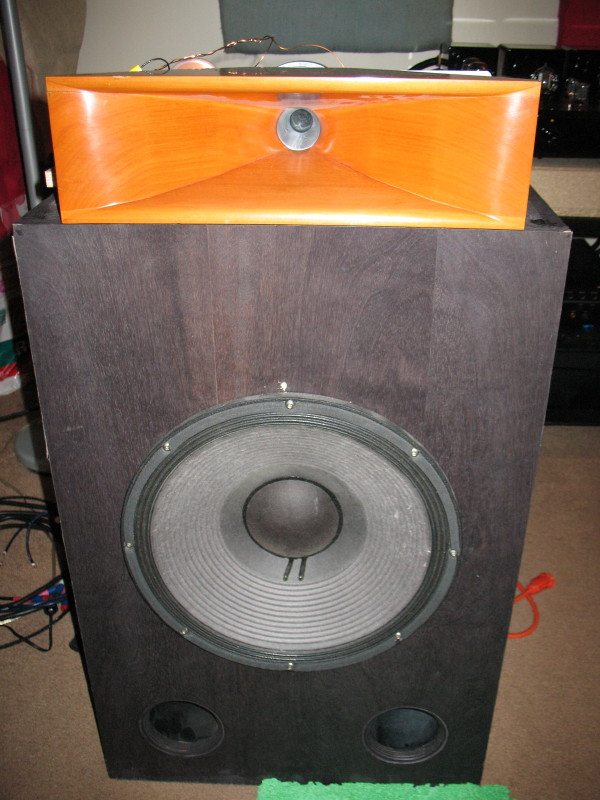

Some may remember I long ago cut down the BatSpeakers
index.php?t=getfile&id=1239&private=0
and installed the 15" Dayton Classics with mis-matched plate amps.
index.php?t=getfile&id=1240&private=0
Last year one amp quit and I hadn't been happy with the other from the start so left the subs out of the system 'til now.
With all the rain we've had this year I've spent a lot of time listening and thinking...thinking about what to do with the Adcom 545 I picked up cheap as a "Summer amp" but really didn't enjoy listening to. Then...(envision light bulb)
...acquired a cheapo 130Hz Dayton dual coil subwoofer crossover, cut it in half, installed each half in a sub, buttoned up the plate amp hole and installed a terminal.

Subs are playing nicely with the 4Pis which is especially gratifying 'cause my "pre-amp" is passive; the level controls make the combo work.
A new pair of plate amps would have been $250 and hum is always an issue with them. I spent less than $50 bucks over what I already had in the Adcom and parts drawer RCAs, etc.

but it's great getting all the notes down to 27Hz or so.
