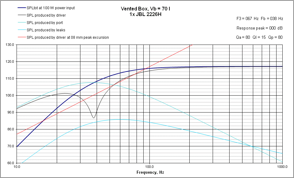

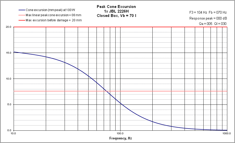

Here are some response and excursion charts, for comparison:
index.php?t=getfile&id=946&private=0
Response of four π loudspeaker
index.php?t=getfile&id=950&private=0
Woofer excursion on standard four π loudspeaker
index.php?t=getfile&id=948&private=0

index.php?t=getfile&id=951&private=0
Woofer excursion on sealed four π
