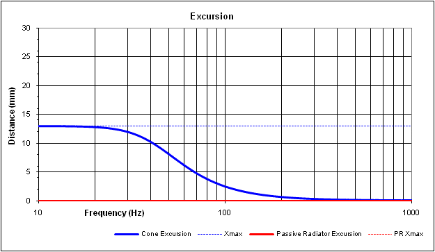

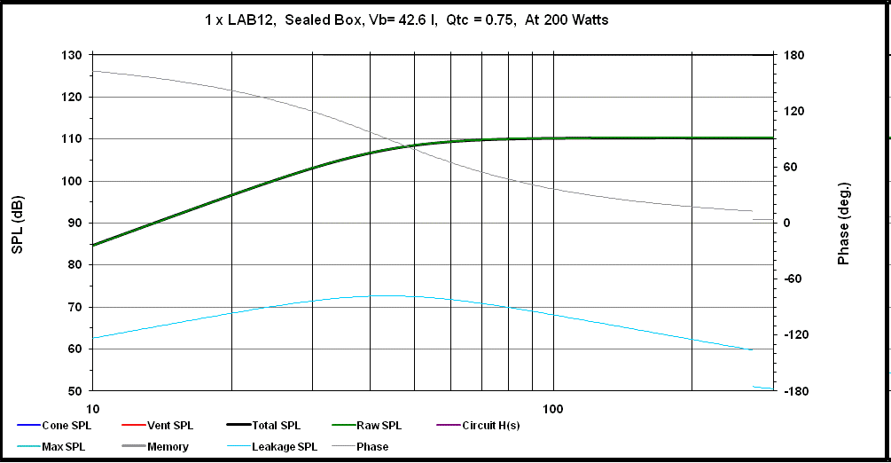

Just ordered two of the 3 Pi subwoofer kits. Laughing Laughing Laughing
I am having a local Cambodian furniture maker build two 16" x 16" x 16" boxes from 1" thick plywood for $50.00. I am sure it is not going to be baltic birch at that price, but should be good enough to last the two years I am over here.
Sealed box is 1.5 ft^3 with a Qts of 0.75. Calculated relative -3 dB Point = 42.19 Hz, -6 dB Point = 32.59 Hz and 10 dB Point = 24.93 Hz; should be more than adequate for flanking subs.
index.php?t=getfile&id=585&private=0
index.php?t=getfile&id=586&private=0
