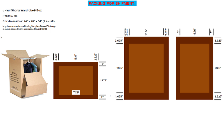

Just got word today, the speakers will be boxed for my move on Monday. Will just have enough time to veneer them on Sat with 24-48 hours to dry before packing. The painted front/rear baffles will have "cured" for a little over 7 days - the brochure indicated 14 - 28 days before attempting to clean with cleaning materials.
I am going to box them myself - but not seal the box so that the mover is responsible for damages. I found boxes of the appropriate size on uHauls website (see attachment).
index.php?t=getfile&id=518&private=0
As of now, my plan is to enclose the box in all three dimensions with rigid foam insulation (2" thick) and wrap the speakers initially with Mover's Stretch Plastic Wrap (also from uHaul) and then bubble wrap. The three layers of protection plus heavy taping of the outside of the box to secure joints should offer pretty good protection. The boxes must fit into a large shipping crate - along with 2500 pounds of household goods (and electronics) - that will be sealed for transport.
Would adding a ½" thick plywood to the bottom of the box add anything or is it just a waste of material? I will ensure that the speakers do not have room to move inside of the boxes.
Thanks for any feedback on my packing scheme, I am open to suggestions.
