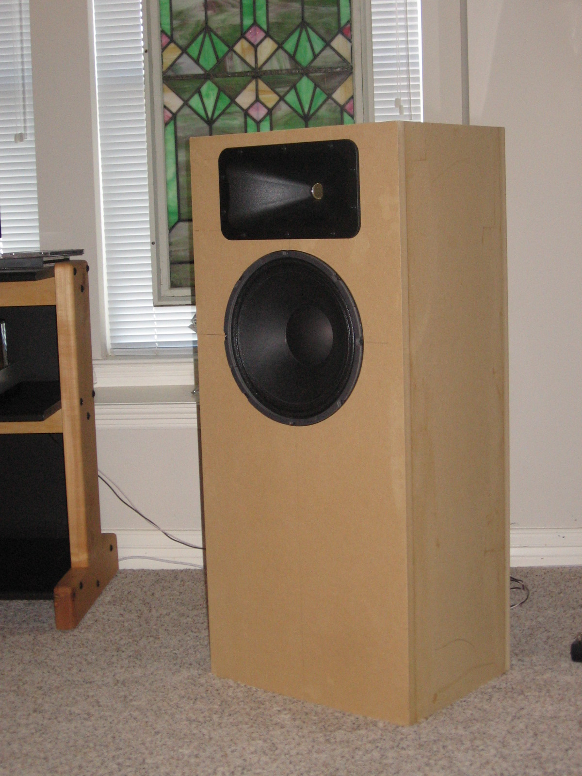

The AudioFred AudioKarma EconoWaves continue to evolve, first with the replacement of the 2 cu ft standmount enclosure with a 4 cu ft floorstander, and then with the addition of a rear-firing bipolar waveguide tweeter. The larger enclosure has extended the bass response enough for these speakers to sound good without a subwoofer. For the rear-firing tweeter I used a Dayton 6X6 waveguide with an Eminence ASD-1001 compression tweeter.
