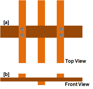

Next weekend I will add the bracing. I am thinking of using one .75" x 2.5" [a] oak piece side to side w/ three 0.75" x 1.5" [b] oak pieces as shown:
index.php?t=getfile&id=430&private=0
As I already have the wood as leftover from a different project I figured three front-to-back is better than one, it does add an extra 0.025 ft^3 of volume but I think this is probably negligible.
Could this bracing modification do more harm than good?
