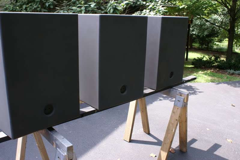

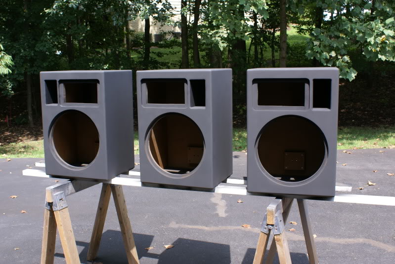

UPDATE:
I put on two coats of Bulls-Eye sanding sealer and sanded. The MDF soaked it up like a sponge.
Sprayed on a coat of sanding primer. While not required for the Duratex it will help in finding any remaining voids and rough spots that need some attention before putting on the Duratex.
http://www.PiSpeakers.com/DIY/BigmouthinDC/BigmouthinDC_4Pi_HomeTheater_10_Painted.jpg

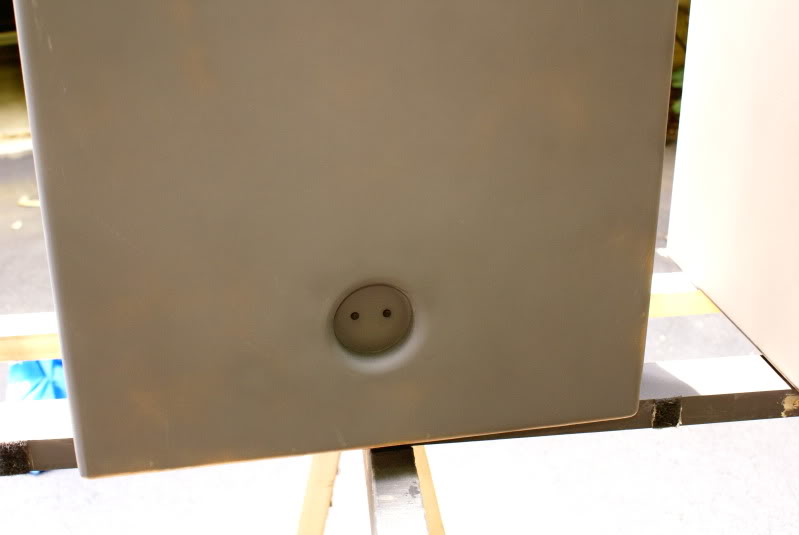

Also pics of the recesses for the banana binding posts.
http://www.PiSpeakers.com/DIY/BigmouthinDC/BigmouthinDC_4Pi_HomeTheater_11_Backside.jpg
http://www.PiSpeakers.com/DIY/BigmouthinDC/BigmouthinDC_4Pi_HomeTheater_12_BindingPostRecess.jpg
