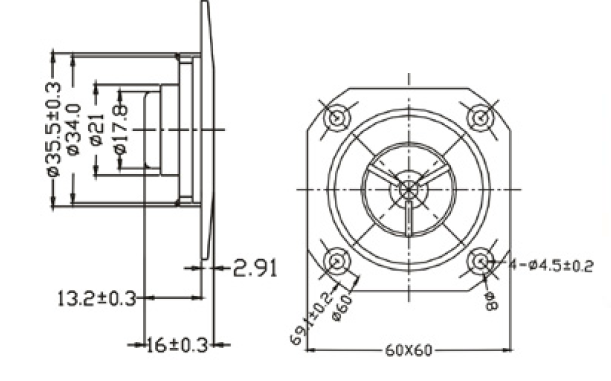

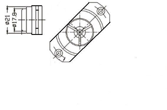

What did you end up with for spacing on your tweeters. Seems like 30 wouldn't be long enough, especially when modified. Do tweeters line not have to be as long a woofer lines?
Do you have any pictures of arrays that you've built?
When looking at the technical drawing of the Tang Band 13-1264SA, it actually looks like they can be cut down to 21mm. What are your thoughts? index.php?t=getfile&id=55&private=0index.php?t=getfile&id=54&private=0
