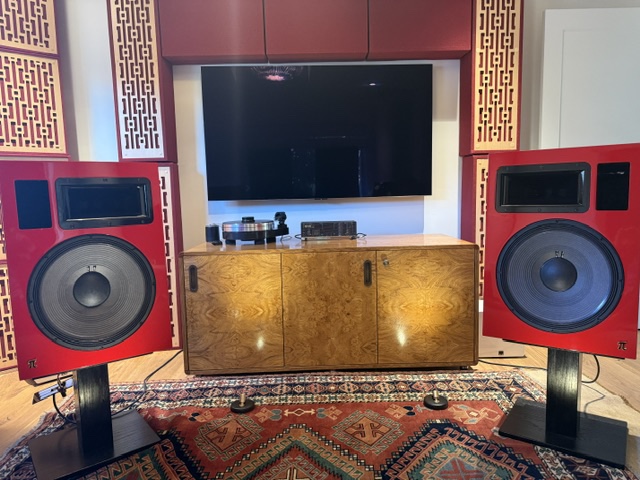

Breaking them in now. Painting- especially the prep was a labor of love. Initially running these with a Dynaco St-35 tube amp but will be switching to ModWright Class A mono blocks and a ModWright Analog Bridge.

Thanks- I will be moving them to a room that is 14'x14'x9' High vaulted ceilings. Will use 4 subs to help me address standing waves and bass issues that I bet I'll have. I might reach out to you for a little guidance.

Be sure to use flanking subs for two of your subs.  That is part of the overall system design, because it not only contributes to modal smoothing but also to baffle-step compensation and SBIR mitigation.
Then place the other two subs in a Welti or Geddes configuration.
Actually, by the time you get to four subs, most agree that it almost doesn't matter where you put them as long as they aren't grouped together.  You can choose placement where is most convenient or placement guided by measurements or a by a little bit of both.
