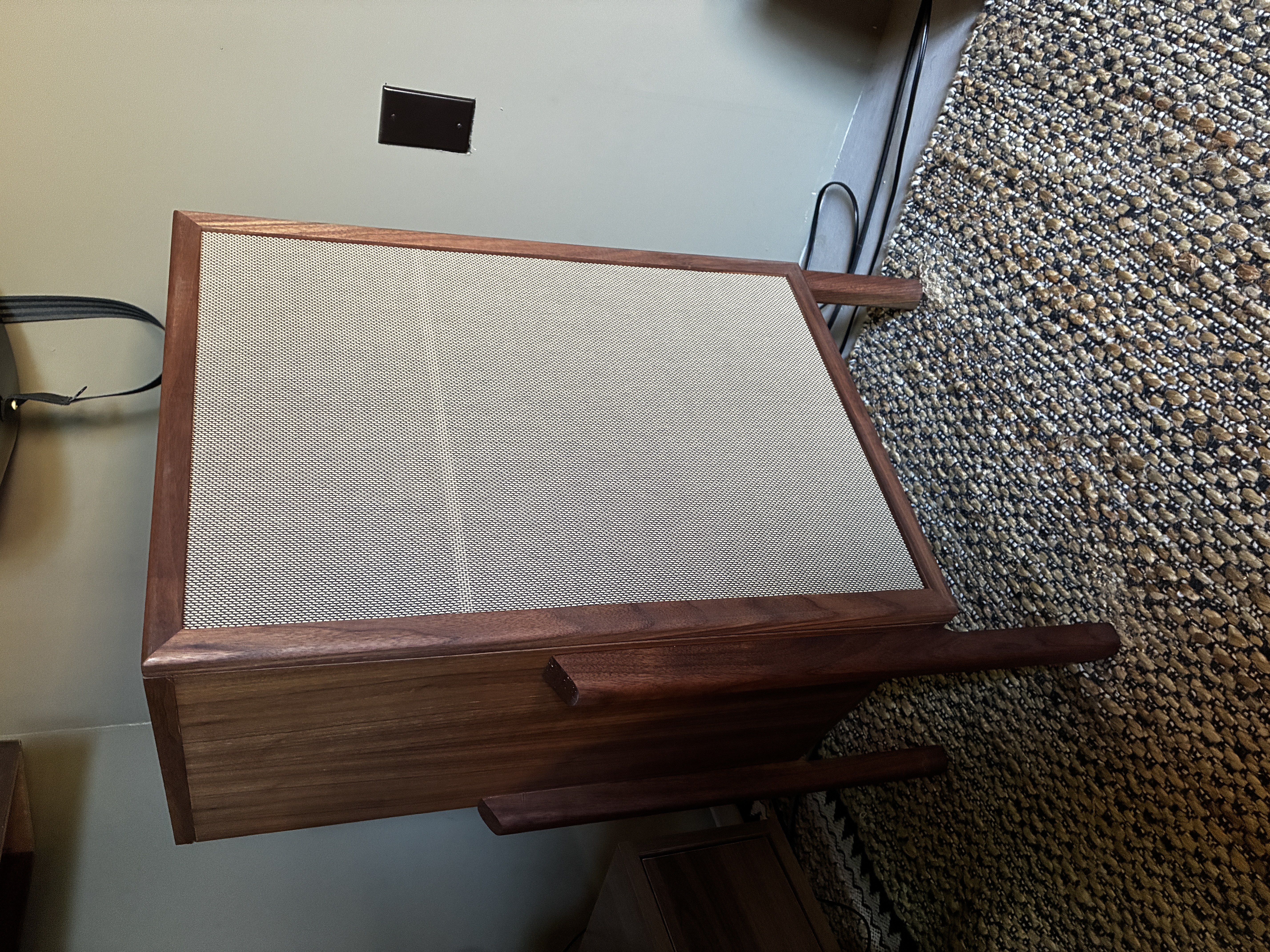

Made some removable grilles. Because children.
/forum/index.php?t=getfile&id=3599&private=0
Re: 4pi: Cabinetmaker's build [message #99646 is a reply to message #99645] Tue, 04 August 2026 21:41 Go to previous message
Man, that looks incredible!
