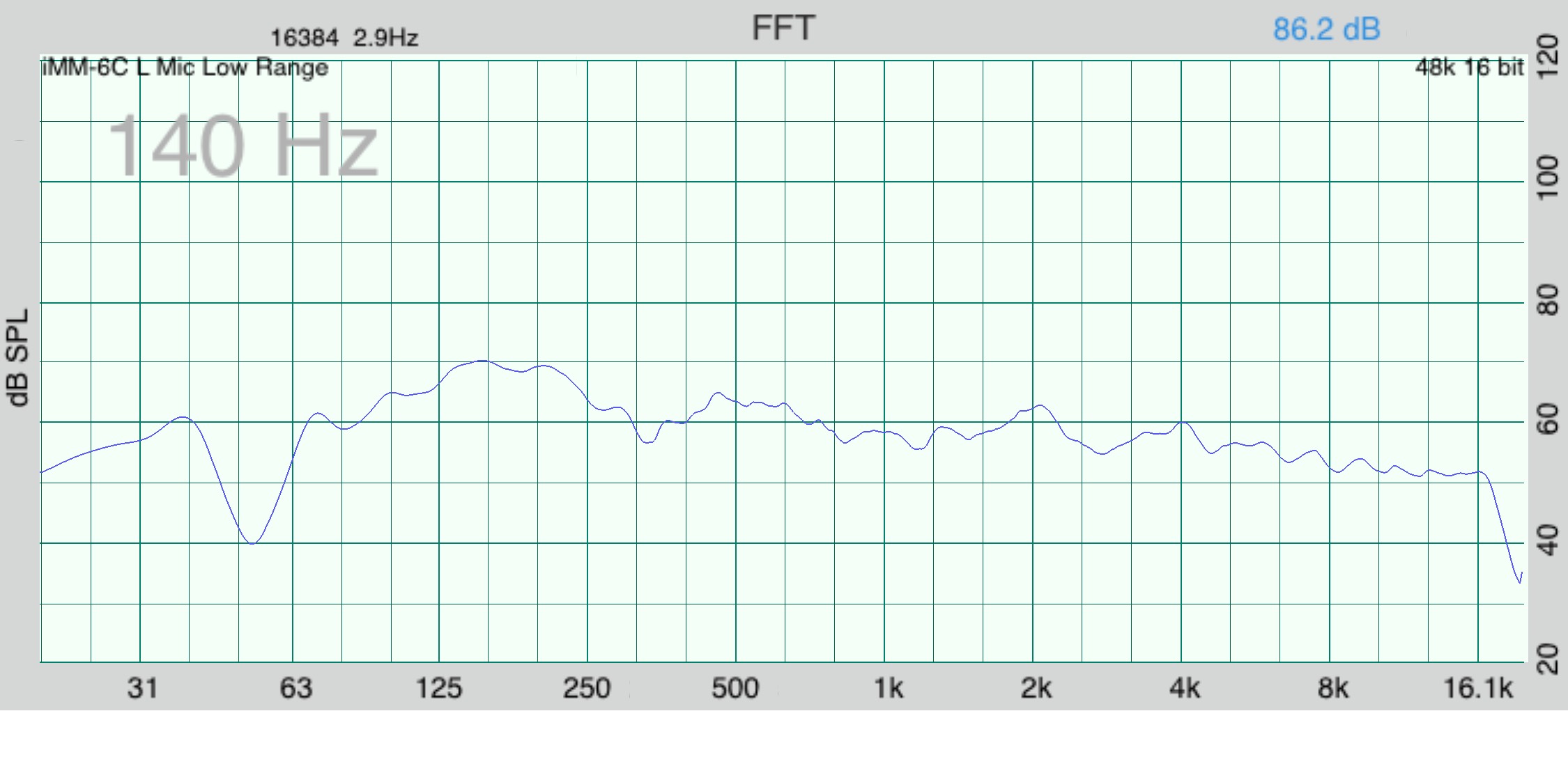

I picked up a Dayton Audio iMM-6C calibrated mic and bought the Audio Tools app. I can get pink noise but don't see a way to measure with a sweep. Is there a tutorial somewhere on how to use this setup for measuring frequency response?
Re: 4pi: Cabinetmaker's build [message #99563 is a reply to message #99562] Tue, 07 July 2026 09:42 Go to previous messageGo to next message
I don't use that application - I use WTPro for development and LMS for publishing - but I will say that there should be a way to choose the source signal.  Some common test source signals are sine sweep, stepped sine, log sine (chirp), noise, MLS and TDS.
Also note that many systems offer gating for pseudo-anechoic measurements.  This allows you to make measurements indoors, because you can configure the system to only sample for a short (gated) period.  This prevents reflections from interfering with the measurement, but it also limits measurement of low frequencies.  It's great for checking the crossover region though, which is often useful during development.

/forum/index.php?t=getfile&id=3597&private=0
Here's what I get with pink noise, 20s average. This is in-room, not sure how to do a gated test with this app.
