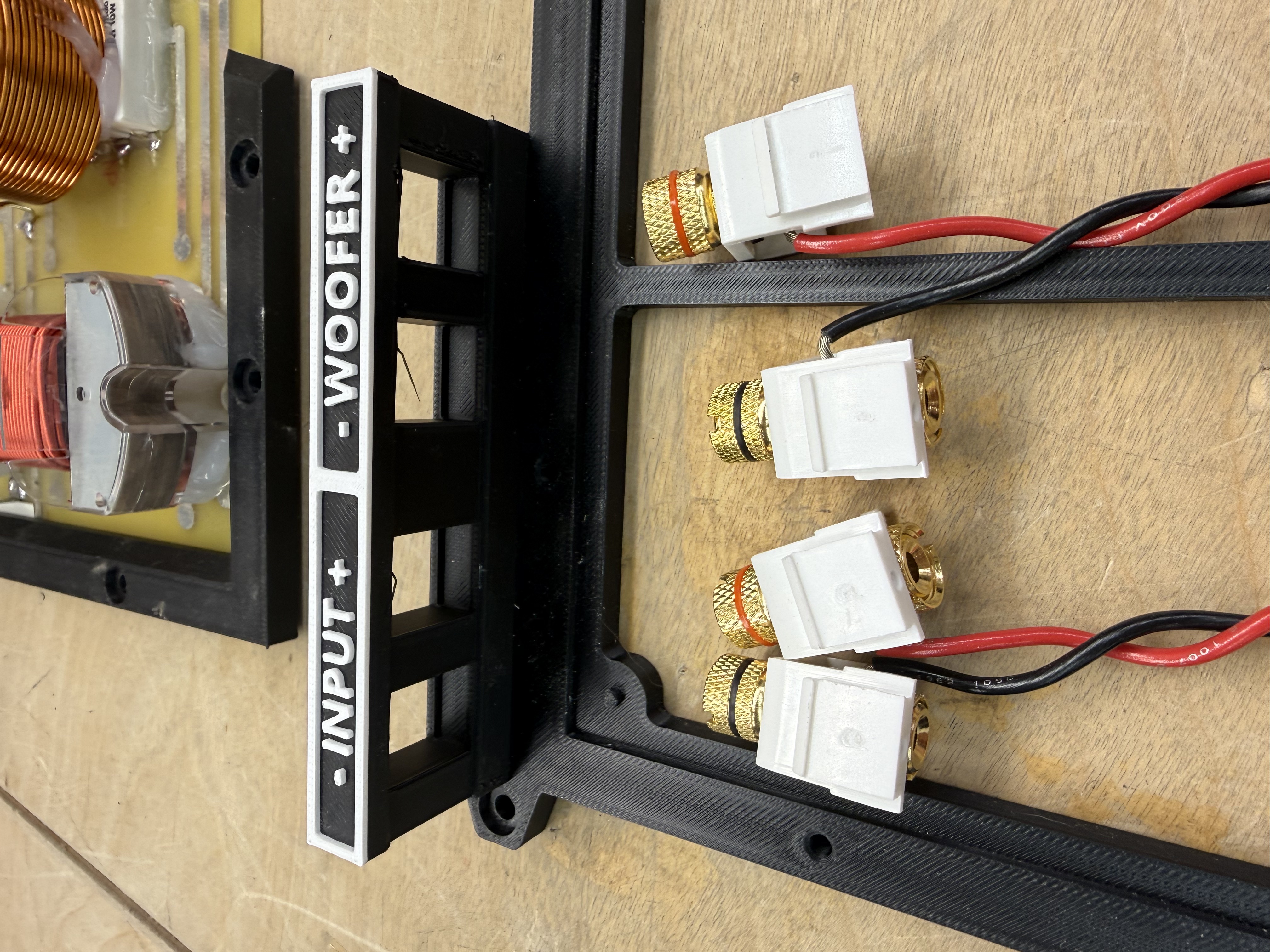

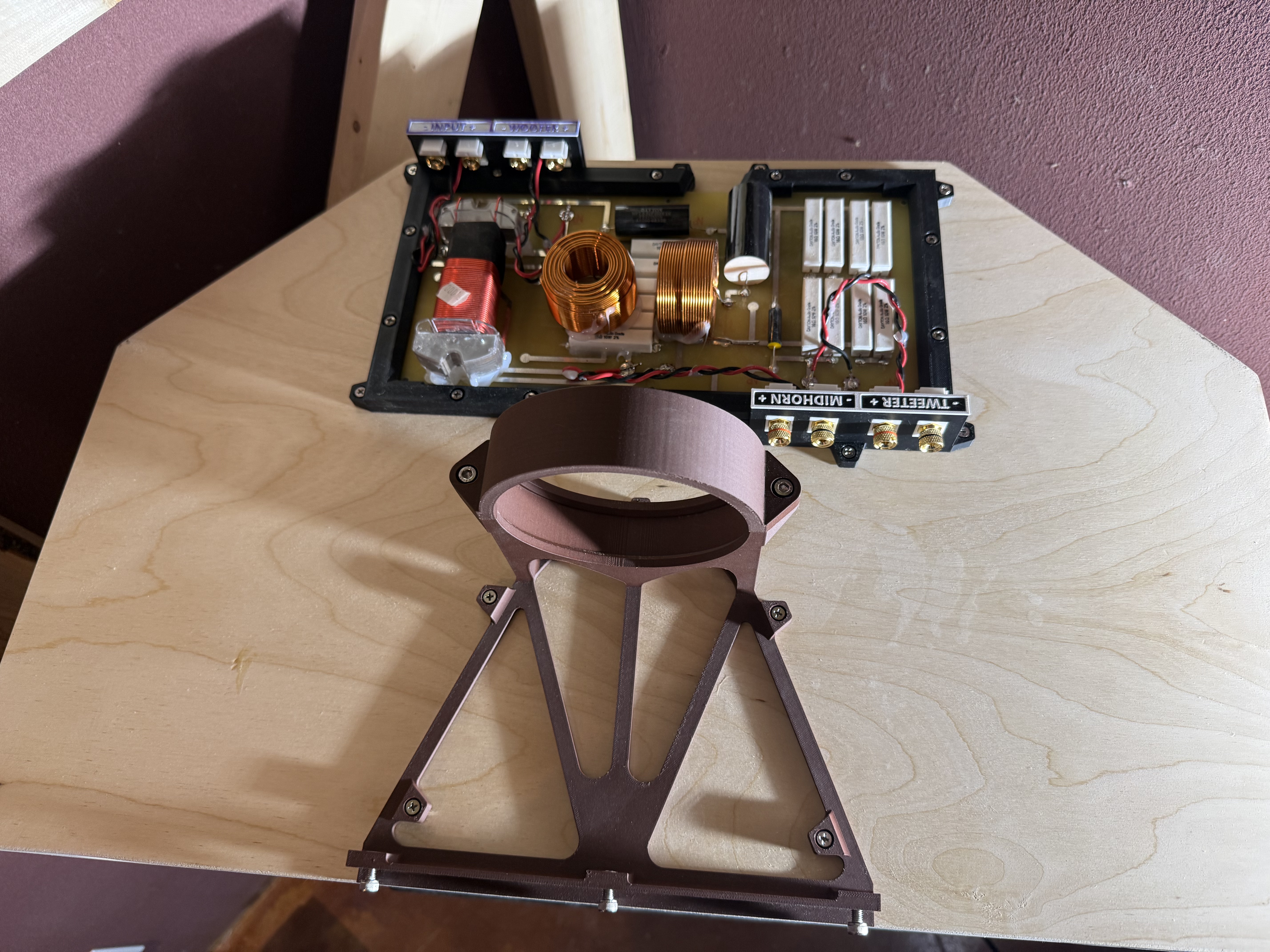

Here are a couple of closeups of the crossovers and mounting brackets that I 3D printed.  I split the bracket into two parts to fit the print bed on my Bambu printer.  The brackets have keystone panels for the banana jack inserts.  I downloaded a print for the keystone panel and modified for this use.
/forum/index.php?t=getfile&id=3580&private=0

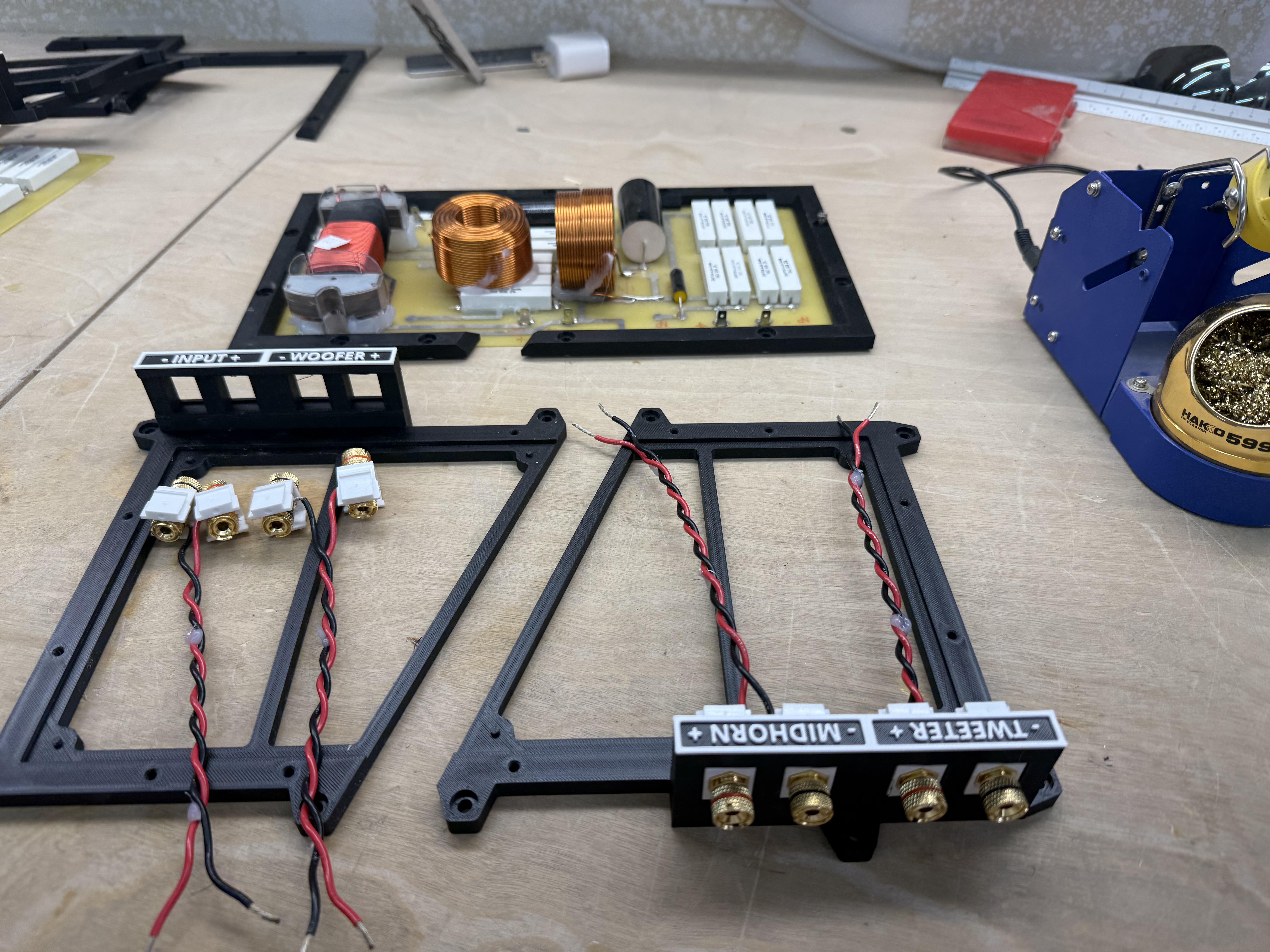

Another shot of the completed XOs and the midhorn with crossovers and tweeter horn mount installed.
/forum/index.php?t=getfile&id=3582&private=0
/forum/index.php?t=getfile&id=3583&private=0

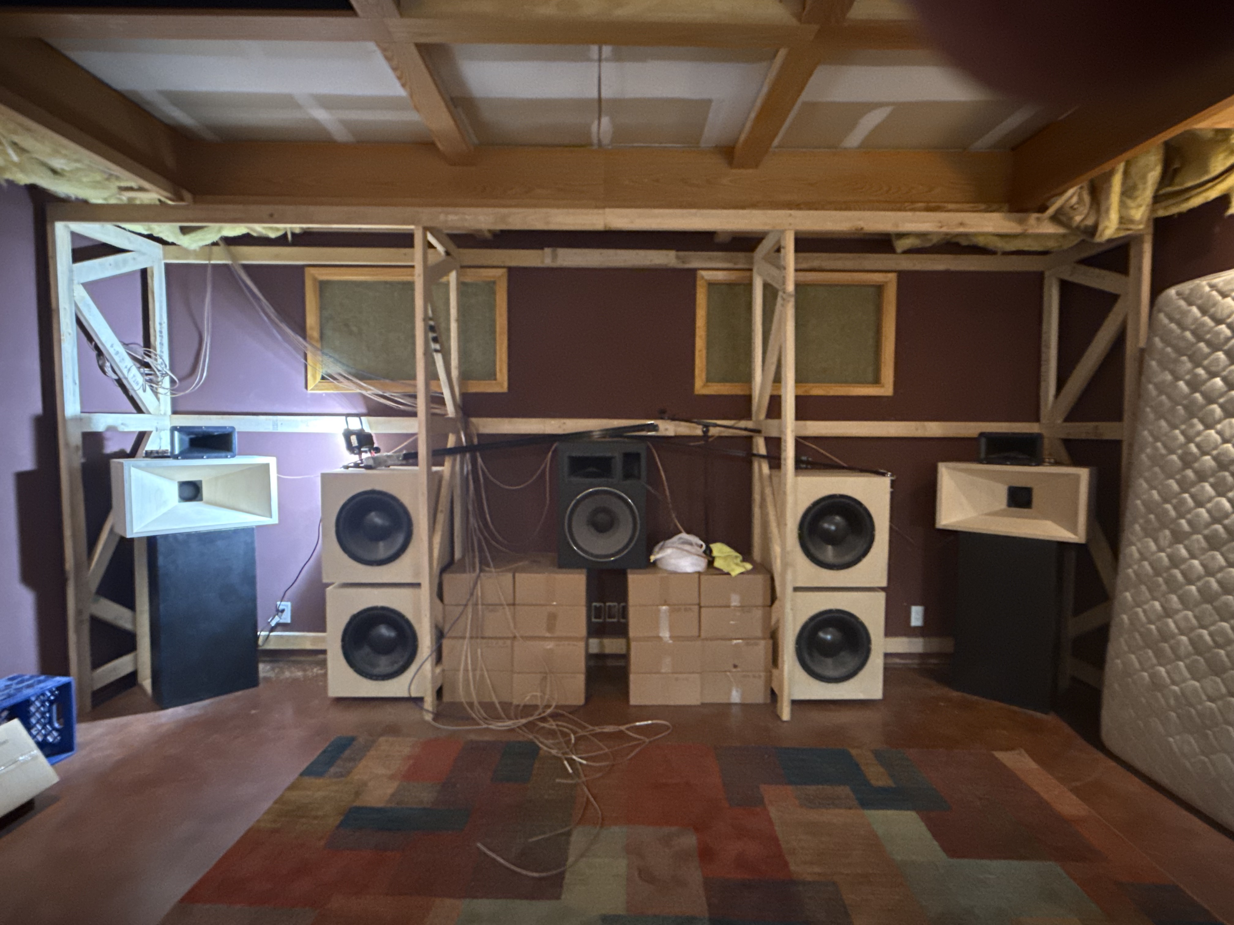

Here's a shot of the room with the speakers installed.
/forum/index.php?t=getfile&id=3584&private=0

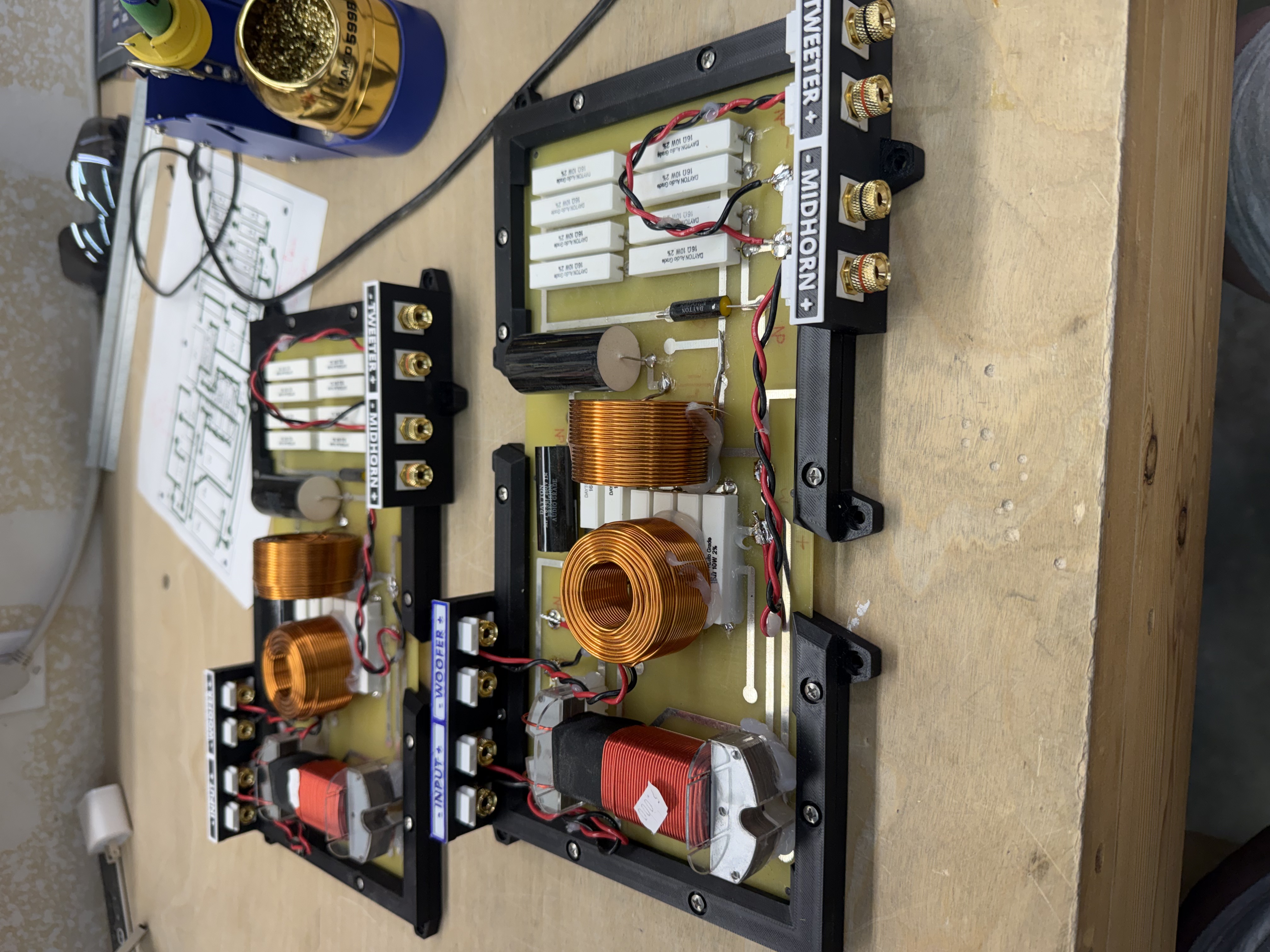

I had an error on one of the crossover boards that killed the output from the tweeter (see if you can spot it!).  Once I got that sorted out I got to really hear these speakers for the first time.
I rate them 11 out of 10.  They exceed my expectations by a mile!  I started out using the Dolby Surround Upmixer which engaged the 4pi center.  I switched to stereo and killed off all the processing in the receiver for the rest of my listening to date.

Re: Pete's Home Theater Build [message #99376 is a reply to message #99374] Mon, 27 April 2026 10:31 Go to previous messageGo to next message
That is one fantastic setup you have there!  Looks great!
I really don't see your crossover mistake.  I can't see all the component connections, but it appears L1, C2 and C3 and the R1/R2 bank are all installed right.  I see you've installed C1 instead of Rs, so that gives a little more sparkle up top.  But nothing I can see would kill the tweeter.  What was it?
That board is tough to populate for the seven Pi's.  Stuff is everywhere.
Re: Pete's Home Theater Build [message #99378 is a reply to message #99376] Mon, 27 April 2026 10:42 Go to previous messageGo to next message
Messages: 77
Registered: June 2011
Location: Albuquerque, NM USA
Look at the upper XO in the pic above.  C3 is shorted to ground instead of passing through L1.  I found the mistake with a bit of sleuthing and the fix was easy.  Luckily I used the silicone in moderation when I assembled the crossovers.
Re: Pete's Home Theater Build [message #99379 is a reply to message #99378] Mon, 27 April 2026 15:29 Go to previous messageGo to next message
Ah-HA!  Good eye!
And - yes - I see it now.  There are two crossovers in your uploaded image labeled IMG_1668.JPEG.  The one in the foreground is correct, but the one in the background is wrong, just like you said.  It's kind of blurry in the photo, cause the camera is focused on the crossover in the foreground.  But you can see the bad connection.
If you click on the image link below the photo in the post, and then click on the pic when it's displayed, it will zoom in and you can really see it.
