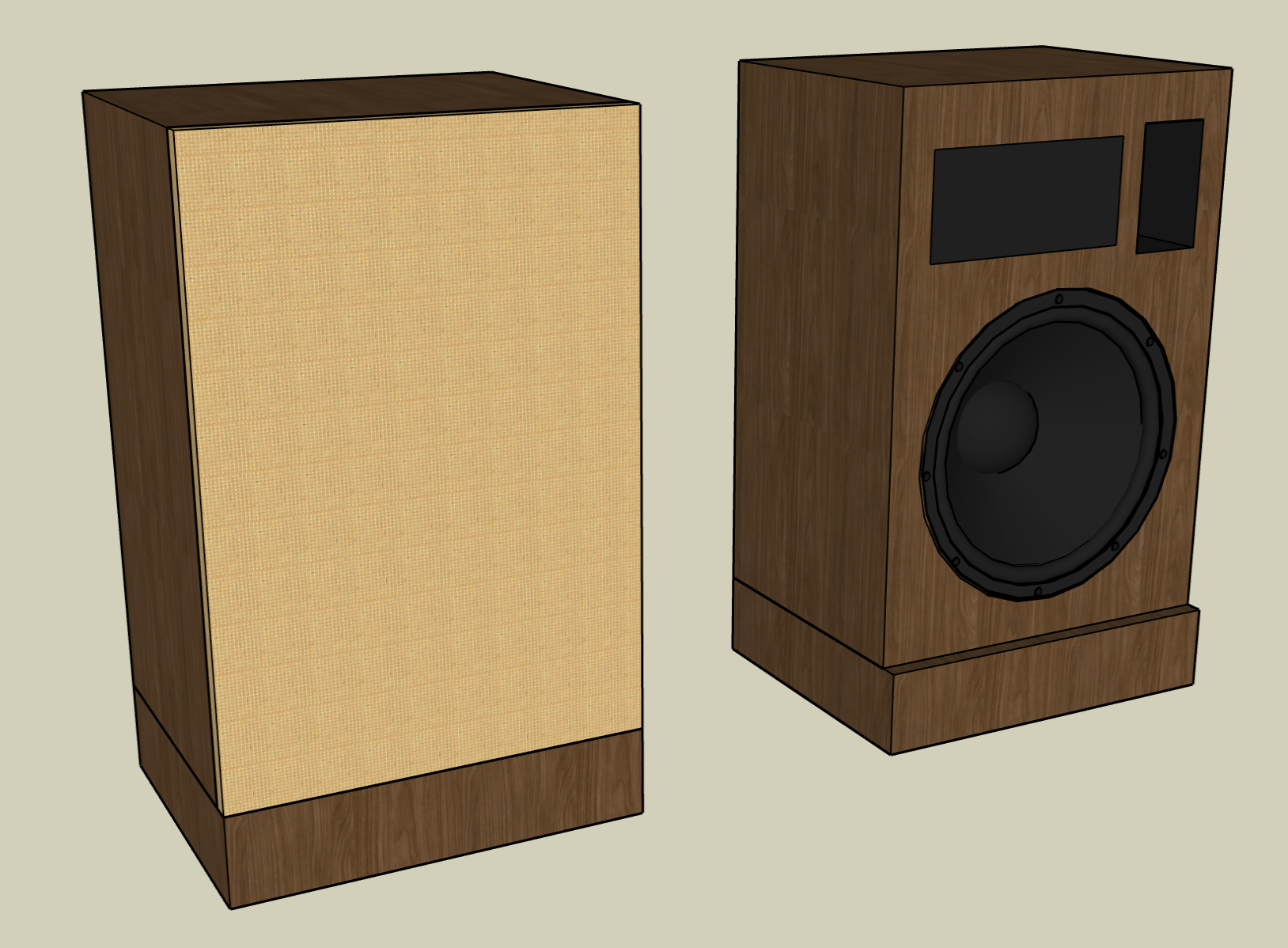

I had some nice tweed grille cloth and these speakers being very, well, boxy, it seemed like a good reason to lean into the 'vintage monkey coffin' look. I mocked them up in sketchup, adding a 4" plinth that looked proportional.
I have a teenage boy who likes to use my listening room, and while he is pretty careful, his friends are likely to put a hole in my very expensive JBL woofers. So, removable grilles are mandatory.
I'd actually like to raise the speakers a bit higher to get them closer to ear level. The plinth might grow to 10-12", but it starts to look pretty chunky. In that case maybe a hardwood stand is more appropriate.

I love that!  Looks great!

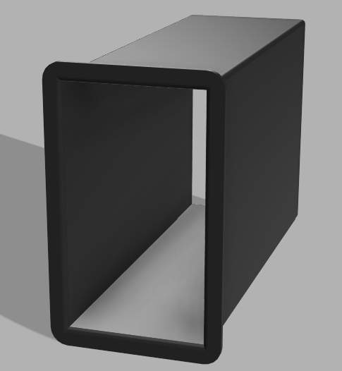

/forum/index.php?t=getfile&id=3568&private=0
I modeled this port to be 3D printed in PLA. Wall thickness is only 1/8", I'm wondering if the flat walls will resonate? I'd make it thicker but I have limited space on the baffle after adding the flange at the face.

I'd have one printed and then test it for bell modes.  If it rings or buzzes, maybe you can damp it with adhesive sheets or something.
Or just make it from wood if the plastic duct becomes too much trouble.

I'd stick with plywood/MDF for the port.  It's nice and solid and is easy to incorporate into a horizontal brace.

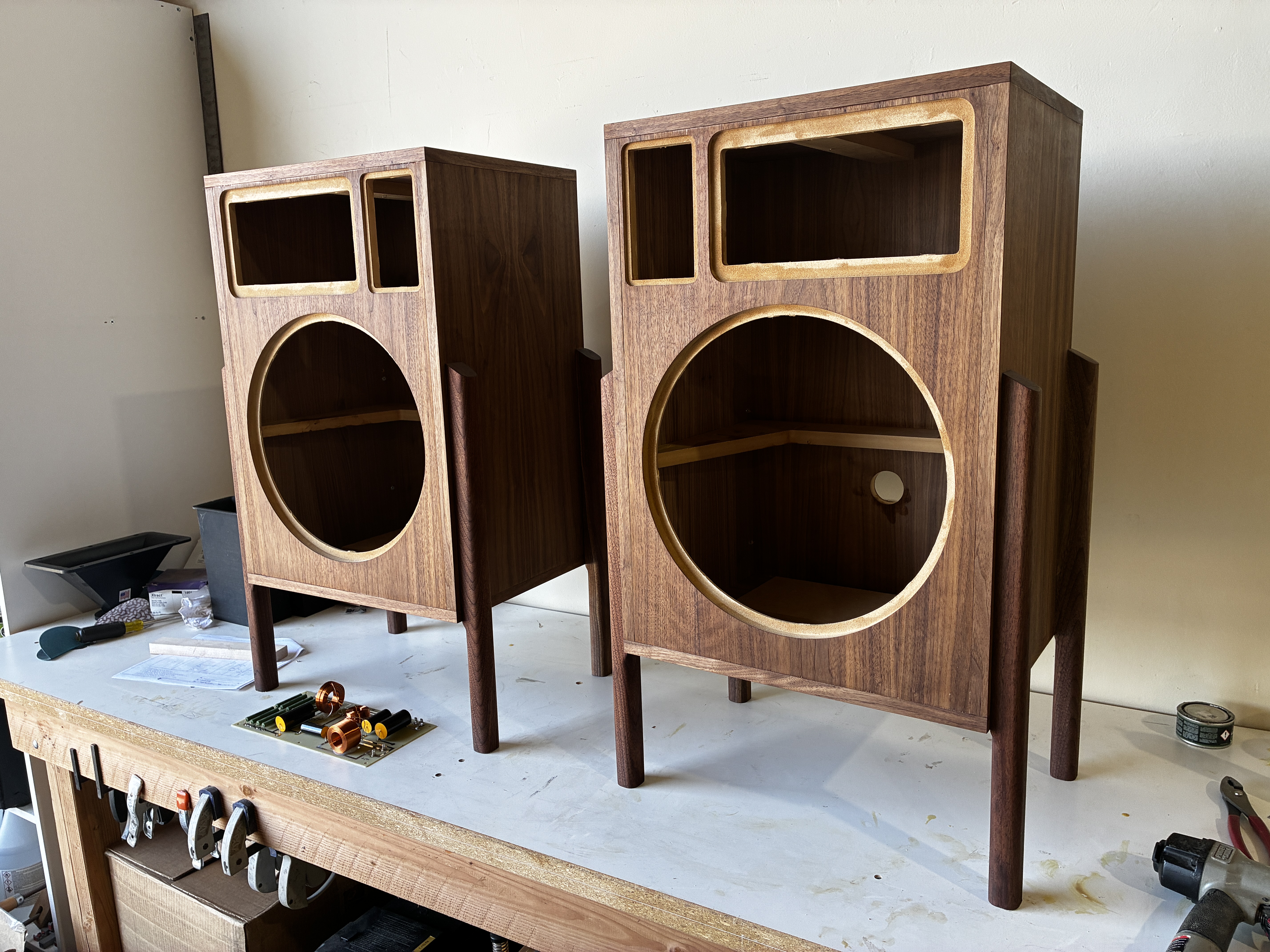

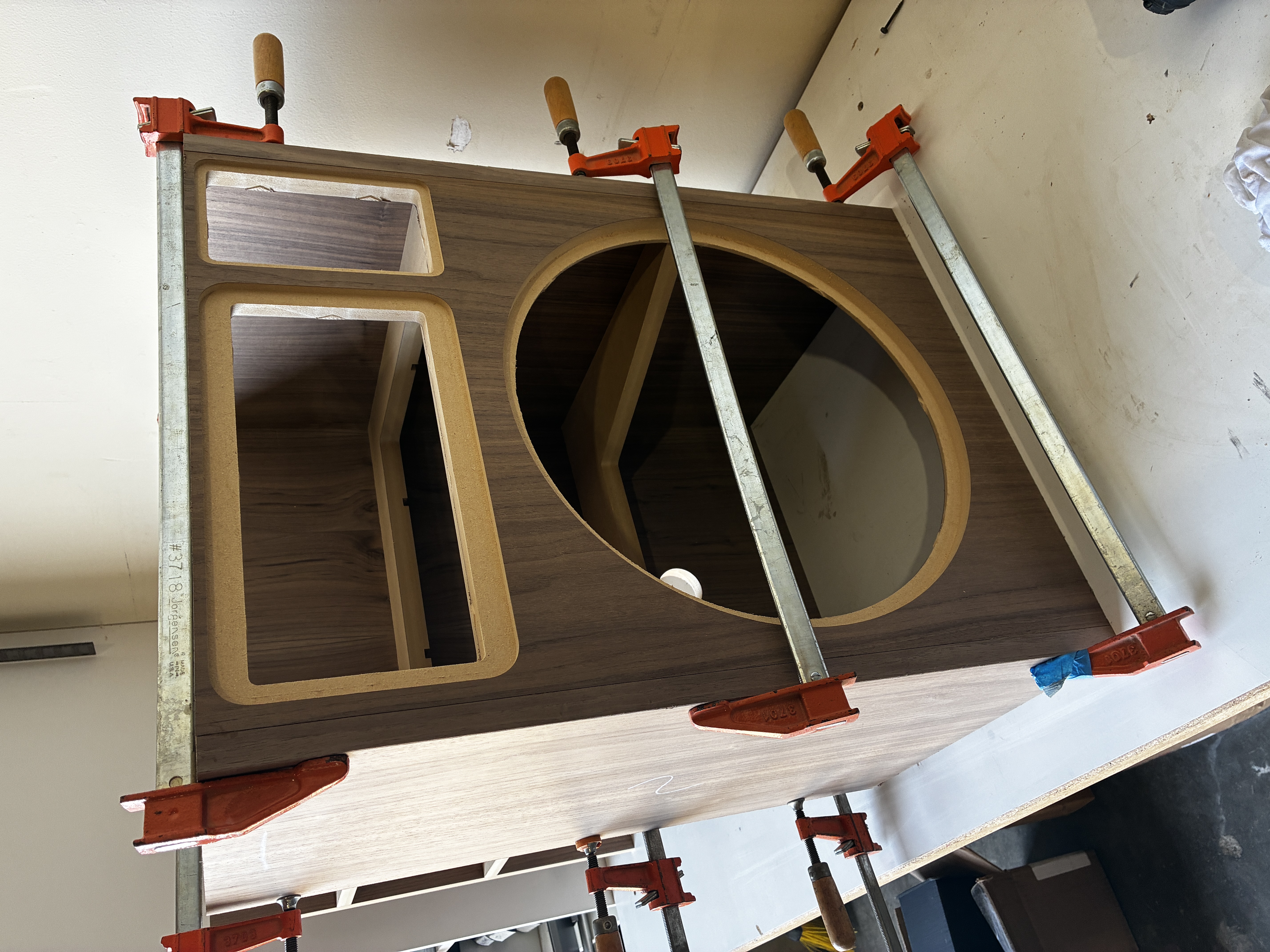

Re: 4pi: Cabinetmaker's build [message #99476 is a reply to message #99291] Wed, 03 June 2026 23:01 Go to previous messageGo to next message
dustboy is currently offline  dustboy
Messages: 16
Registered: March 2026

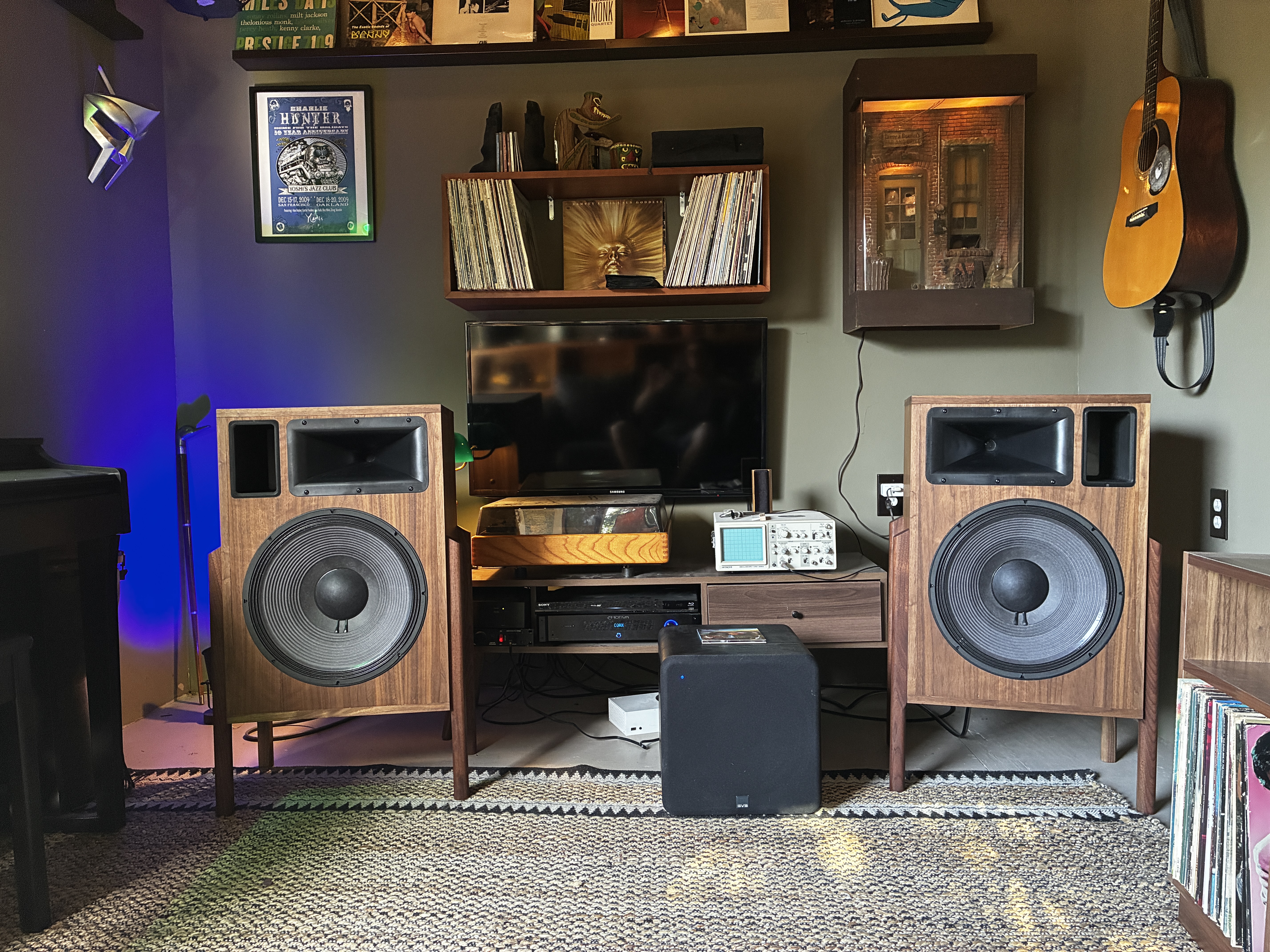

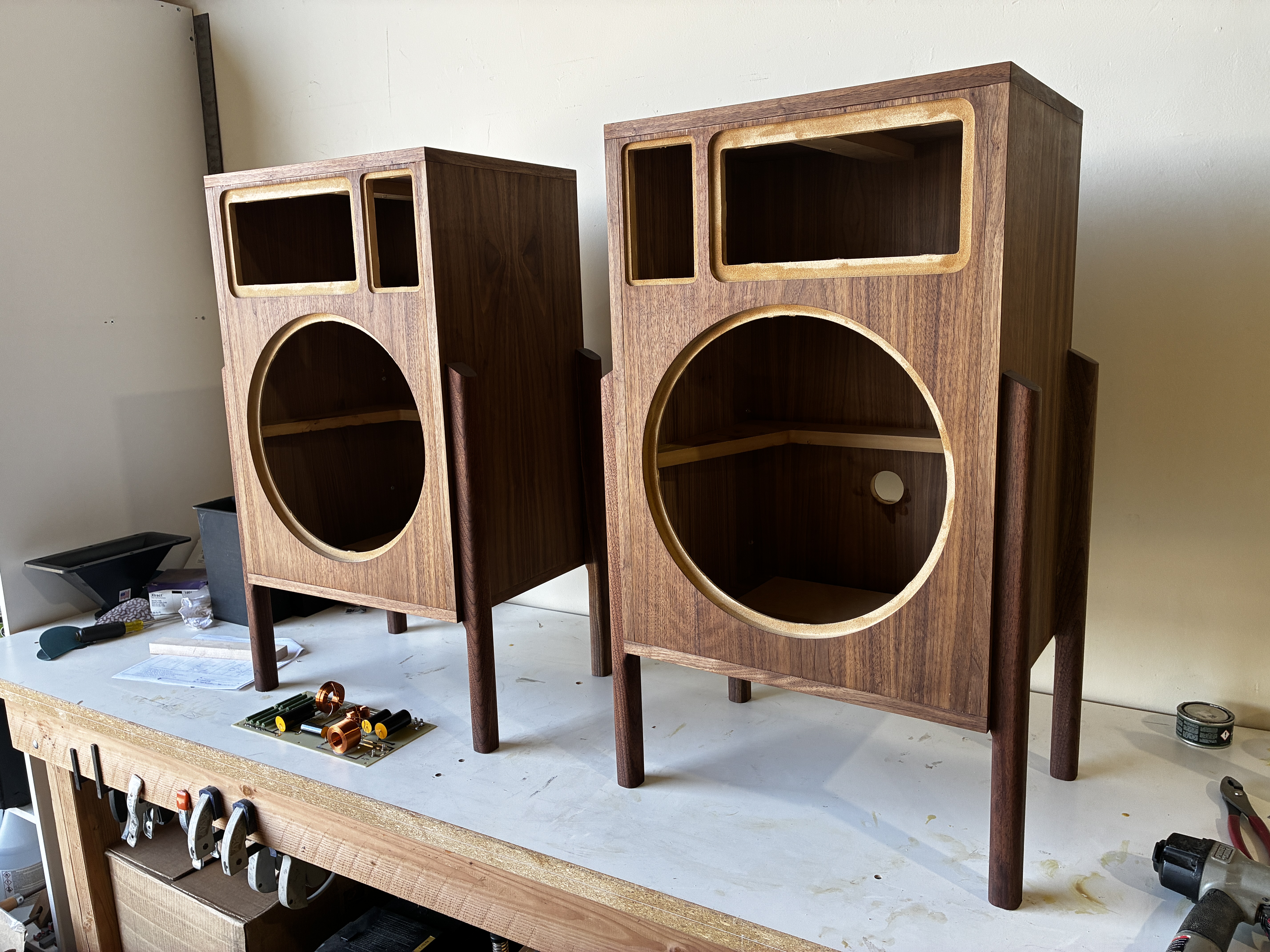

Speakers are built! I wanted to raise the tweeters closer to ear level so I added legs in sort of a mid-century style. They sound good, but not yet great. The dynamics and impact that I was looking for are definitely there, and they are far more efficient than my former speakers. Bass is punchy but also slightly muddy, and some vocals (especially female) don't sound as clear as I would like. Listening fatigue comes on pretty quickly.
EDIT: While writing this, I had the amp cranked up probably 82+ dB range. Turned it down more in the 68-75 dB range, and they sound noticeably cleaner. Amp is only 50 WPC but it should only be pushing a few watts at these SPLs.
Not visible in the photos is a 1 1/4" x 3/4" MDF rib glued to the top, and a 6"x12" MDF pad glued to the bottom as a platform for the crossover. I used poly batting around the tweeter section and after first audition I also added (4) 12"x12" acoustic foam tiles around each woofer. This made a clear improvement but maybe it needs more damping?
Of course I need to do some experimentation with placement in the room. The ceiling has foam acoustic tiles and the floor has a thick jute rug.
/forum/index.php?t=getfile&id=3590&private=0
/forum/index.php?t=getfile&id=3589&private=0
/forum/index.php?t=getfile&id=3588&private=0
Re: 4pi: Cabinetmaker's build [message #99477 is a reply to message #99476] Thu, 04 June 2026 08:54 Go to previous messageGo to next message
Those look fantastic!  I love 'em!
Mine are always on foot-tall stands, so I'm with you on the height.
I am more than surprised with your comments about muddy bass and unclear vocals though.  The four Pi model loudspeaker with JBL 2226H is my reference standard for crisp, clear bass and vocals.  I don't think any other loudspeaker performs as well in that regard - If one did, I'd either be back to work redesigning or I'd drop them from the line.
My thoughts for suspects are these, in no particular order:
1.  Is the cone genuine JBL?  Was it purchased brand-new?  If not, confirm response and distortion are as published using acoustic measurements.
2.  Amplifier performance.  How is it doing at 1/10th-watt levels?  Most of the time, your speakers will be running under a watt.  Then also check the amplifier in the 1-10 watt range.  See how it reacts when pushed a little bit.
3.  Check your internal wiring.  Having one of the midwoofer drivers connected backwards will make some odd nulls in the midbass and midrange, especially when you're centrally seated.  It will be off everywhere in the room, to tell the truth.  The 2226H is to be connected black to positive, so that's often mistaken.  So check the wiring against the plans.  Tweeters out of phase with midwoofers won't affect the midbass, but that will affect the overtone region a great deal.
4.  Where did you place your insulation?  Did you add the sheet spanning the cross-section, between woofer and tweeter?  Did you cover the top, side nearest the port and the rear?  The rear sheet should almost contact the port.  If the sheet spanning the cross-section isn't there, the vocal range will be adversely affected.  Actually, missing any of the damping sheets will have an adverse effect, but the cross-section sheet is particularly important.
5.  Have you checked the bell modes of the port?  Your part looks really cool but since I haven't seen it, I'm inclined to want to check it out.  It's probably awesome, but it's an unknown quantity for me.  I know the MDF ports are acoustically neutral.  But I am worried the plastic ports might have a bell mode in the midrange.  Check 'em out, and maybe damp them with putty if needed.
6.  Room acoustics.  Your speakers are pretty tolerant of bad environments, but nothing can help the sound if there are highly resonant structures nearby.  Those can sometimes really muddy midbass and vocals.  An example I've encountered is hardwood floors over crawlspaces.  Sometimes those make a hollow, resonant sound.  But you probably would have already noticed something like that.
While I won't add this to the list of likely suspects, I will say that adding flanking subs will greatly improve the performance of the midbass and midrange.  That's what the flanking subs really address:  They're not just for extension, but more importantly, they reduce baffle step and mitigate SBIR.
But not having flanking subs isn't a deal-breaker for four Pi loudspeakers.  They sound fantastic without 'em.  It's an Nth degree thing.  Flanking subs are definitely worth doing, and you'll notice the improvement.  But it's not like they fix something bad, it's more like going from really good to great.
Re: 4pi: Cabinetmaker's build [message #99481 is a reply to message #99477] Thu, 04 June 2026 15:52 Go to previous messageGo to previous message
Messages: 16
Well, I got the woofer polarity incorrect, and I was excited that it would be an easy fix, but I read the schematic notes again, and the DE250 tweeter is also Black to +. So they're both wrong, which makes them right...
1. I purchased the JBL's new from Parts Express.
2. Not sure yet about this one, will need to connect the scope to check power output. The amp was working great with my much less efficient Zaph 5.2's
3. See above...
4. Insulation is on the brace between woofer and tweeter. Plus more lining the interior. Maybe it's insufficient? I have always added extra insulation to every speaker I've ever built during the tuning phase.
5. The port needs to be addressed. It was a fun idea but it's probably ringing a bit.
6. The room is pretty well treated. It was sounding great with my old speakers.
I do have a 12" sub which does enhance the sound significantly.
I have no doubt these speakers are capable of exceeding my expectations, just need a bit of tweaking to get there.
