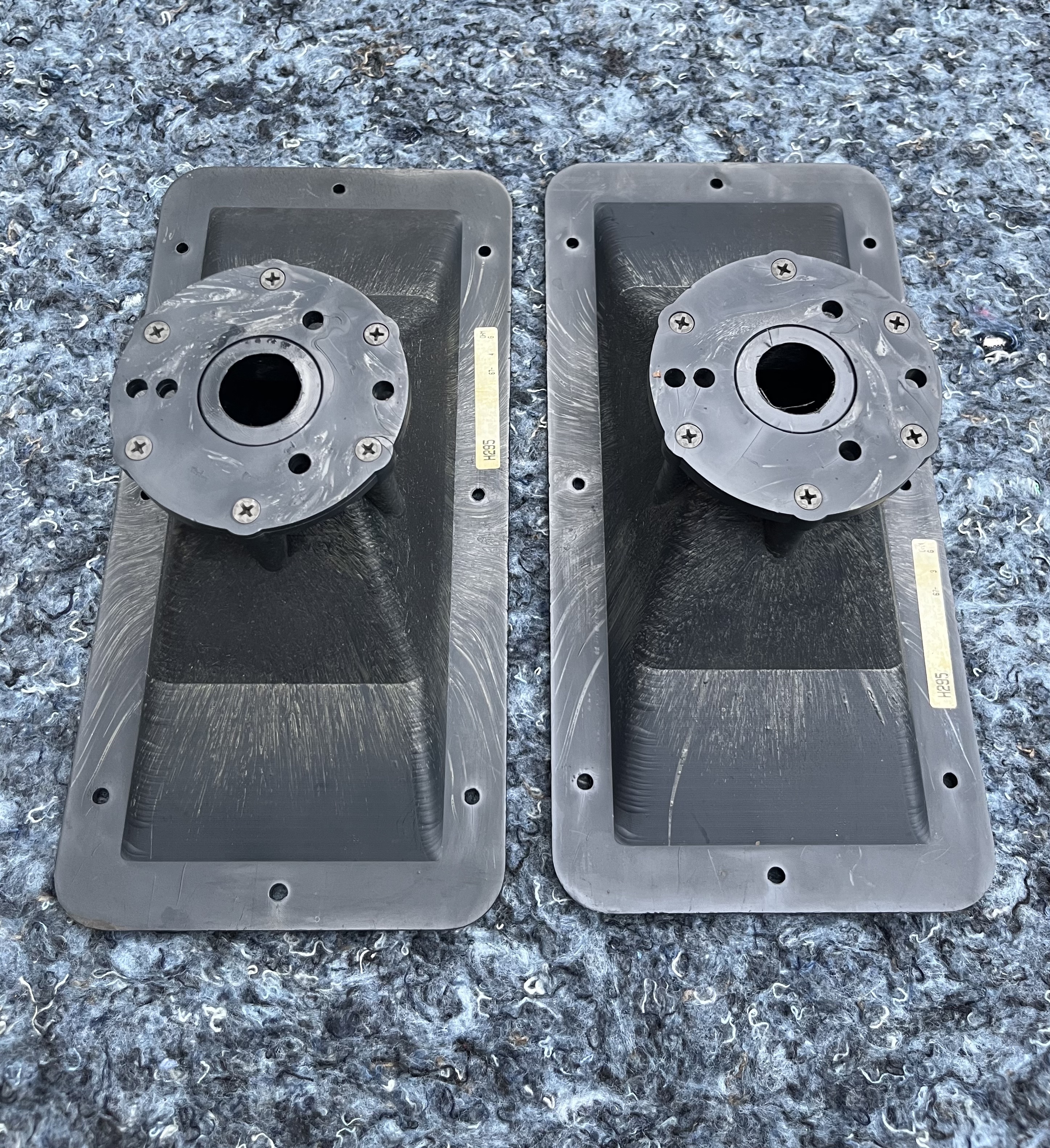

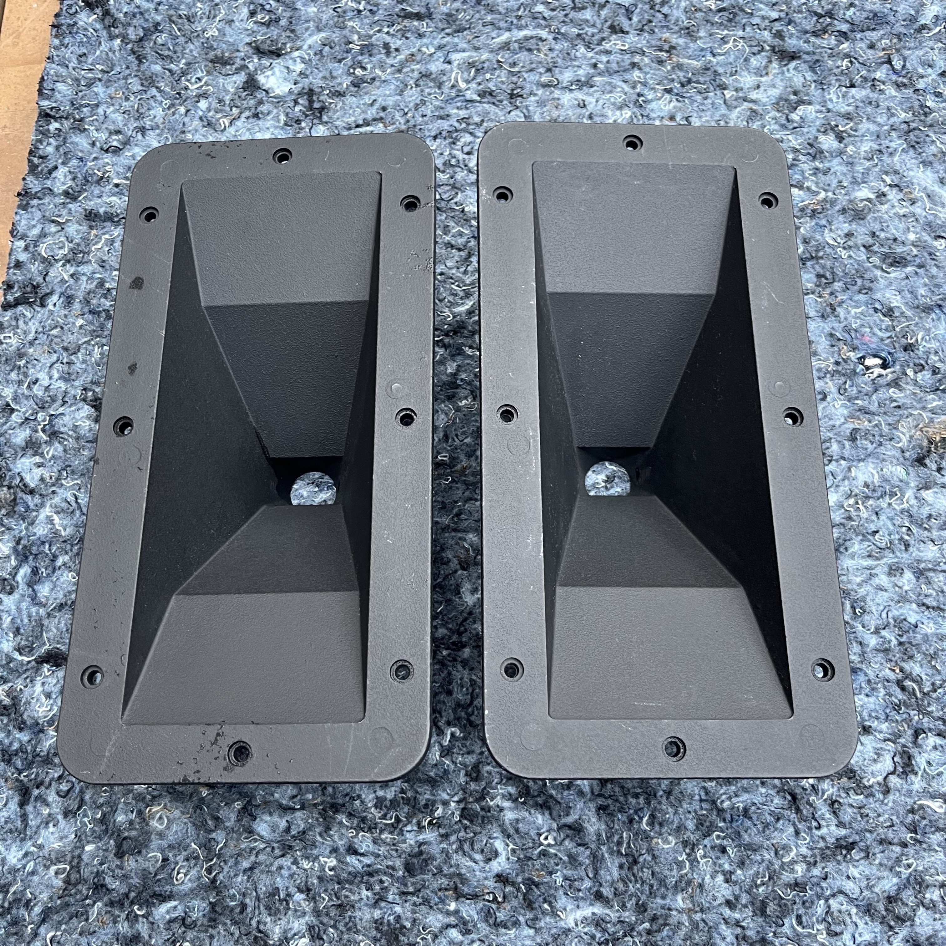

- Pair of Eminence H295 waveguides (bolt-on)

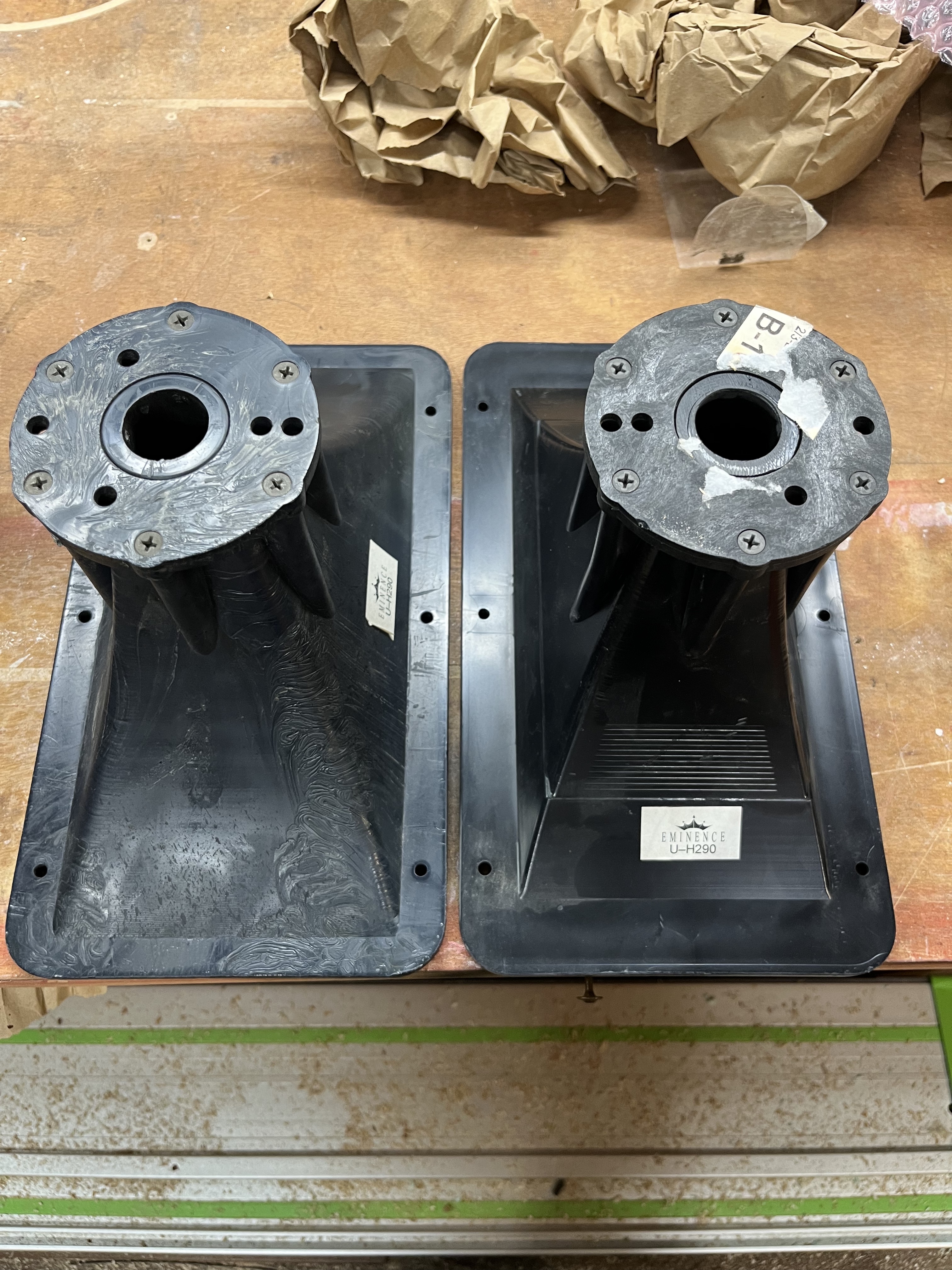

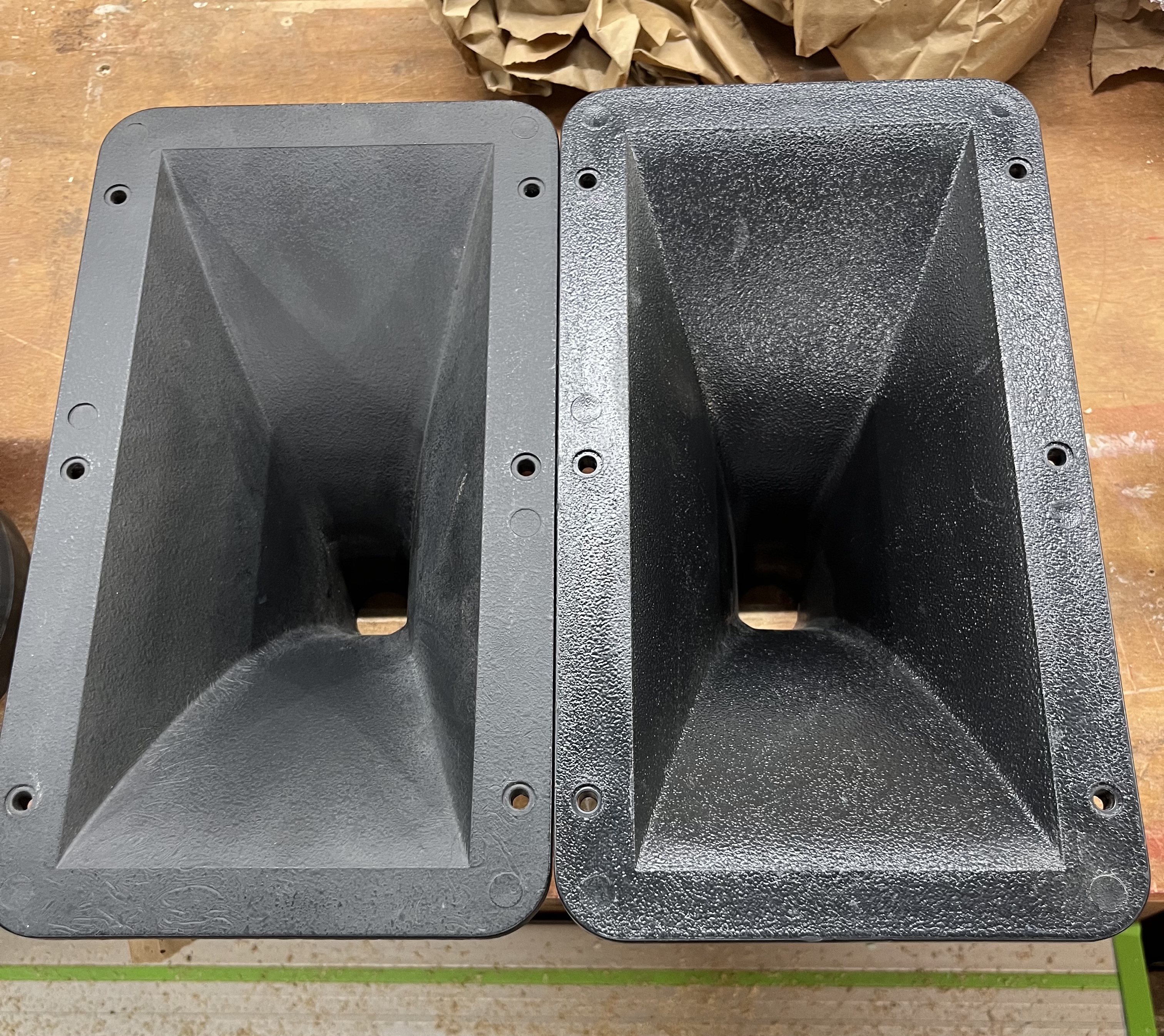

- 2 Eminence H290 waveguides that seem mismatched and from different production runs... One is heavy and one is light... you can see from the pics that they are different. It would send my OCD through the roof to try and make these into a pair... so maybe somebody needs an older one to match an orphan?

Eminence H290:
/forum/index.php?t=getfile&id=3462&private=0
/forum/index.php?t=getfile&id=3463&private=0
Eminence H295:
/forum/index.php?t=getfile&id=3464&private=0
/forum/index.php?t=getfile&id=3465&private=0
  • Attachment: EM-H290.jpg
    (Size: 3.18MB, Downloaded 831 times)
  • Attachment: IMG_2091.jpg
    (Size: 4.12MB, Downloaded 847 times)
  • Attachment: EM-h295a.jpg
    (Size: 3.58MB, Downloaded 846 times)
  • Attachment: EM-H295b.jpg
    (Size: 3.62MB, Downloaded 853 times)

Cool old horns!
I have some of the old Eminence H290 horns too. They were a radial horn, and they sounded really good, in my opinion. They offered good spectral balance and fairly good horizontal dispersion.
That's why I used that particular horn in a lot of speakers. It wasn't a constant-directivity horn, but it did provide fairly uniform coverage along the horizontal plane. And it was much smoother than a horn of the time designed for constant directivity.
That's what the Eminence H295 horn is - a constant directivity horn. The coverage is more uniform, but there's a price for that. It's pretty harsh sounding. That's the drawback of that horn and all the other CD horns of that era - they were harsh and "spitty" sounding. Cymbals sounded like they had been run through a phase shifter - 'cause they had been. The acoustic version of a phase shifter, which is the diffraction slots and edges within the throat and body of the horn.
The horns we sometimes call "waveguides" are an answer to that. They offer the smoothness of a radial horn with the coverage uniformity of a constant-directivity horn. In fact, a well designed "waveguide/horn" can do better in both regards. That's what the Pi Speaker's H290C waveguide/horn is:
