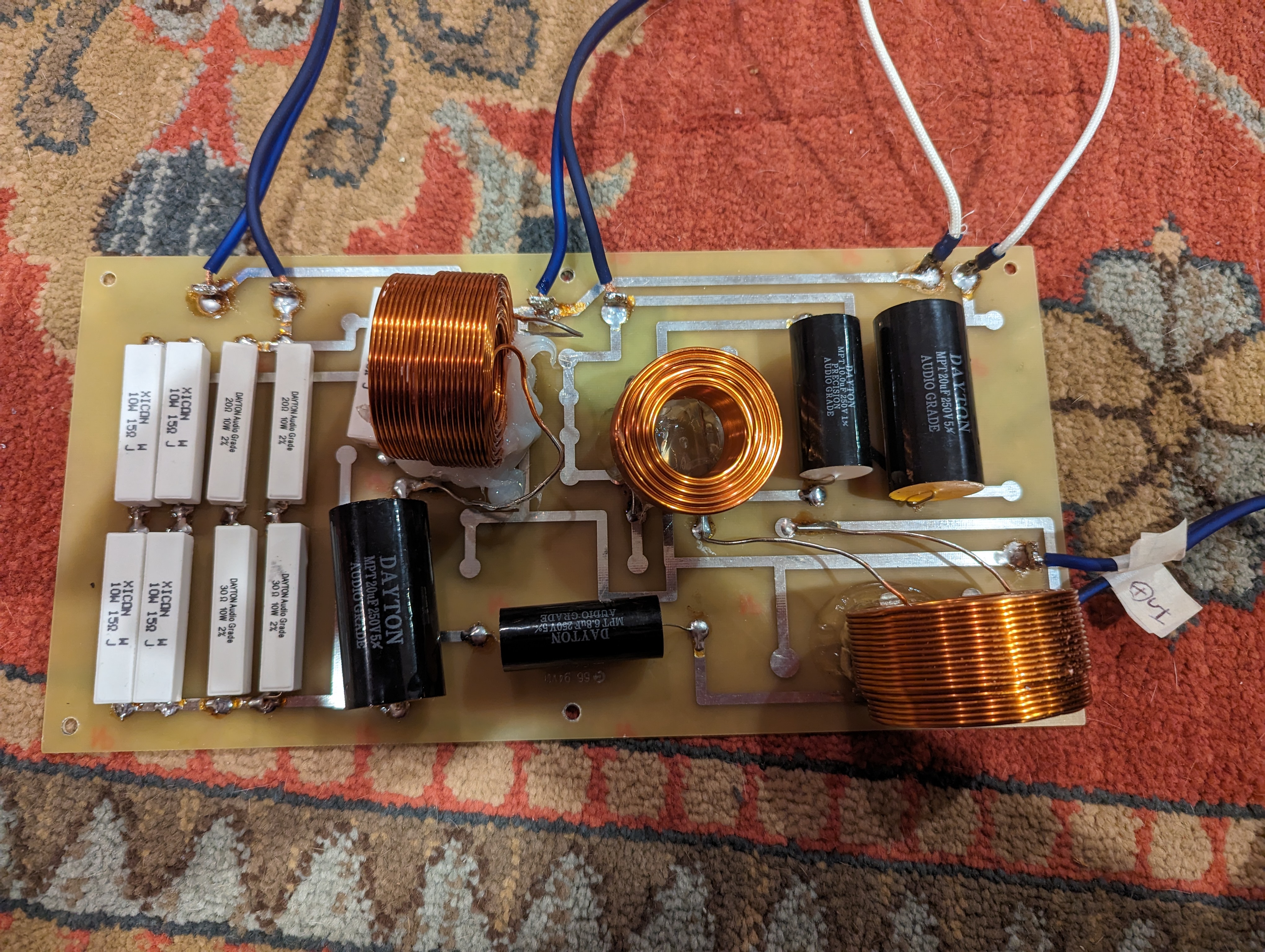

But I have another problem. One crossover has no output to the woofer. All the solder connections look okay to my eyeball. Do you have any suggestions on how to track down the problem? It is the crossover board where the inductor had become dislodged in shipping.

As for the crossover, I think possibly one of the wires that connects the coil to the board is touching a land that it shouldn't. If it became dislodged, then it's possible that happened during re-attachment.
Can you take a photo of the crossover and send it to me via email or post it here on this thread?

It took me awhile to take the speaker apart. Here is a photo of the crossover from the top. Let me know what other view might be helpful.

I don't see anything obvious, so I'll bet the problem is underneath a coil. That's the most common problem - they shift during shipping. I allow them to cure for a couple weeks, but I should probably let 'em cure longer.
Lift the middle coil, pulling it free, and see if that doesn't solve the problem. It may have shifted and one of its leads may be touching a PCB trace. If that does it, reattach with silicon adhesive.
If that doesn't do it, send it back to me. I'll fix it and get it back to you while your dust caps are being repaired.

Update: We took this discussion offline and it turned out that it was, in fact, L3, the middle coil. The board took a hit during shipping, which had knocked loose coil L1, the one shown on the right in the photo above. Daniel re-attached it with silicon adhesive, as you can see in the photo. But it turned out that L3 had also shifted. Daniel lifted it and re-attached with silicon and he's back in business.
