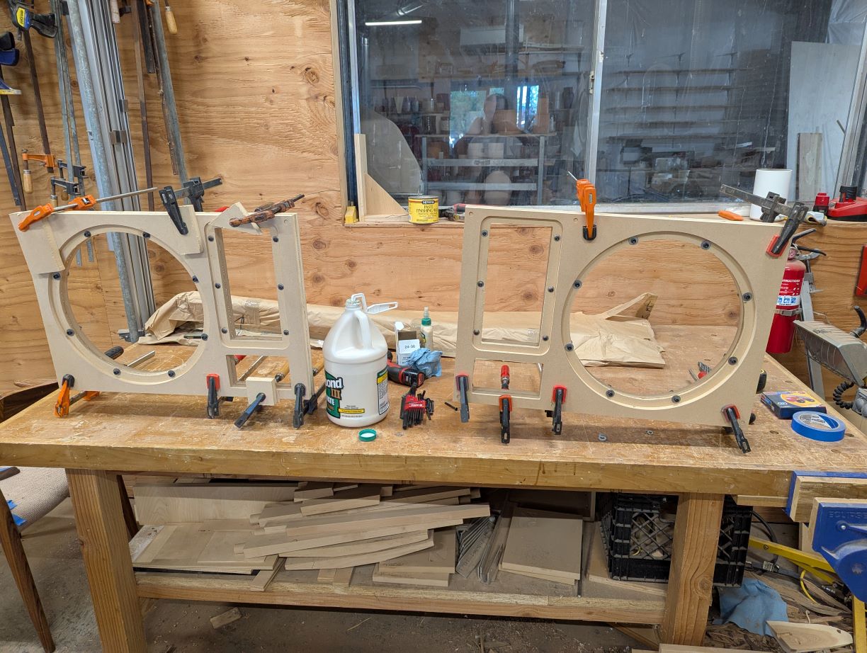

After taking a break from this project for nearly two years (life, eh?) I decided it's time to get back into it.
The next order of business is to build up the boxes.  The design I settled on reflects that of the original, but with a front lip to accommodate a removable grill cloth, and some additional bracing.  Since I would be using my CNC I implemented several slots and reliefs to aide in panel alignment during glue-up.

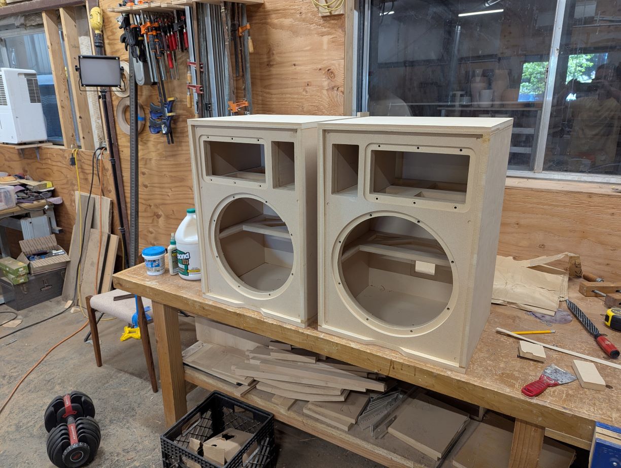

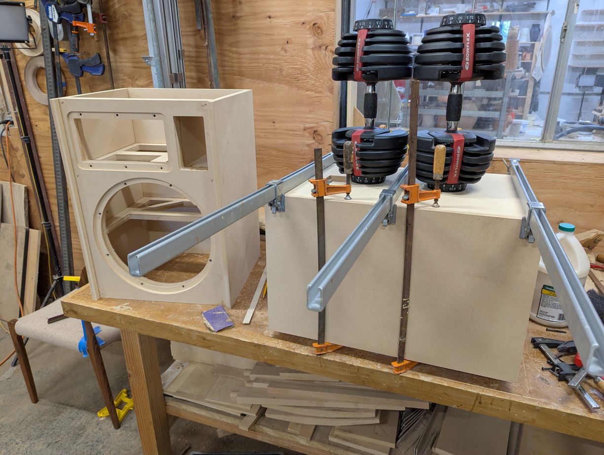

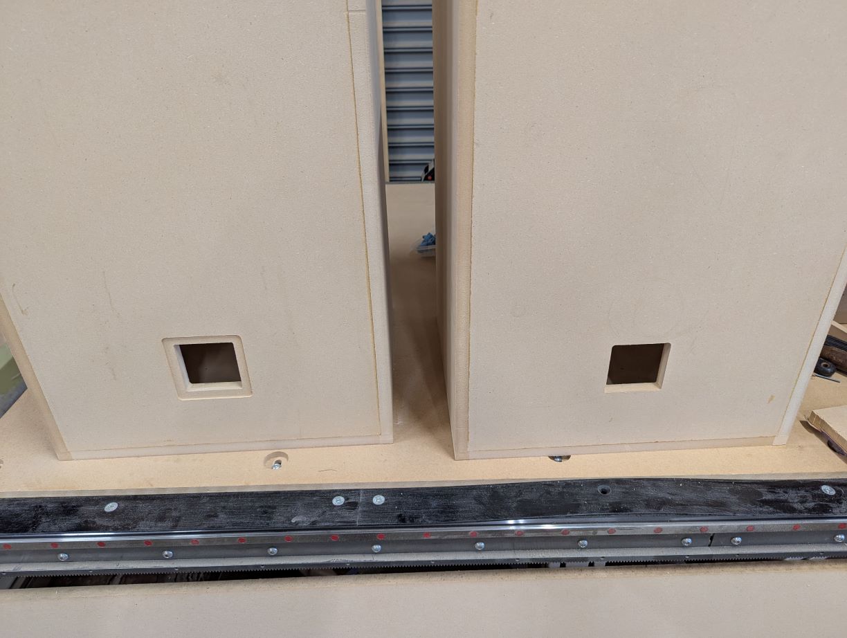

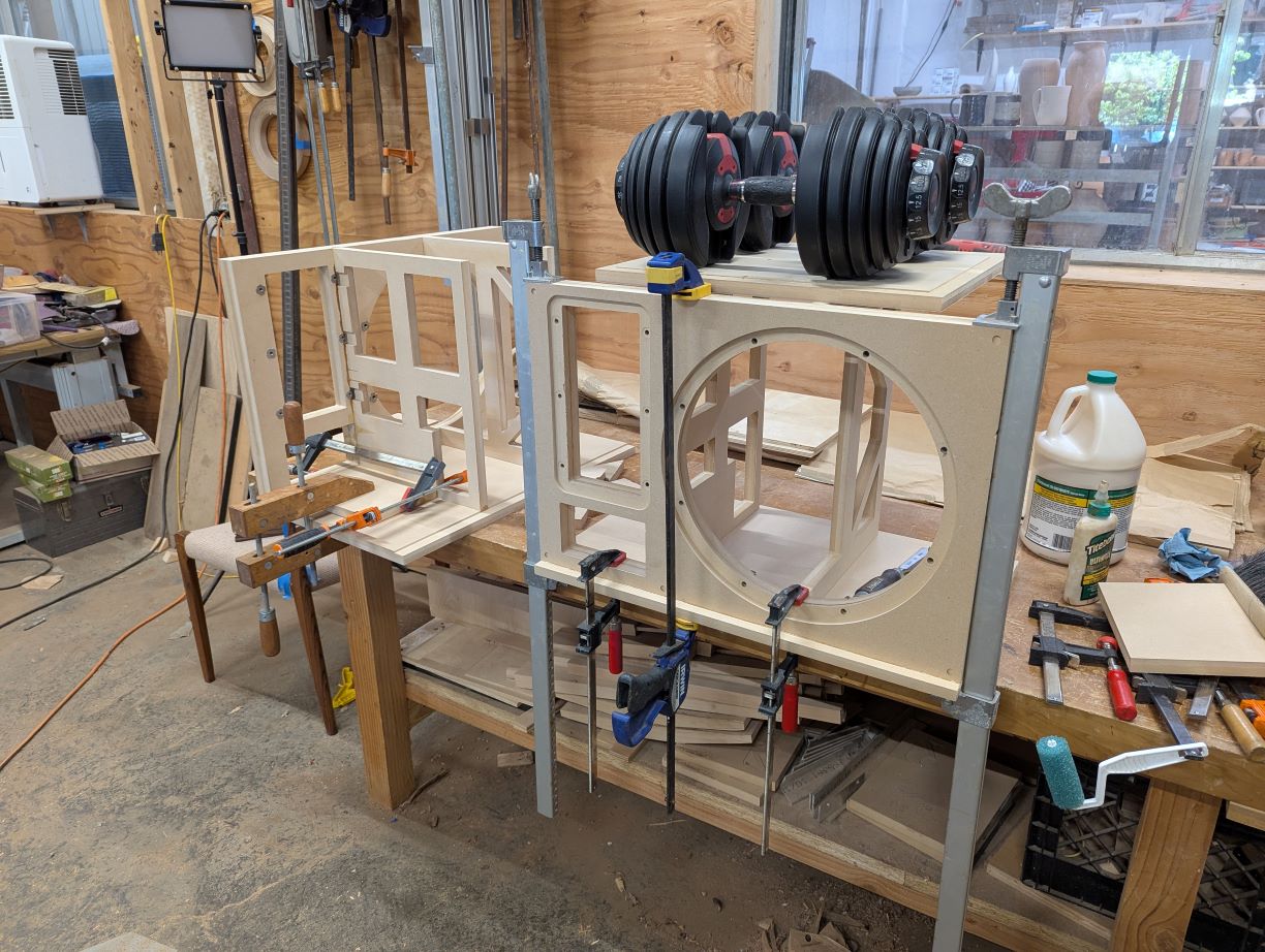

Re: My 4 Pi Build [message #98748 is a reply to message #96988] Thu, 03 July 2025 16:54 Go to previous messageGo to next message
Messages: 20
Registered: September 2023
Enclosures getting glued up...
I realized too late that the CNC table wasn't as flat as I thought it was, which caused the depths of the dados to vary by up to +/- 0.1".  It took a fair bit of touchup on the router table to get everything to fit correctly.
/forum/index.php?t=getfile&id=3516&private=0
/forum/index.php?t=getfile&id=3515&private=0
/forum/index.php?t=getfile&id=3514&private=0
/forum/index.php?t=getfile&id=3512&private=0
Oh yeah, I was a dingbat and installed the back panel inside-out on one cabinet and didn't notice until today.  D'oh!  I'll have to route the recess for the terminal plate by hand...

Re: My 4 Pi Build [message #98749 is a reply to message #98748] Thu, 03 July 2025 17:11 Go to previous messageGo to next message
Unity_Coupled wrote on Thu, 03 July 2025 16:54
That's a pretty big variance, nearly 1/8".  But you sure can't tell - your speakers look great!
Re: My 4 Pi Build [message #98751 is a reply to message #98749] Thu, 03 July 2025 23:57 Go to previous messageGo to next message
Messages: 20
Wayne Parham wrote on Thu, 03 July 2025 17:11
Thanks, Wayne-  Roughly half of the panels required rework as stated, and if you examine the enclosures closely it's evident that things are still slightly askew...but it's nothing that can't be mitigated with a dose of flush trimming and some sanding.  At least the joints mate properly and the boxes are air-tight where they need to be.  Overall I'm very pleased with how everything is taking shape.
Funny thing... I was contemplating running a surfacing pass on the mill before starting but ultimately chose to just "send it".  My impatience got the better of me!  I suspect it will strike again as I'm anxious to load in the drivers and crossovers for a listen.
