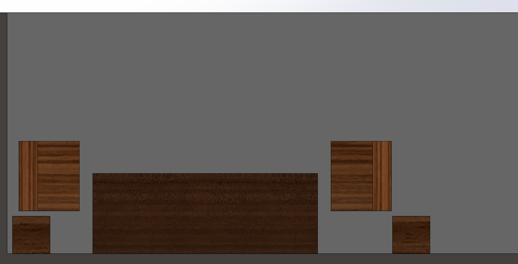

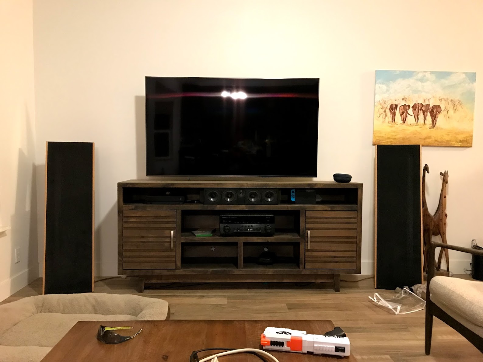

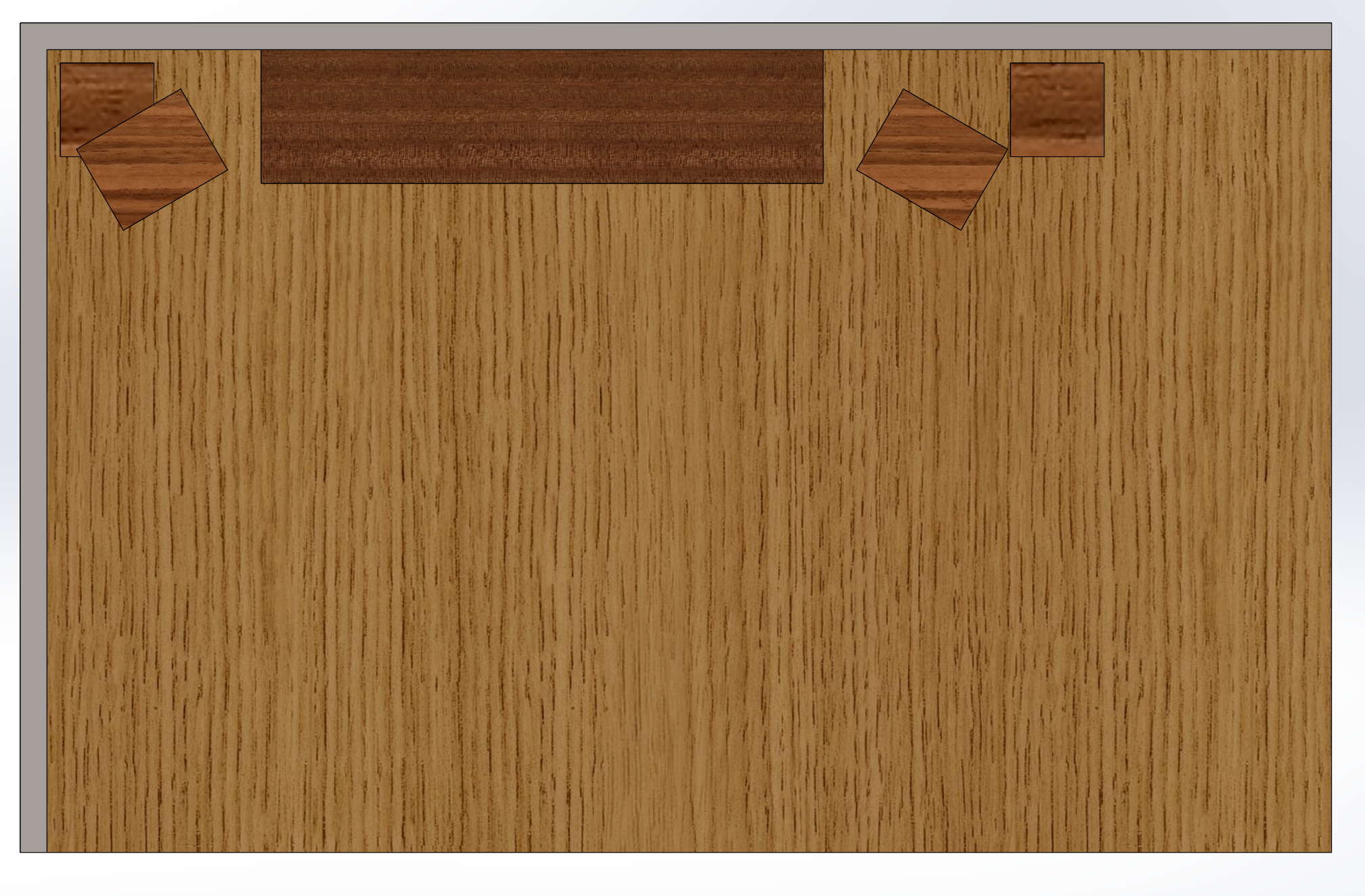

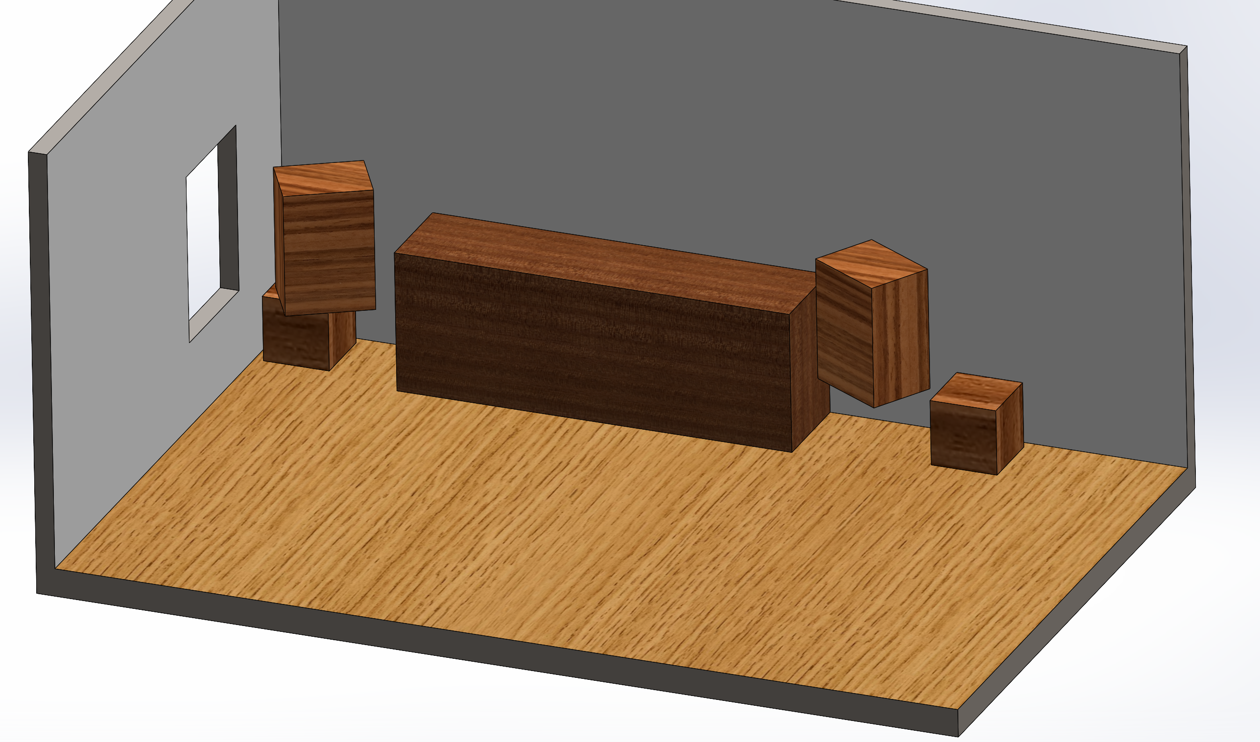

I wanted to get your opinion on the amount of room I have. I modeled up the corner that the left speaker would be stuck in and... it's tight.
The 4pi is correct dimensions. I wasn't sure how big the 3pi sub was, so I made it a 14" cube. Either way, I think I would have to make the sub shallower and taller to fit back there. Let me know what you think! Thanks!
Actual Picture (there is a rug now!)

Iso, front, and top vies
/forum/index.php?t=getfile&id=3309&private=0
/forum/index.php?t=getfile&id=3308&private=0
/forum/index.php?t=getfile&id=3307&private=0

Re: Pi3 vs Pi4 [message #96530 is a reply to message #96528] Fri, 17 March 2023 09:50 Go to previous messageGo to next message
I think that will work but is there any reason you can't move the television console a little bit?
The three Pi subwoofer is a 20" cube, but you can modify dimensions slightly with no ill-effects. Don't make it too long though - we don't want standing waves to develop along the long dimension - and keep the internal volume the same.
