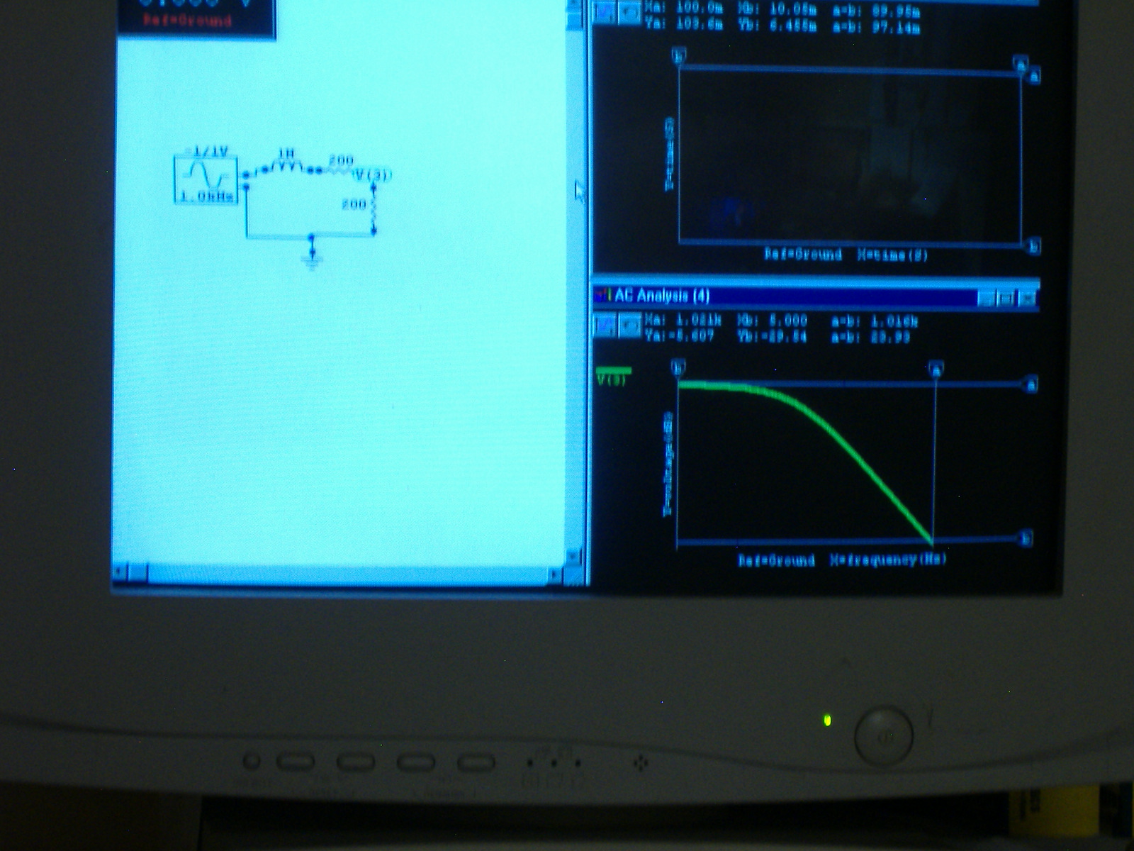

3. Concerning 120hz AC hum, I prefer at least 4 stages of filtering, 5 is even
better. My preamplifier and phono stage have 6 stages. I never use an
inductor anywhere as it causes non-linearities due to
2 factors. (If I did, it would be only in the early stages of filtering.)
A. One is inductance which is frequency sensitive. It would appear as
a straight diagonal line in the circuit below.
B. The other factor is dc resistance, which is not frequency sensitive.
Attached is a simple circuit. The choke/inductor has 200 ohms winding
dc resistance. Notice the curve where dc resistance becomes dominant.
C. Me and another music lover have experimented between choke/inductor and
resistor and the sonic change is quite substantial.
Distortion being defined as the altering of sound in any way.
With speaker crossovers, dc resistance tends to be minimized.
cheers
