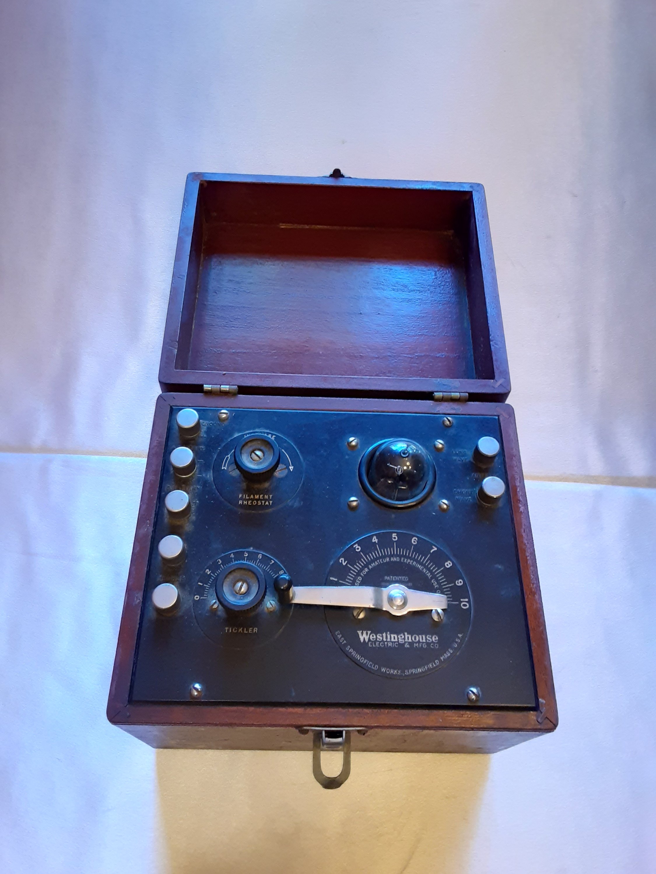

I've been meaning to write about this for weeks, but have been busy and just forgot to create a post.
Look what my wife got me for my birthday:
A 1922 Westinghouse Aeriola radio with the tube intact!
/forum/index.php?t=getfile&id=3280&private=0
1922 Westinghouse Aeriola Radio
It appears to be a regenerative single-triode radio that was designed to use batteries for power and high-impedance headphones for output. The tuning element is inductive rather than capacitive. So it's a hoot!
I have a bunch of tube radios from the late 1930s to the 1950s but this is my first 1920s radio.
I plan to power it with a modern supply and probably drive a modern amplifier. Or I might try to find the partner tube amp. I also think I'll store the original tube and replace it with a substitute. The WD-11 tube designed for this set is rare, delicate and expensive. It's a four-pin triode, with a unique pin layout. They're at least a couple hundred bucks each, and the filament is reportedly delicate. But a quick search of the internet shows me that some people substitute a 5676 tube using a pin-adapter.
