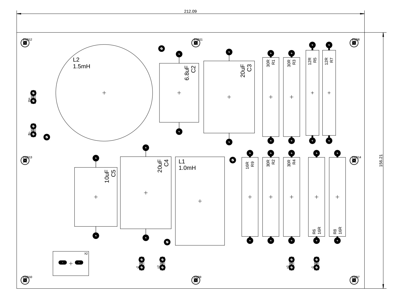

I decided to start with the part that I am most familiar with which is designing the PCBs for the crossovers. They are going to be built with Jantzen Cross-caps, Jantzen 15ga Coils and a mixture of Dayton audio and Mundorf MRs for the resistors. I don't like the idea of surface-mounting through hole components, therefore I am going to mount these regularly and then use a thick EVA sheet to mount them to the cabinet (I am thinking something like a camping mat). I am seeing a whole lot of different versions of 3pi crossovers in the forums, I guess it went through different revisions. This is the version I found on the latest 3pi plans, I just hope I got the values right.
Here is the parts layout, dimensions are in mm. I won't be posting the schematics since I don't know if that's permitted. Connectors are going to be 6.3mm gold plated spade tab terminals for the drivers and the binding posts and there's also going to be a screw terminal for the Zobell resistor. I am a bit worried about coil interference, I spaced them a bit apart and used different orientations to minimize this. I really don't know how much of an issue this will be.

Re: My 3π adventure [message #95261 is a reply to message #95260] Sat, 19 February 2022 10:45 Go to previous messageGo to next message
That layout looks good. The coils appear to be far enough apart and in different planes, so I think your crossover will be excellent!

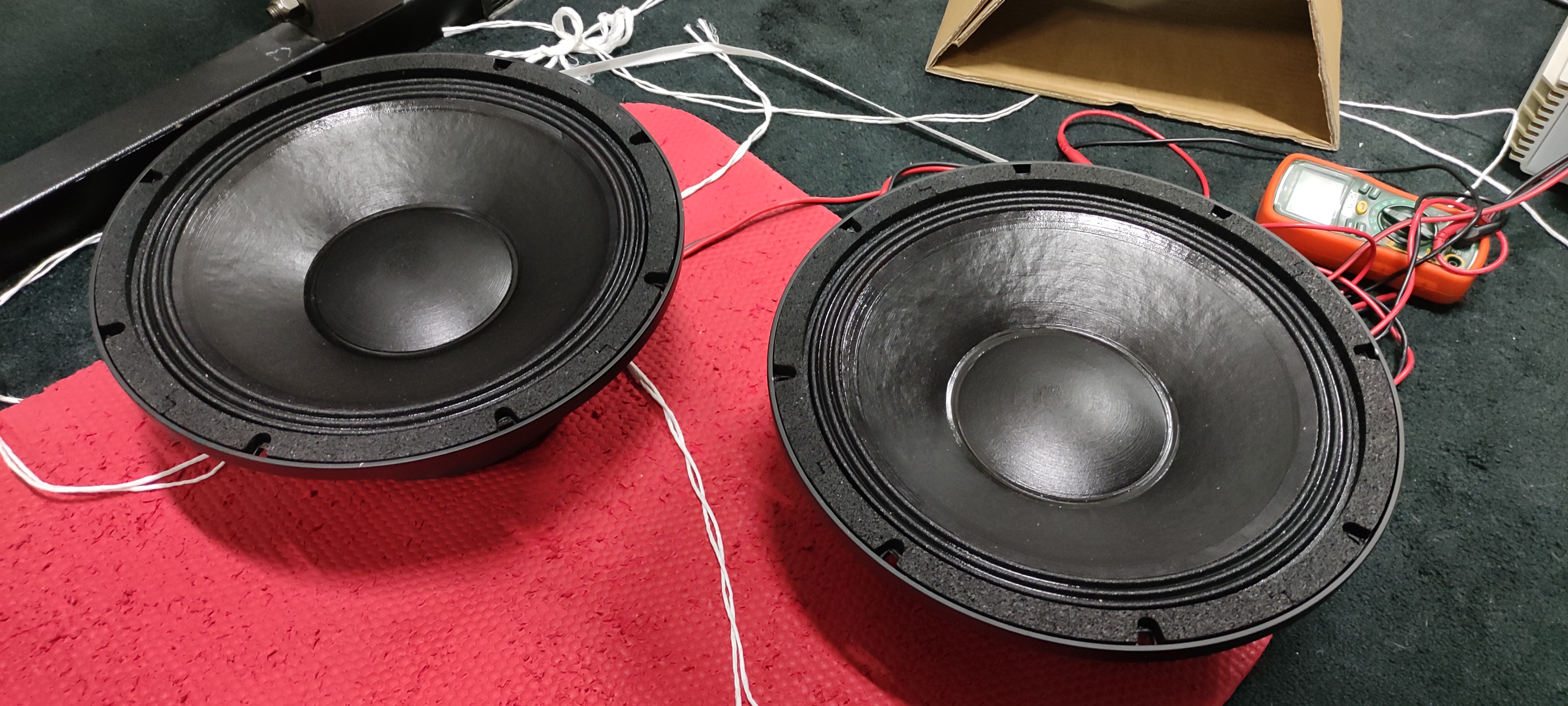

The 12PLB100s are here! Good times!
/forum/index.php?t=getfile&id=3019&private=0
I wired them to do some quick testing with a function generator to see if they work. I even tried some music. This is the first time I am listening to a driver that is not enclosed. I almost burst out laughing, this is what disappointment must sound like.
Re: My 3π adventure [message #95306 is a reply to message #95305] Fri, 25 February 2022 18:52 Go to previous messageGo to next message
So glad you got your drivers! That's awesome!
But - yeah - you gotta get 'em in the boxes or they sound pretty thin.
No box, no bass. Laughing

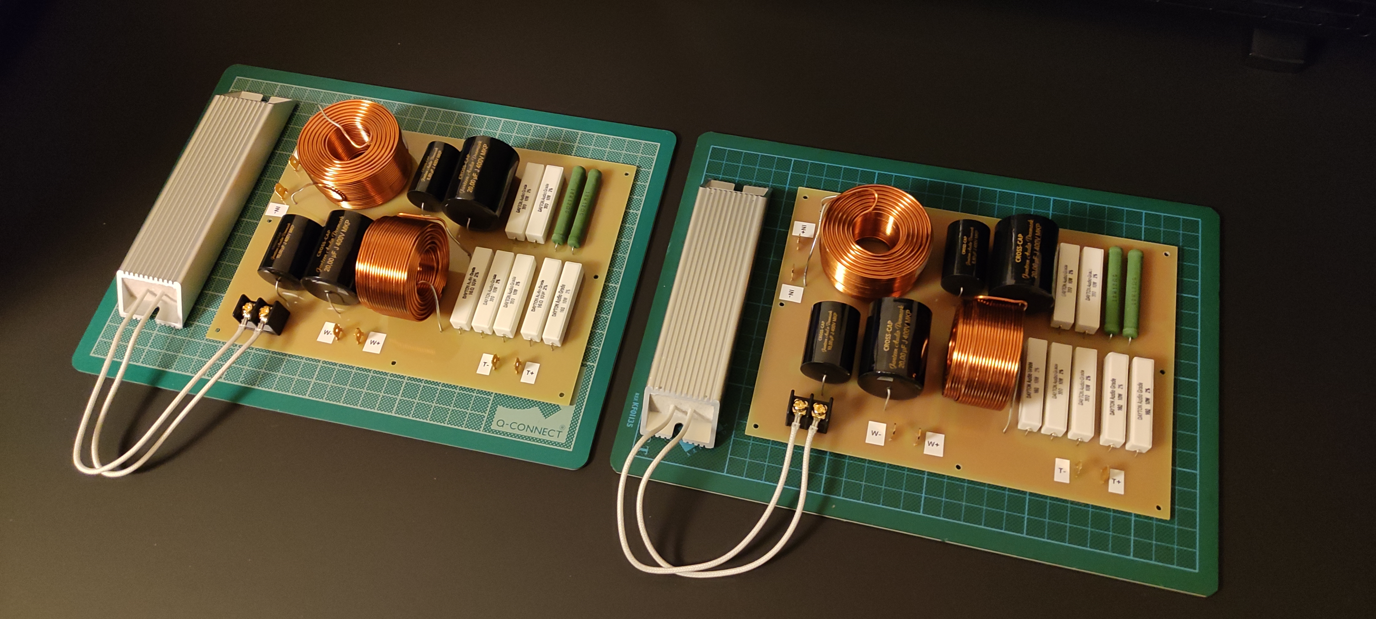

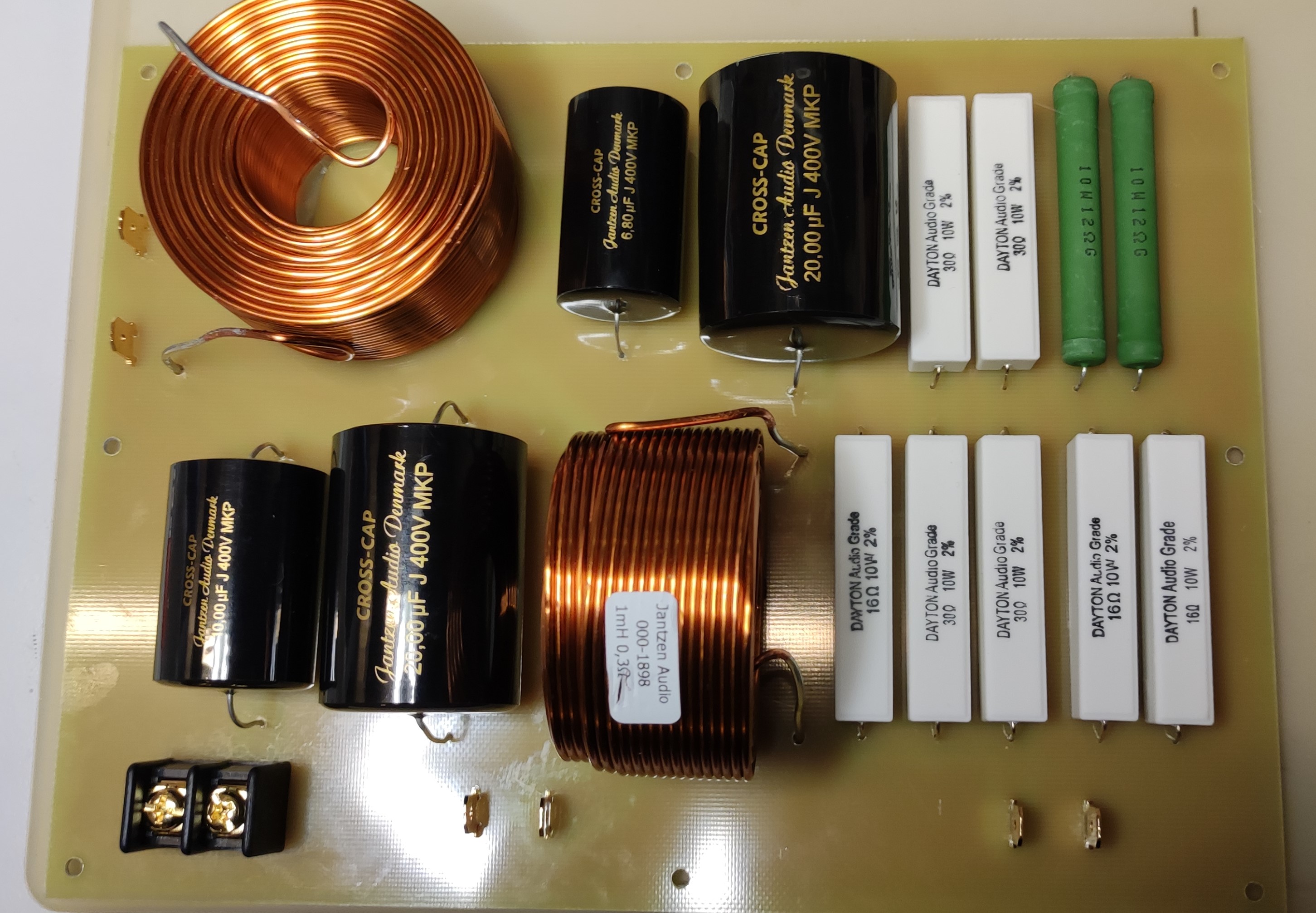

First crossover is done! The second will soon follow.

By the way is there any way to test this with regular lab equipment? I connected a signal generator to an amp and connected it to the main terminals (IN+, IN-) and my scope to the tweeter/woofer terminals. The crossover seems to be working, it is attenuating or reducing the signal around 1Khz. The amplitude on the high frequencies appears to be lower than the lower frequencies but I am guessing that has to do with the load attached to the two groups of terminals (the Zobel was attached during testing). With my multimeter I am getting an open circuit across the IN+ and IN- terminals and exactly the same across 2+ and 2-. Across 1+ and 1- I am getting 12.1Ohms.
Re: My 3π adventure [message #95364 is a reply to message #95362] Thu, 10 March 2022 18:52 Go to previous messageGo to next message
From your description, it sounds like you have everything right. You really need to have the drivers connected - or at least 8Ω dummy loads - or the crossover filter circuits don't work right. The load has a large influence on the transfer function.
But the real test is an acoustic measurement of the assembled loudspeaker.

Both crossovers are now ready. They came out great, they're also aesthetically pleasing. Laughing
/forum/index.php?t=getfile&id=3022&private=0
With my limited knowledge I think they're working as supposed to. I connected 2 x 8Ohm 100W resistors (the regular type) across the woofer and tweeter outputs as a dummy load and did some testing. The function of the two boards is practically identical.
I am still surprised at how much the tweeter signal gets attenuated. I understand that this is to compensate for the difference in loudness between the two drivers. When fed with a 2V sine (P-P) at the crossover point (1KHz) I am getting a 1V sine at the woofer output and a 150mV signal from the tweeter! Naturally the tweeter signal increases in greater frequencies.
