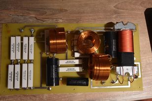

I'm having a issue with my crossovers. Lows and highs outputs are playing, but nothing at all from mid. Midhorn makes sound if I Connect to low/high output. None of the drivers makes any sound at all if I Connect them to mid output.
Strangely enough it's the same with both crossovers.
What am I doing wrong? Can you guide me through finding the flaw? Shipping Price is insane so I would like avoiding sending them to you.
I have this version xover
/forum/index.php?t=getfile&id=2991&private=0
Re: 8 years later [message #95129 is a reply to message #95128] Wed, 26 January 2022 16:54 Go to previous messageGo to next message
Messages: 19081
It's definitely odd that both act the same way.
But regardless, let's just step through the troubleshooting procedure. Using an ohmmeter, measure across the following terminals and report back what you see:
1. Measure from IN- to 2- and find zero ohms.
2. Measure from IN+ to 2+ and find 4.5 ohms.
3. Measure from 2+ to 2- and find 8 ohms.

My measured ohm are
-in to -2 0.6ohm
In+ +2 8.9 ohm
+2 -2 8.8ohm
Those numbers are consistent on both boards.
Whats next?
Re: 8 years later [message #95134 is a reply to message #95132] Thu, 27 January 2022 09:22 Go to previous messageGo to next message
Messages: 19081
I hate to say it, but I may need to see those boards to troubleshoot them.

Re: 8 years later [message #95136 is a reply to message #95135] Thu, 27 January 2022 10:11 Go to previous messageGo to next message
Messages: 19081
I'll be honest, I expected to see IN+ to 2+ as open if there's no sound. The fact that it shows continuity makes me think you should hear the midhorn. But another thing that could kill output would be a short across C4. You might measure across that component and report back.
Re: 8 years later [message #95140 is a reply to message #95135] Thu, 27 January 2022 17:45 Go to previous messageGo to previous message
Messages: 20
Registered: June 2017
Hey Ben,
Dumb question, but have you tried simply checking the wiring to the midhorns?
My 'go-to' is a regular 1.5V battery. Pull the midhorn leads from the crossover
and stick the wires on each end of a battery. It should make noise as you
connect/disconnect. You can also check polarity my touching the cone.
The crossover electronics aren't all that complicated, so I expect you can resolve
this without shipping. It will just take some back and forth and maybe
schematic reading verses physical layout training.
Chris
