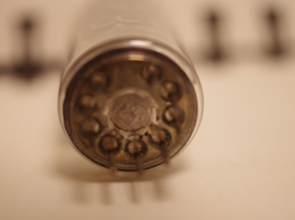

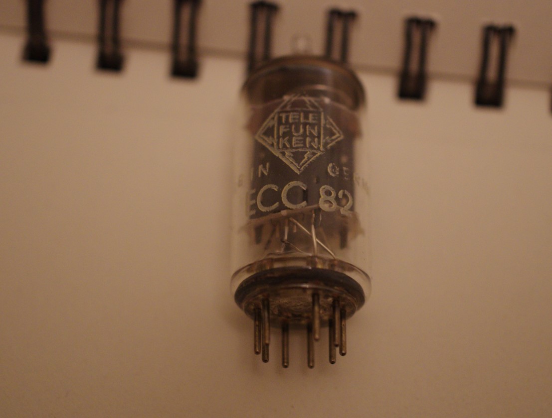

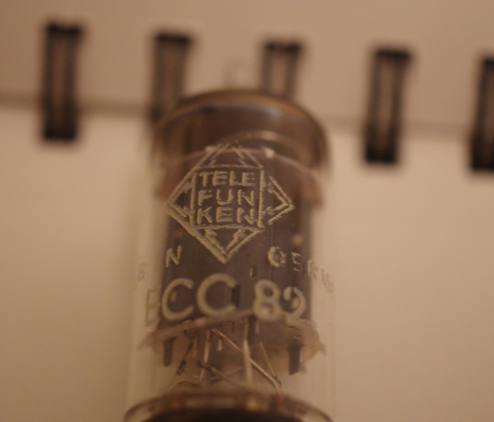

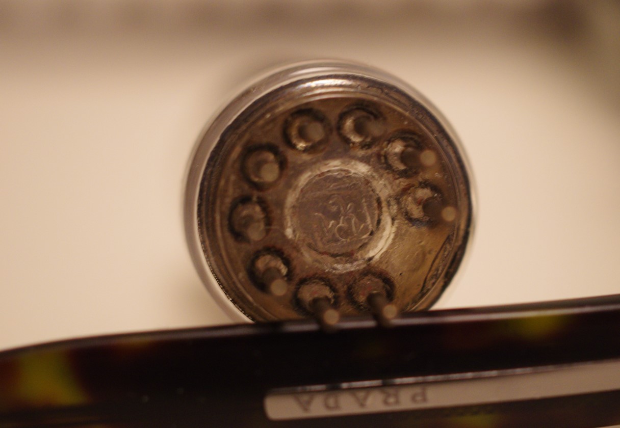

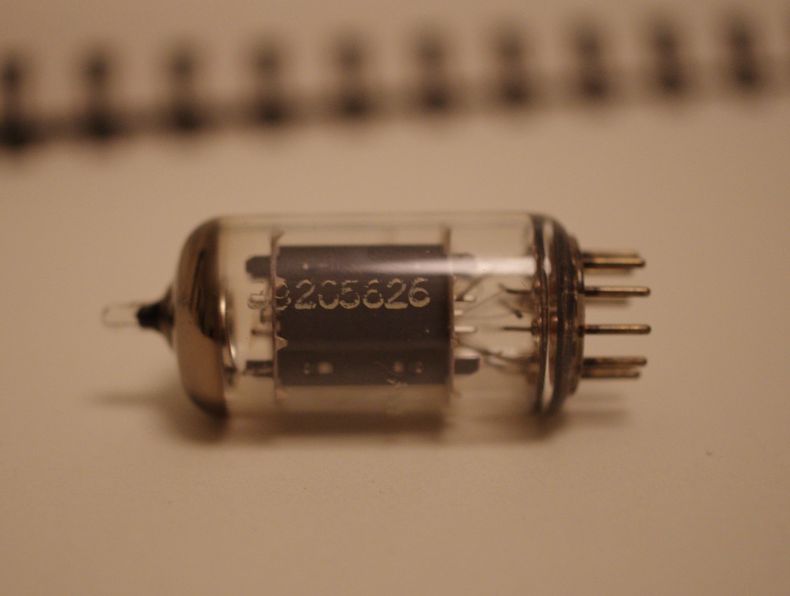

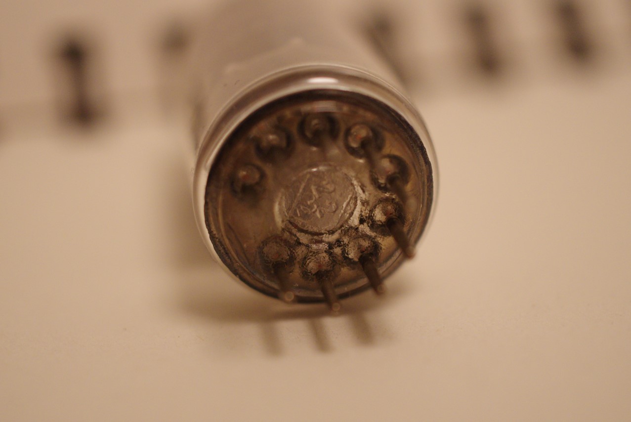

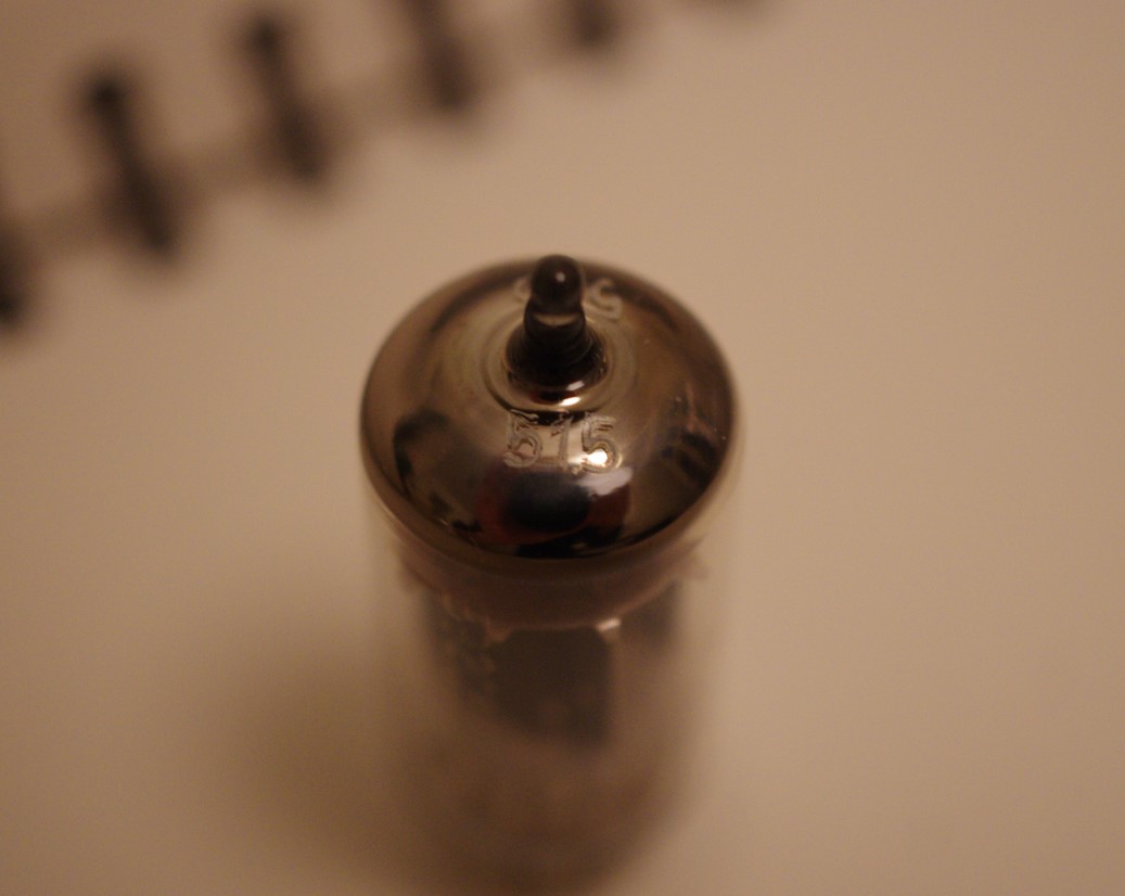

Re: ECC 82 recommendation | Telefunken vs Mazda Belvu [message #94950 is a reply to message #94856] Sat, 18 December 2021 11:08 Go to previous message
kasperbergholt is currently offline  kasperbergholt
Messages: 47
Registered: August 2021
Location: Copenhagen, Denmark
Did some photos of the Telefunken ECC82, my favourite so far in terms of tonality, clarity and precise bass.
I don't know its production year, perhaps somebody can tell from the serial number on the sides- or on the top (151)?
I've tried adding artificial contrast to one of the photos of the bottom where it says 2-2-2 in a triangle.
