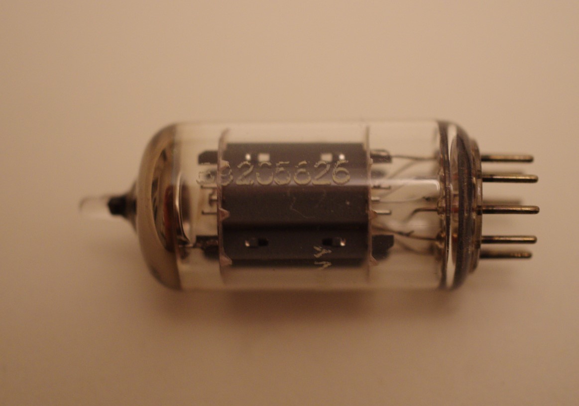

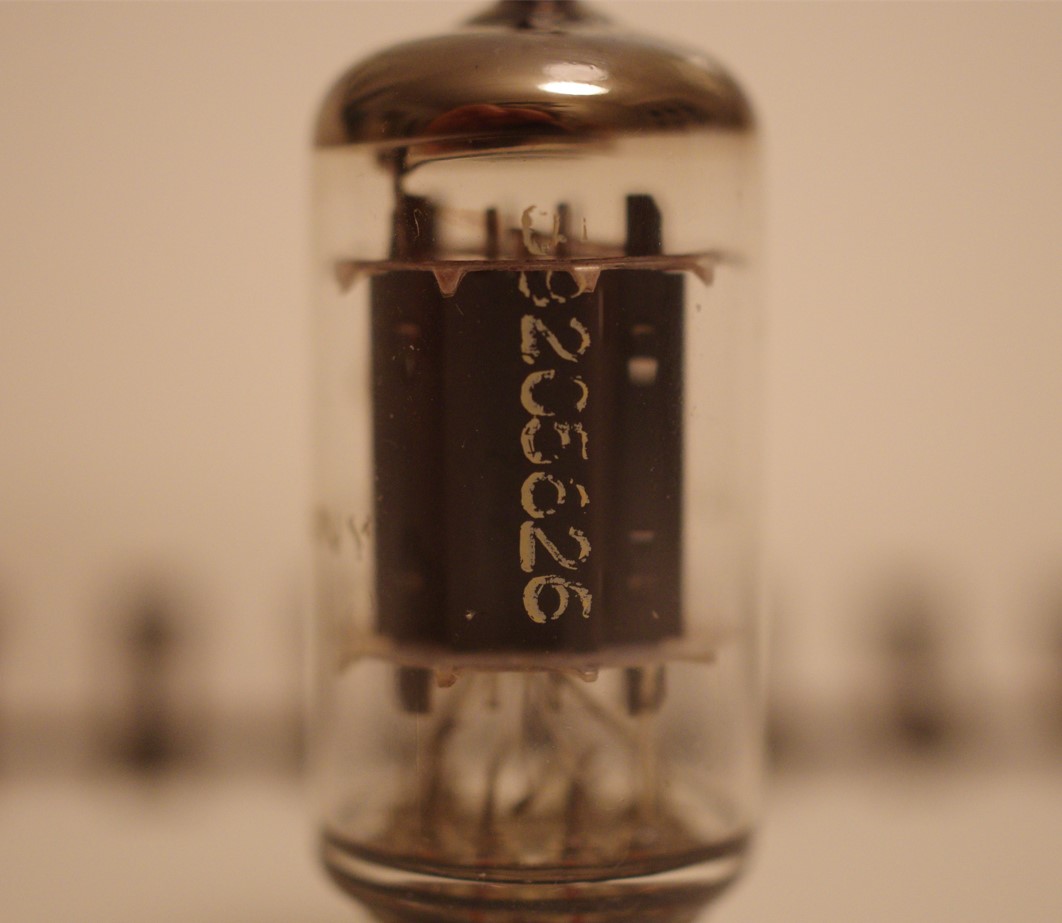

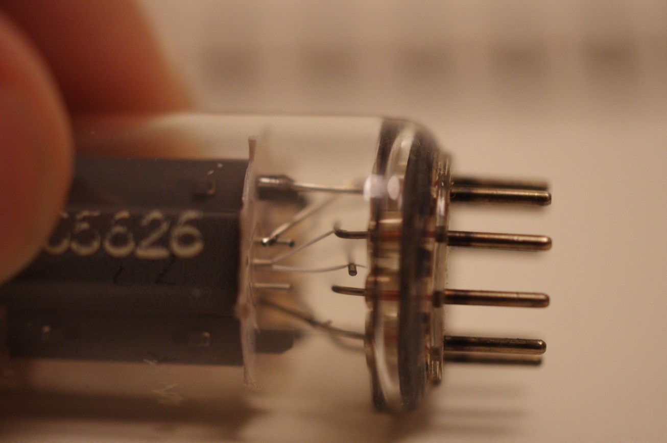

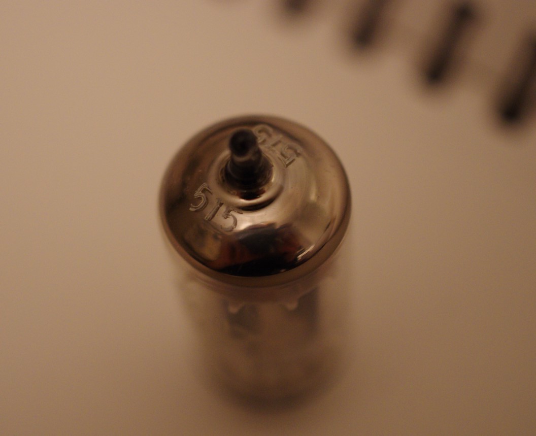

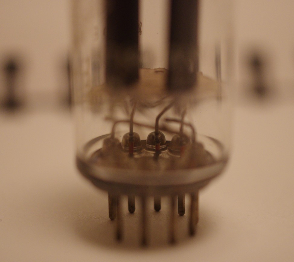

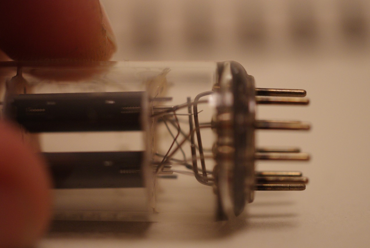

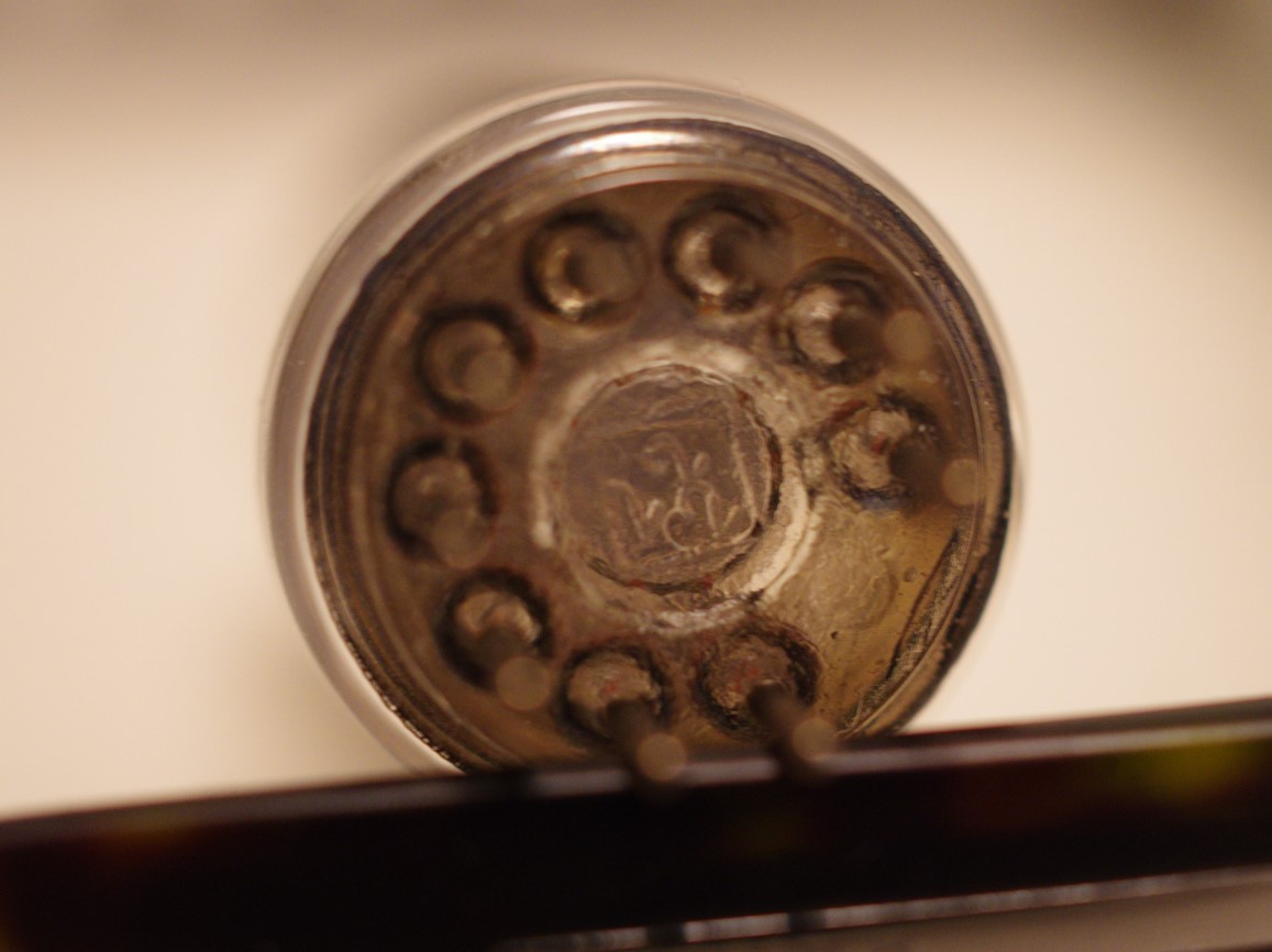

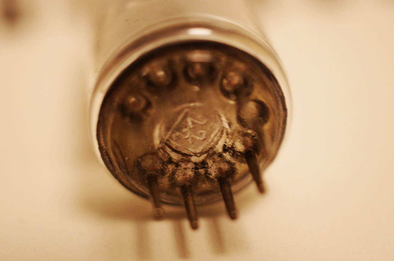

Did some photos of the Telefunken ECC82, my favourite so far in terms of tonality, clarity and precise bass.
I don't know its production year, perhaps somebody can tell from the serial number on the sides- or on the top (151)?
I've tried adding artificial contrast to one of the photos of the bottom where it says 2-2-2 in a triangle.
