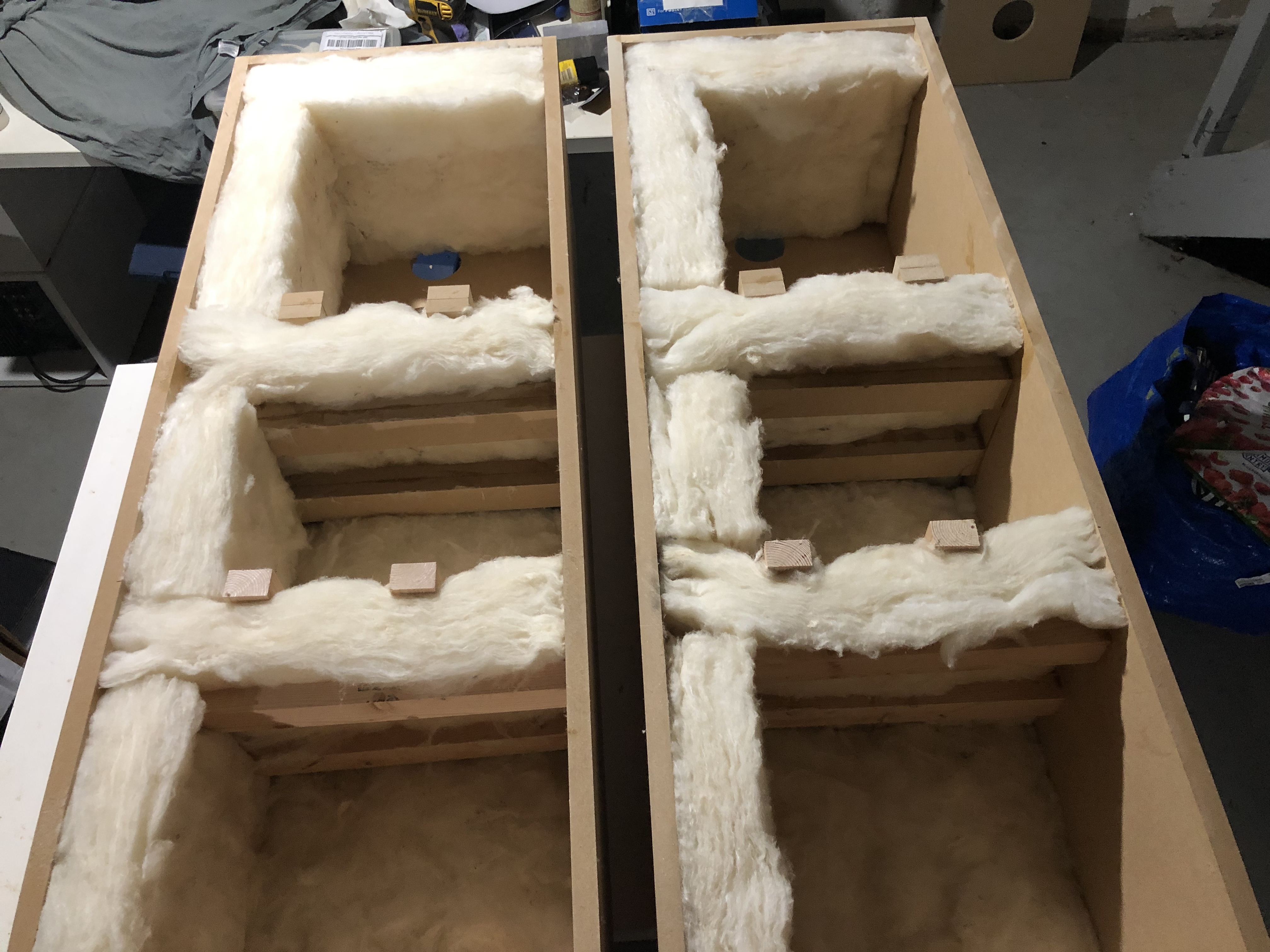

Before I put the backs on, how does this insulation look? I did top, one side, front wall up to the 2nd brace, and spanning the braces. Nothing goes on the bottom right?
/forum/index.php?t=getfile&id=2904&private=0
Re: 2Pi Tower Build [message #94728 is a reply to message #94720] Sun, 31 October 2021 08:58 Go to previous messageGo to next message
That's perfect.
