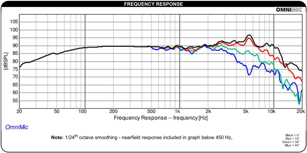

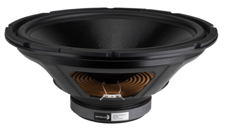

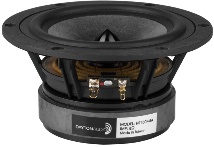

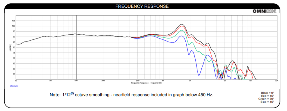

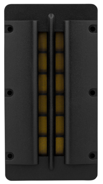

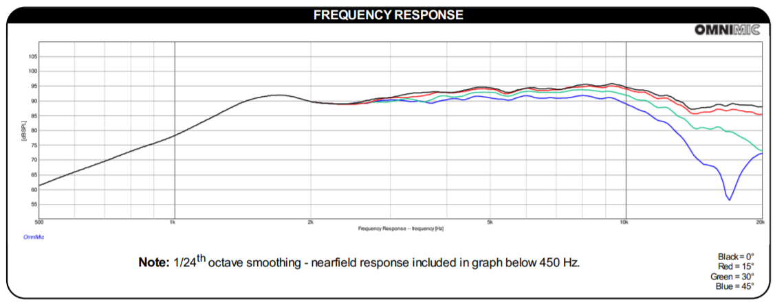

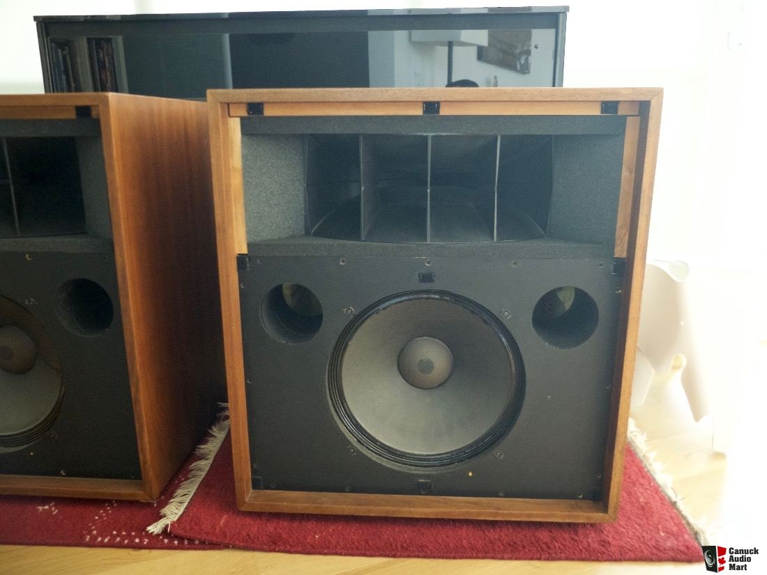

Wayne, you're making me feel like a murderer! I also enjoy original audio pieces, but these are hacked and incomplete. Compare mine vs the pic I posted of how they came from the factory. Looks like someone might have tried a horn where two of the tweeters used to live, so the baffle is already cut up. My mod plan would be to cut out the baffle, leaving about an inch. I'd make the new baffle to fit inside where I cut out the old. Then I could cut 2" strips of ply and fit them inside to glue the lip to the new baffle. Should be strong like bull. I'd fill the seam and paint the baffle brown like my econowaves. That's a good vintage look IMO.
I don't have measurement software, but have considered the Dayton DATS system. Looks like there is also freeware out there but I haven't researched it. I installed VituixCAD and I'm reeling from the learning curve. Dayton speakers have SPL and impedance files that are easily imported so I was playing around with some of those.
I figured a 15" woofer DC380 would stay with the original theme. For mids, the 8" size of the Aztec seems too large - all the SPL graphs seem to start breaking up at mid freqs. The 6" RS150P is a full range design with a whizzer cone that looks smoother at mid freqs. Maybe even two of those. Then I was looking at planar tweeters, so maybe the PT2C. Maybe even two of those, as well.

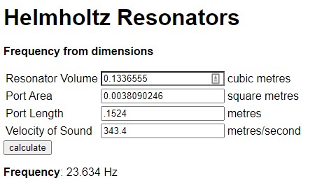

My Monet cabinets are still in my bedroom staring at me. I've done some studying but don't think I'll turn into a speaker designer overnight. Did some web searching to look at other large speakers from back in the day. Aztec Valencia caught my eye. But waveguide tech is better now and that brings me back to Pi. Maybe I'm at the point where perspiration is better than inspiration.
Wayne, the Helmholtz freq of the Monet cabs is 23.6.
Maybe I should make a cheap front baffle out of OSB and just clamp it to the front, using a gasket to seal it. Then I could check for standing waves, and experiment with damping material. I could change the internal dimension with closed cell foam or perhaps make a plywood internal divider. If I needed to change the position of drivers, I'd just have to cut a new test baffle.
